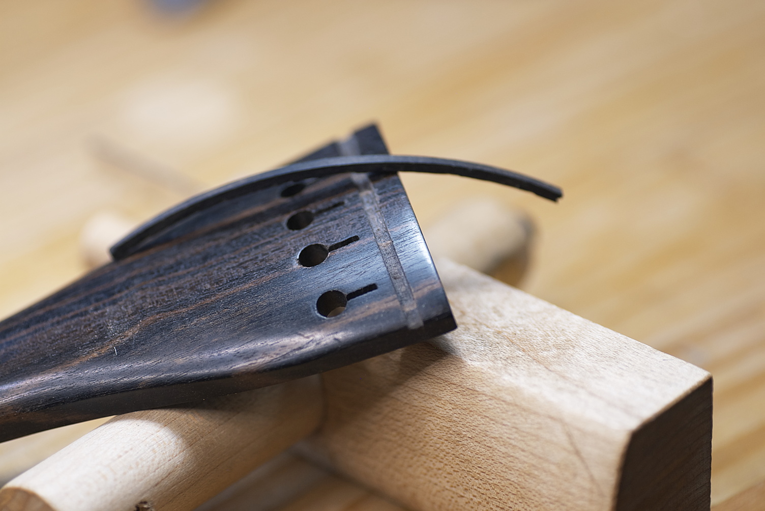

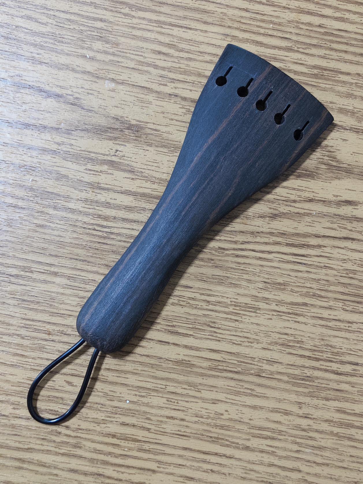

With my daughter home from college we have been slowly working on the 5-string electric viola for her. She is a music major and plays viola in the orchestra. I have no idea what I'm doing and it's a great learning project. Here's the tailpiece I made based on measuring her's and some online photos. The shaping is done but not the sanding.
The wood is some sort of ebony I got a long time ago. I have the fingerboard made too but no photos yet. I have a piezo pickup designed to go under an acoustic guitar's saddle I'm going to attempt to adapt to this.

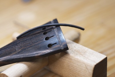

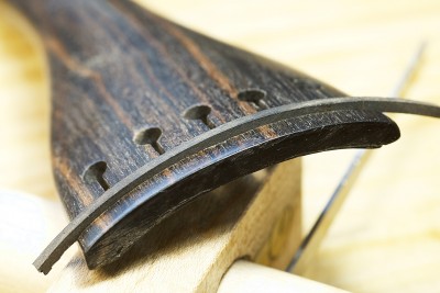

Thank you, Barry. Here's the latest on that tailpiece. It is polished up a bit and the grain is fabulous.
I have done string inlay in my general woodworking and was able to use the same homemade tools for this. That piece of curved ebony was already the exact correct radius. It was left over from when I was making my first rosette. I love it when things like that happen.
The only difference between this and string inlay is this won’t be flush. After it’s glued it will be trimmed and shaped with a rounded top.

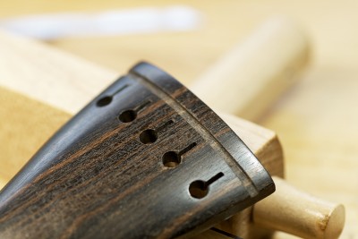

I was sitting here looking at the tailpiece again. And I had a thought; from a geometric standpoint, shouldn't the holes on the outside edges be spaced a little farther apart in order to keep equidistant string spacing.
Eric Knapp
Posts: 651
Location: Wisconsin, USA
Re: Electric Viola Build - Tailpiece
Post by Eric Knapp »
Barry Daniels wrote: Sat Jul 18, 2020 12:24 pm I was sitting here looking at the tailpiece again. And I had a thought; from a geometric standpoint, shouldn't the holes on the outside edges be spaced a little farther apart in order to keep equidistant string spacing.
Good observation. They are a little farther apart but I’m not sure of the exact needed spacing. Fortunately, the actual string spacing is determined by the bridge, not the tailpiece. This is a learning project and I’m learning a ton. This is a solid-body electric viola so I have more leeway in the design. I have to satisfy a classical acoustic viola player with the feel. I just hope it makes some sound, too.
