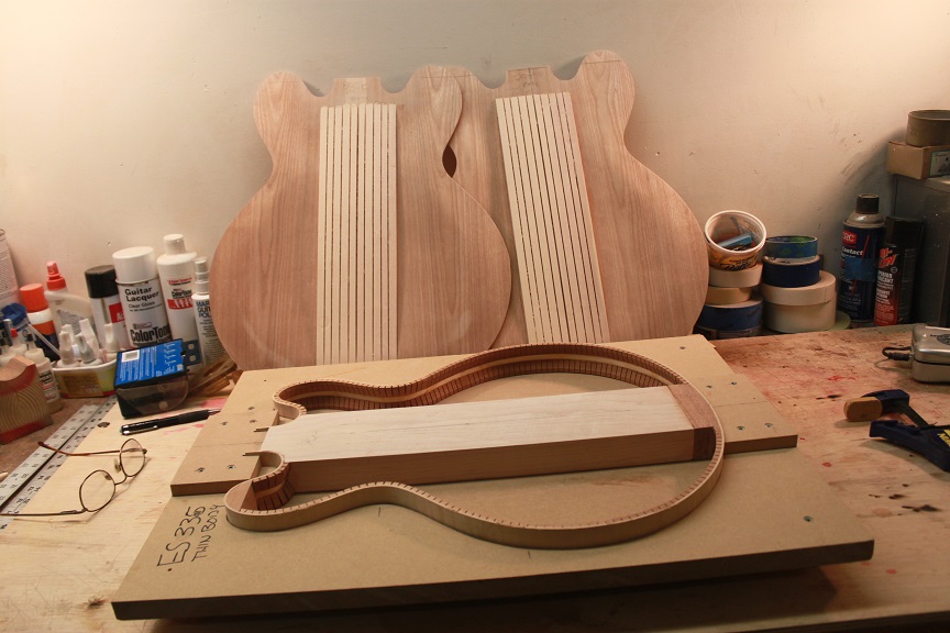

Having built a couple of semi hollow electric guitars I think taking the back off would be a nightmare. The center block has a huge gluing foot print and I don't see any way to get either steam or heat into the joint. You would want to remove the neck first which is a daunting task in itself, the steam the rim, finally the center block.
In my humble opinion if you have ideas for the center block build one from scratch incorporating your ideas (and post here) and attach the back with tiny screws to the rim and center block, and a screw on neck so you can take it apart to try your ideas. Here is one style of center block used on many 335's the block itself may be spruce, mahogany or other woods, you can see the kerfed filler pieces that are arched to fit the curvature of the top.
Different models of semi hollows have used different blocks and bracing, here is a "short block"
And here is a hollow body with just two beams supporting the bridge and pickups. This guitar uses a floating bridge and trapeze tailpiece instead of stop bar.
If you do build something and glue it together I would suggest hide glue to make it easier to get it apart. I have seen a mandolin builder who screwed the back on his mando so he could take it apart during the voicing process, you might want to consider that.

FWiW, I do have a build thread for the first guitar (the one with the kerfed block) at another forum. If you are interested I could send you a link.

Those guitars are really quite different. The one with the big block and the hollow body have SD jazz pickups, the small block has StewMac PAf copies, Both 335 style have gone to other owners, the hollow body is my personal jazz style guitar. Each is inspired by different Gibson guitars but none is a direct clone.
I do know that over the years Gibson has used a variety of different construction methods, woods and pickups in semi hollow guitars, but I am not enough of a gibson historian to know what is what. I think the idea of making a test mule is interesting - can you hold everything else completely constant while you change just this one variable?
But as a builder/repair person I will add that removing the back just seems like a monster of a project. I've taken fretboards off by heating the neck with my silicon heat blanket that I use to bend sides, you could lay that on the back and work pallet knives in from the tail block end. You would still have to deal with binding and the seam at the rim. If you decide to do it be sure to post some pictures here as well as the results

Bob, these were built some period of time apart so its a little difficult to compare The 335 with the small block was built for a left handed player so I really couldn't play it before shipping it off to him (I did have a local lefty play it for me first). He wanted traditional vintage sound and we agreed on the StewMac golden era PAF clones, I have the in my les paul clone and I think they gave it that 60's rock sound that he wanted
The one with the big block was built for a local jazz player. He spec'd the SD Benedetto pickups and a Bigsby tremolo. I think the guitar has a warm almost lush sound
