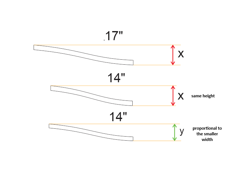

2) L30 archtop size: the height of the archtop center compared to the edge has the same size as a full archtop or is it proportionally smaller? (I've attached a image explaining the doubt)

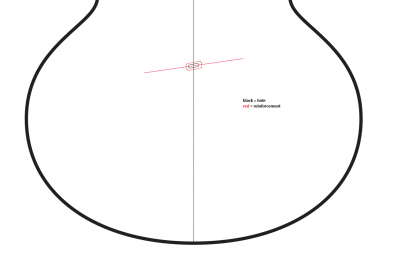

4) I'm planning to do a small hole beneath where the bridge will be located, with a reinforcement on the bottom of the top, to pass the cord of the piezo pickup on LR Baggs Anthem pickup, do you think it would be a problem, even I doing the reinforcement? (I really think the archtop pickups with the cord over the top to be ugly as hell).

2) The height of the arch should scale to the thickness of the top, not the height of the arch. A smaller span be be a little thinner and retain the needed stiffness for a given Young's modulus along the grain (E-long), but if you go with a 'standard' thickness the arch height should be the same. Cross grain stiffness doesn't seem to matter as much in the long term, as cold creep reduces it's contribution, at least in flat tops. On archtops you have to pay a lot of attention to thew arch contours, particularly in the recurve, to keep from developing long term sinking.

4) A properly reinforced hole should be OK.
