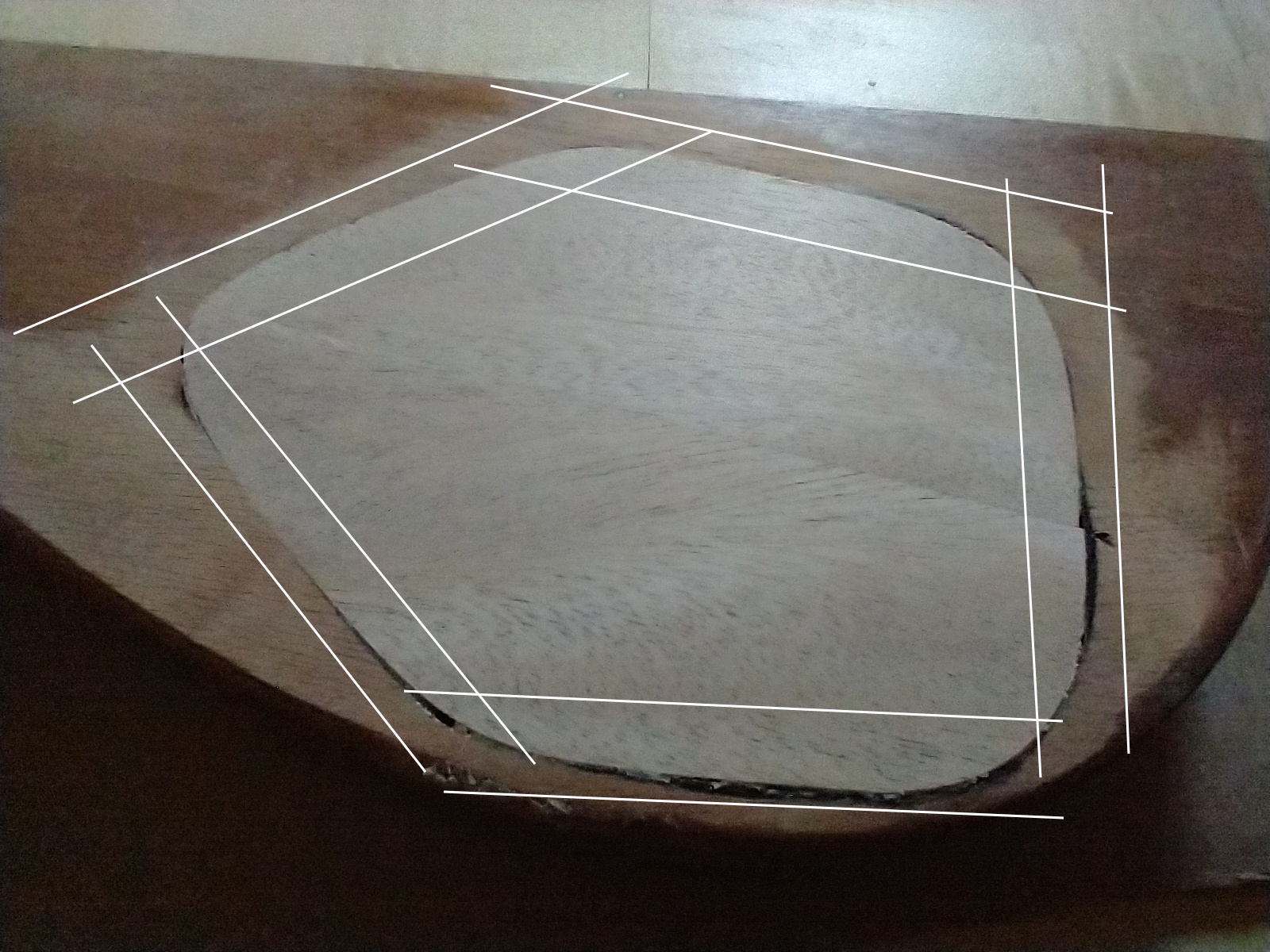

I just plugged the rear pickup cavity to an old solid body electric guitar.
I used poplar and made it just shy of the back surface so I could inlay some thin mahogany for a flush surface.
The mahogany came out okay. I had some gaps between the cavity and the thin mahogany piece.
The cap was crisp but the old recess was hand routed and as you can see, a bit crooked.
Because the old finish was black, you can see black in the gaps.
I plan in cutting away some of the black material and filling it in with mahogany dust and glue, but the Titebond will not allow any stain.
Would a different glue work better?
I plan on staining it and clear coating it.
At this point mahogany dust with yellow tinted glue is better than black streaks.
Any suggestions would be apprenticed.

Why not rout a little shelf around the opening and make the mahogany filler fit that rabbet? Any gaps would be the same color and wouldn’t require filler to look professional. Timbermate will look like you pushed putty in the gaps and will shrink later and leave depressions.

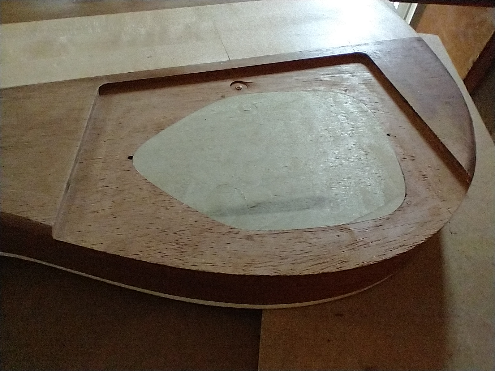

Bob,
Do you mean something like this, where I can inlay some strips of mahogany into the route channel?
- Posts: 1106
Re: Filling in mahogany gap.
Yes, but much smaller and closer to the original outline so that you don’t go out to the edge. It will look better if you redo the mahogany patch as one piece rather than inlay strips. Making a template to guide the router will increase the odds of your success. You can make the template several times until you get the shape right before you route the guitar.

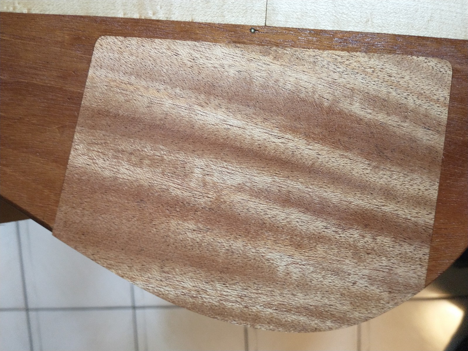

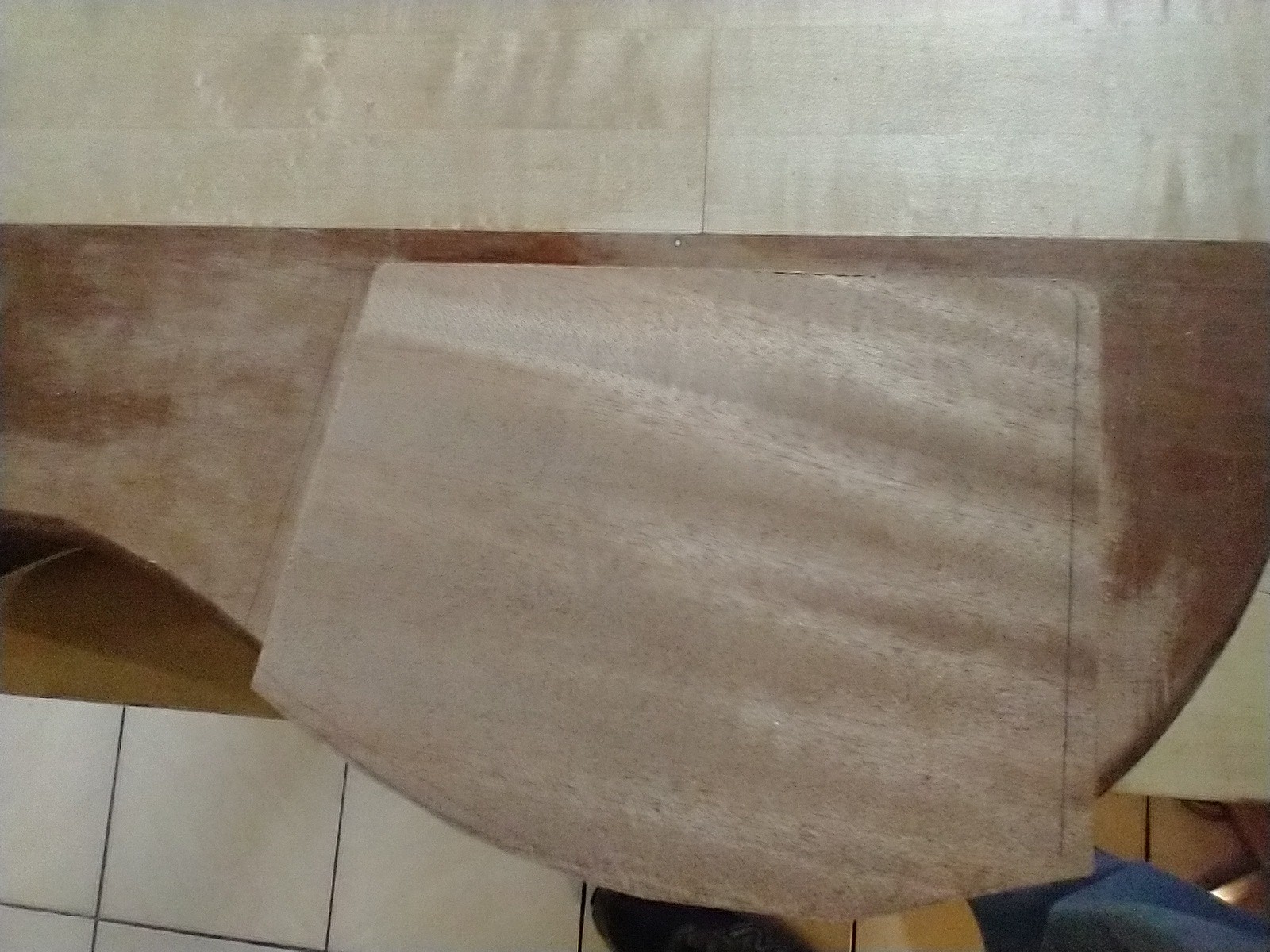

I decided to take the advice and simply made a new cap.
A simple template and some sanding gave me a near perfect fit.
The grain was close but not an issue.

Very different grain but the fit was spot on.
African (current) on top of Honduran (1982)
