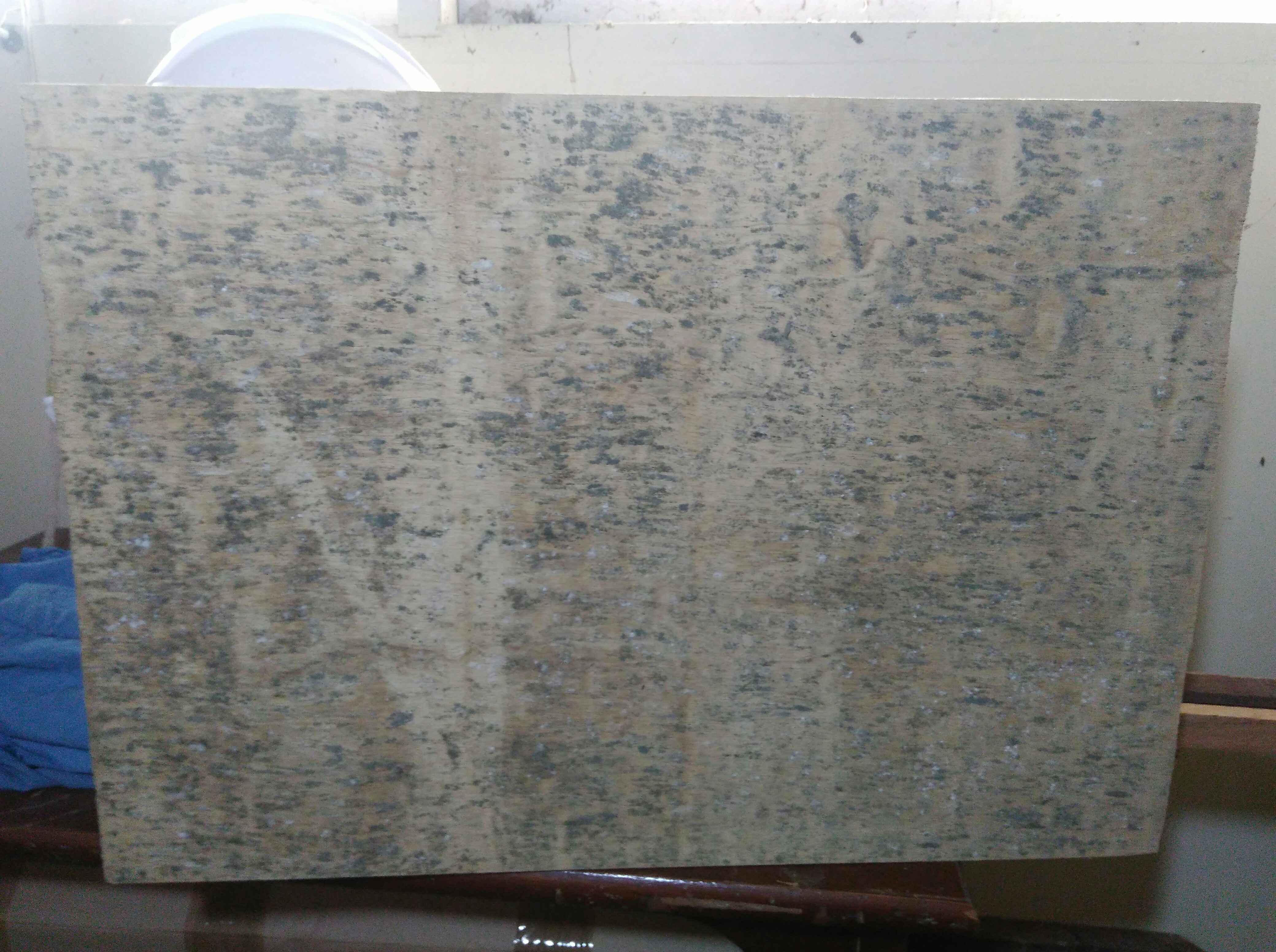

This body blank was stored on a humid room for a few days and got covered in grayish mold. Anyone got some advice on how to clean it? It's very light colored and I'm concerned about the mold staining the wood. TIA

Scrape it down till it looks clean. Use a respirator so you don't expose yourself. Then you might want to put it out in the sunshine for a few days.

Thanks Barry! I'm thinking of vacuum clean it, than scraping. Just trying to avoid staining the wood.

A vacuum won't be sufficient. Mold grows into the wood a bit. You need to remove the top layer of wood to get it all. Also, a vacuum's exhaust will blow mold spores all around the room. Not a good idea.

I have used vinegar to kill mold on wood. as long as you coat the entire surface, scrub and rinse it well, and allow it to dry evenly you should avoid "water" staining. If mold has penetrated the surface you may have to sand it after the vinegar treatment to remove discoloration from mold.

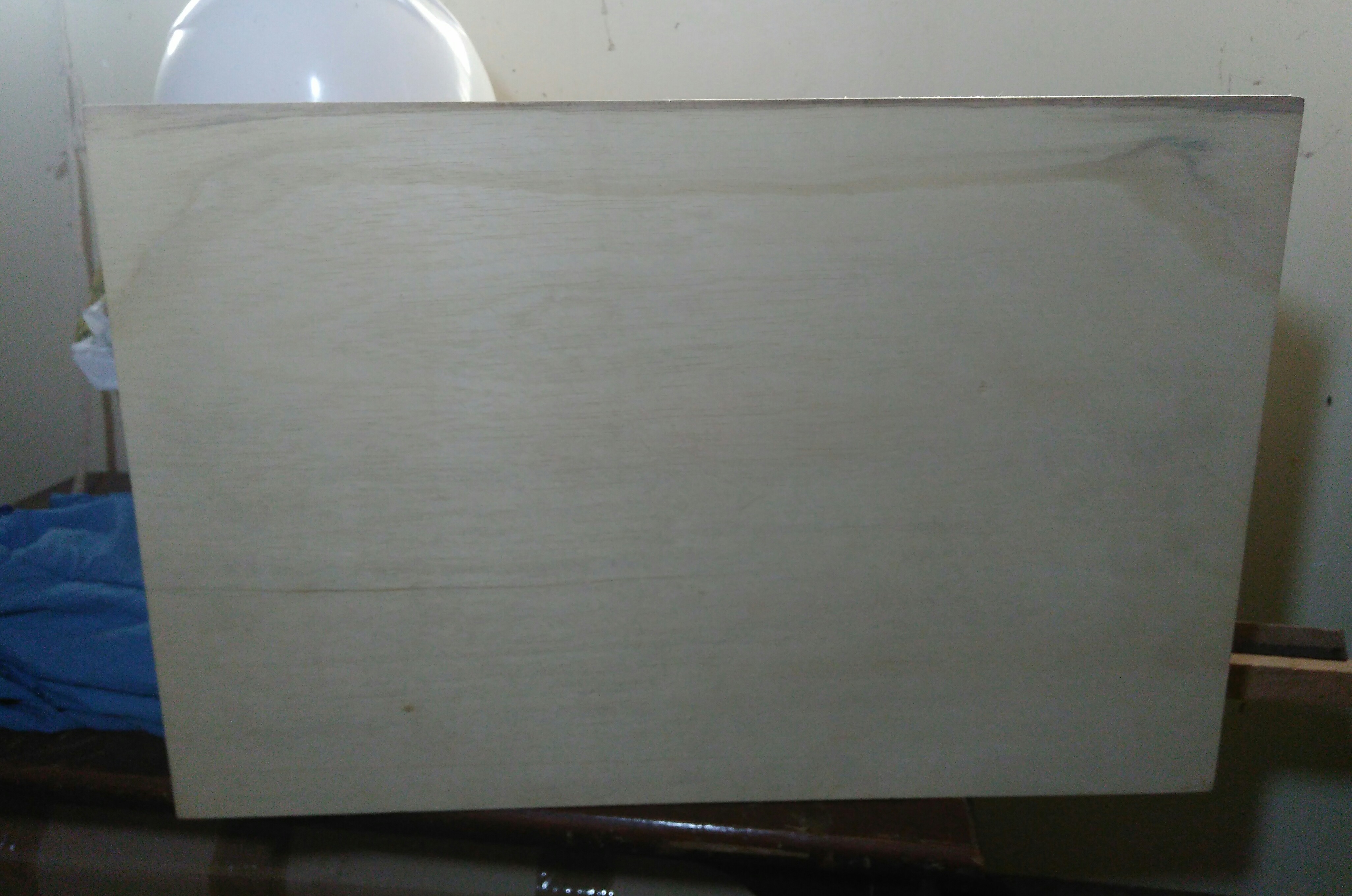

Hmm. No vacuum then. I'll try just scraping on one side (that will receive a top wood) to see how it goes. If it goes bad I'll try the vinegar on the other side. Thanks guys.
