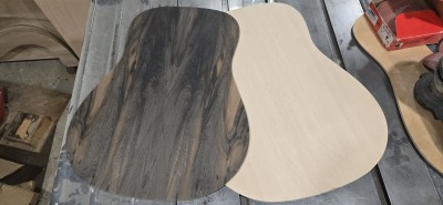

Well, it's been six years but I finally found the time to start this build. I got the top and bottom cut out and am busy building the mould. I plan to use a bending iron that I made for a cello that I built to bend the sides. This Brazillian hickory is a lot more dense than the maple sides on a cello, but the radii are much larger, so I don't anticipate any surprises.

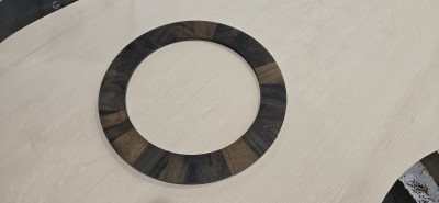

Thanks. I put a few hours in on it today and made the radial rosette out of left over wood from the back. It's held together now with CA glue, but will be glued into the soundboard with Titebond.

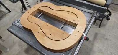

Today was mould day. I used three layers of 3/4" plywood with over center latches and dowel pins for alignment. Turnbuckles were used on the clamping blocks. Now it's time to break out the bending iron and bend up some sides.
