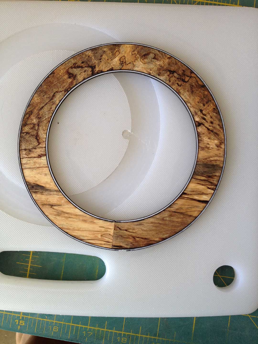

Thanks Randy - yes, I already have those links bookmarked. I'm assuming the cutting board idea was yours, and I was able to get an old slightly warped one from my wife, which was large enough to cut in half, and routed the rosette channel into. That's a great idea - I'm sure if I built a rosette into the top itself I would leave dings and scratches (they seem to appear out of nowhere in my builds). Here's a pic of the board and a very simple rosette.

Re: "Kelobre"?
Peter,
Really pretty rosette. If it's pithy, which a lot of spalted wood can be, you might want to "toughen" it up with thin CA before putting it into the top. Just use a small amount at a time so that the glue doesn't Chernobyl on you and turn white.
And don't forget to paint the trough in the top with shellac first if you glue the rosette in with CA.
I did come up with the idea on my own, but was not the first to do it by any stretch. I think I had to turn over the "slicker than snot on a doorknob" award to Tom Harper
