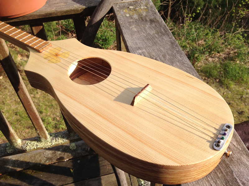

This process took over four years and after a year I felt a great need to complete an instrument quickly so over two weeks I made up designed and built a hybrid guitar/mandolin/dulcimer that I call a Dinalin. It has a push-down bridge and is tuned to an open D chord ( D A D F# ).
More about the Dinalin: https://learnmaketeachshare.org/instrum ... nalin.html
