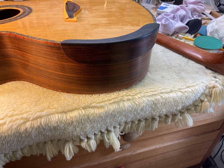

Posts: 3254
Re: Archtop with an arm bevel
You could add an external arm rest with the necessary angle. Here is one I did for a guy who's body chemistry affected the finish. The arm rest is held on with magnets so it can easily be removed anytime.

Barry Daniels wrote: Sun Mar 26, 2023 12:06 pm You could add an external arm rest with the necessary angle. Here is one I did for a guy who's body chemistry affected the finish. The arm rest is held on with magnets so it can easily be removed anytime.
As much as I thought "This might not be for me." I can admit to myself that is my bias talking. After spending a few years learning how to solve the problem with flattops just stick a piece of something off the but of the guitar? All right, let us see what I have in the shop that I could rig up. Found a cutoff from a mold for bending sides, a little filing (bearings went in my belt sander) and it fit well enough on a LP body. Darn hard to clamp in a vice, I managed though.
the concept works but with the movement of my arm while strumming it is not quite ideal. It would be better if the angle started two inches in from the edge of the body. If there was no recurve in this section and the arch continues into the arm rest it might work. OK, the wood is a little rough and unfinished but just mucking about with it has my arm starting to get sensitized where it touched. I would be doing just fine if I wanted to learn piano, sigh. Or learn to play without my arm touching the guitar? But it is an interesting solution, we will put it in the "maybe" column.
