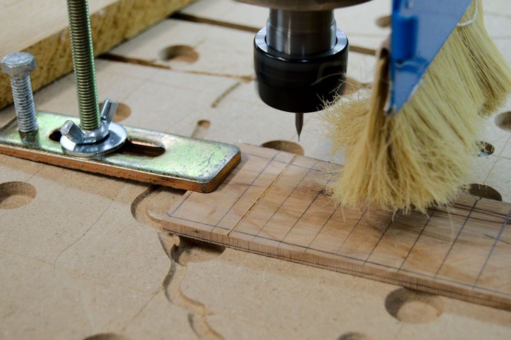

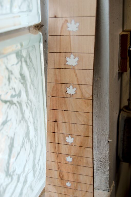

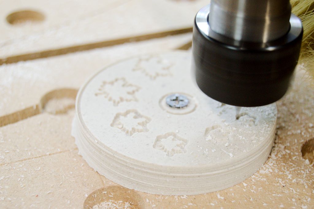

CNC's are perfect for inlay. I'm trying to use mine to do as much as possible as I struggle to learn Fusion 360, but inlay can be accomplished with Vcarve, a much simpler program. I did some corian inlays of sycamore leaves on a uke fretboard that turned out pretty well. I'll try to find some photos. There is a method of inlay called "vcarve inlay" where the male and female parts are cut with a v-bit rather than a straight bit. This has the advantage of better fit - especially when it comes to fine details. Search youtube for "vcarve inlay technique".

On the attached photos, the fretboard is bartlet pear. I originally tried making the male inlay pieces from padauk but found it too chippy to hold detail so I grabbed a piece of scrap corian from an install job I did. It was the piece left from a hole saw. Corian is hard to come by here so I take what I can get.
[/img] This was my first attempt at inlay with the CNC. It's not perfect but a hell of a lot better than I could ever do by hand!

Those fret icons look nice and intricate.
