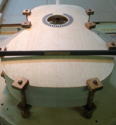

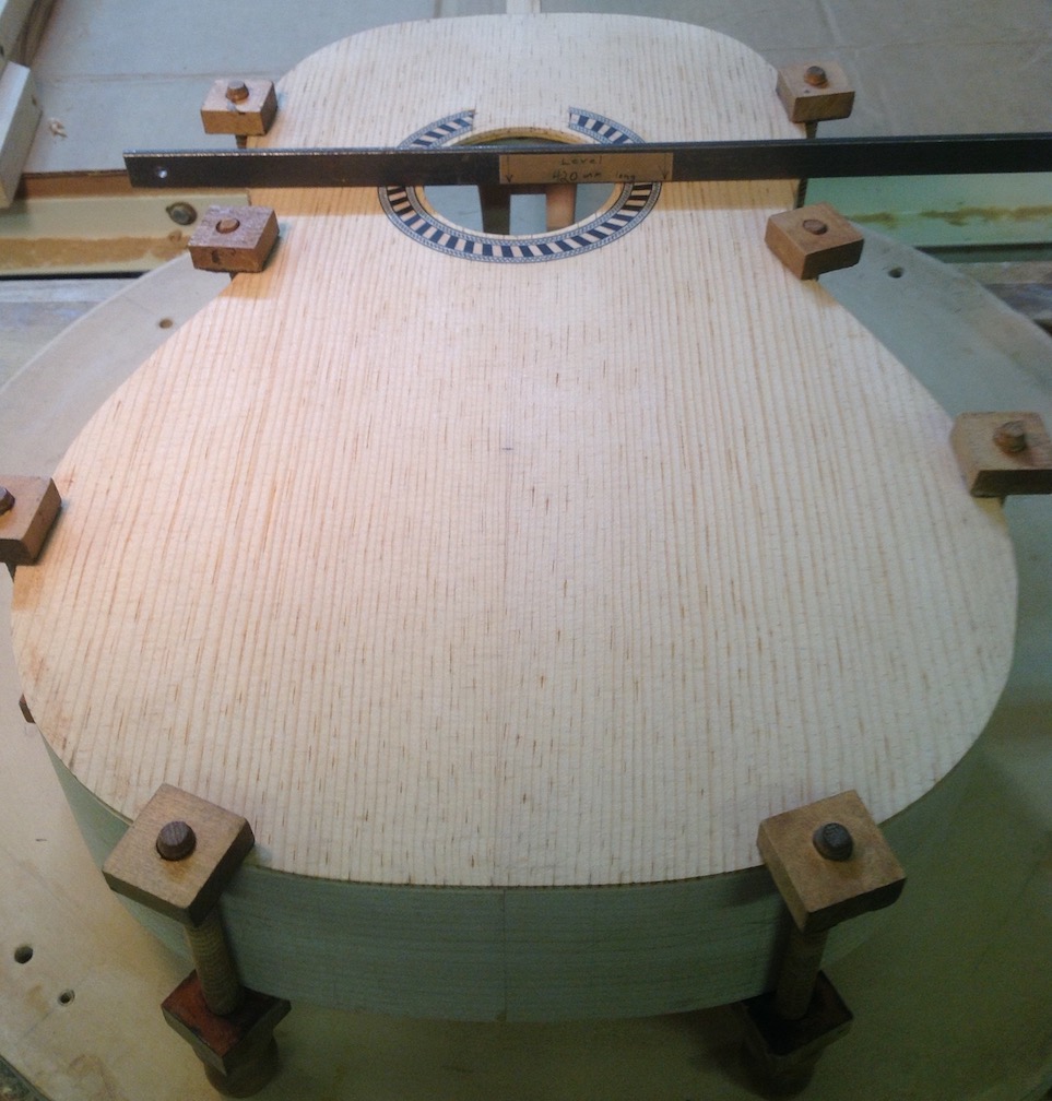

Several things to consider when putting a dome or contour into the sides with a hand plane:
The waiste will be the high point. Exact numbers regarding the arch aren't as important as a good fit.
The inings will be angled down and outward to accommodate the plates. Remember the bottom of the heel block also.
I use a dished sanding plate for the backs which usually works for a good fit. But I dome the tops of my guitars in an irregular manner.
The 3 essential considerations for the top are the height of the saddle in relation to the nut and the resulting action height at the 12th fret.
In that relationship is the angle (backward or forward) of the neck (nut) in relation to saddle height. For a scale of 650 mm being off 1/2 of a degree will alter the saddle height by 3mm. I shoot for 1/4 degree accuracy with a target saddle height of 12.5 mm. That is a tough goal and more than once have had to make another neck to acheive it.
For that reason too I never install the truss rod until after the neck angle is right where I want it. It gets in the way. The other reason being that I use the truss rod channel for a guide in aligning the neck to body center line.
I like to put a slight back angle in the neck and start with a 90 degree neck to top body joint. The doming of the top begins about the midle of the soundhole and is concentrated in an area encompassing that point to the back side of the bridge. I start with oversize sides and plane the contour into the sides using guide marks to keep track of my progress.
And no, Cumpiano and Natelson don't cover this well. At least in the 20 + year old edition I have.
