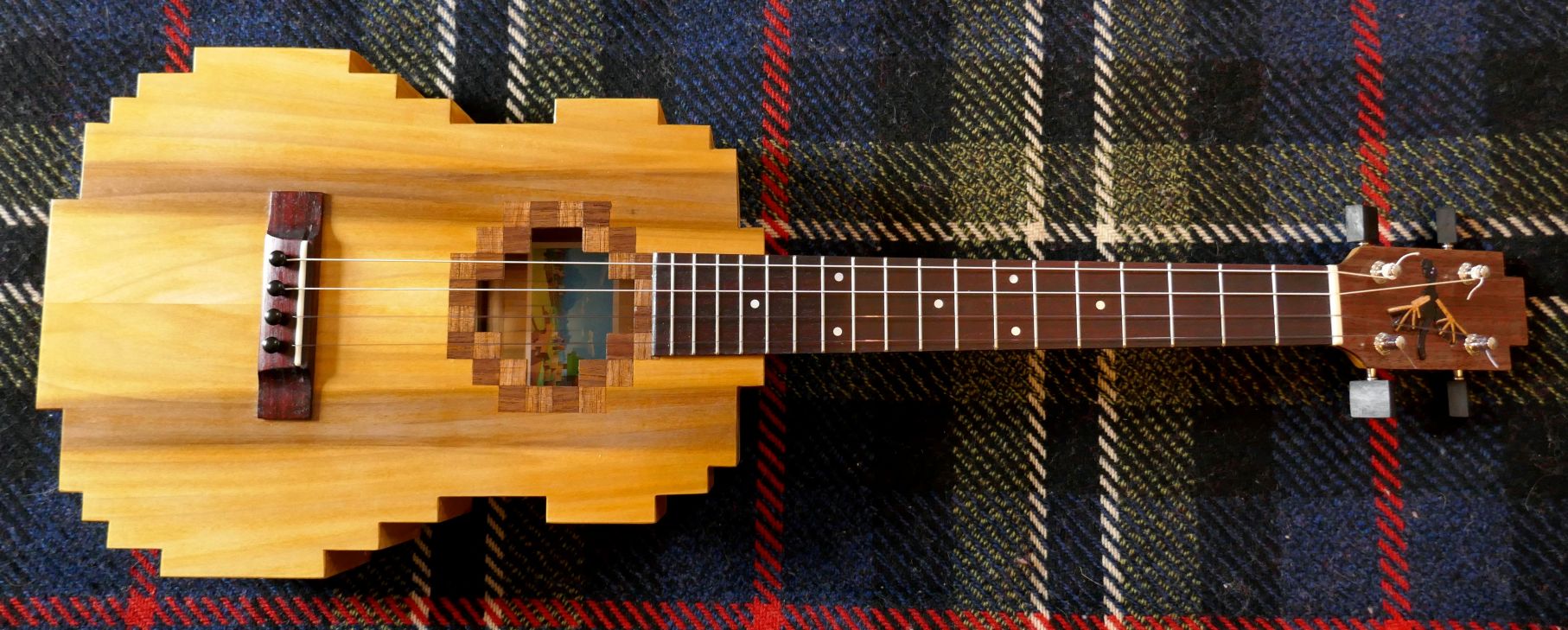

It is a baritone scale ukulele.
The body is mostly poplar. The brown streaks became a lot darker under finish than I expected.
The dragon on the headstock is all wood and is proud of the surface (it's not an inlay).

It is acoustic. It's is going to a house with very "active" 4 and 6 year old boys, so it's built rugged. It is set up and intonated well, so it plays fine, but it's not loud. I did consider that I could add a pickup to it at some point if someone wanted to use it that way.
The jagged edge shape isn't the most comfortable either.

It's all hollow, but the sides are pretty thick; nominally 1/4", and sawn from glued up pieces.

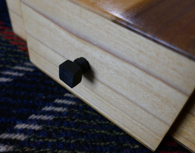

I'm kicking myself for putting round dots in the fingerboard. Especially because I put square markers (turned 45 degrees) in the next uke I made. I thought about making custom pins with square heads, but I had to finish this thing sometime! I did make an ebony end pin with a square head though.

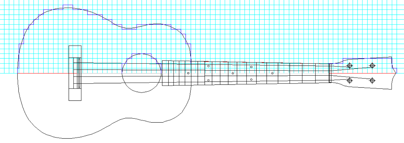

To make the outline, I took my normal baritone pattern and laid different size square grids over it. I settled on 1/2" squares, and then traced out the pattern that looked best to me.

The pixels were around the sound hole are really effective. The grain makes them look just a little out of focus and zoomed in too far.
