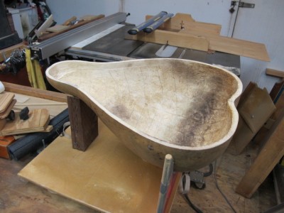

I'm trying my hand at a Gourd Guitar & can't find much Info on bracing. The plan is to build a steel string with attached bridge & a 24.9" Scale. I have an X brace laid out where I suppose it should go, but I really don't understand how bracing works other than it's structural applications. The top dimensions are 12.75" X 18.5". I want to have fun with this & not Over think it, but still come up with something playable. Does anyone have any suggestions.

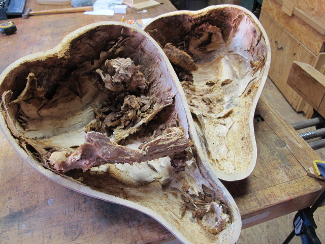

Can you show us the intended gourd? I bought a large (~14" long x 9" wide), fairly uniformly-shaped gourd at a harvest fair many years ago, and sawed it in half with intentions to build a uke-lute-ish sort of instrument. While the outside of the dried gourd can be fairly hard, the inside is pretty punky/foamy. I had considered issues with tension, as Mark describes, and thought of maybe using some of that penetrating epoxy to harden-up the inside. I was definitely going to use a solid, bent liner for attaching the top. For the outside, I was going to use some leather dye and finish with shellac and tung oil.

Mark, You've pretty much articulated the concerns I had before starting. It looks like most builders have solved the problem by using a 'through neck' idea. as Jason said the inner surface of gourds are not ideal for gluing, so I think the way to go is to hang the Gourd off of the neck. I thank you for the numbers, that help me a lot. Below are some links to some examples.
