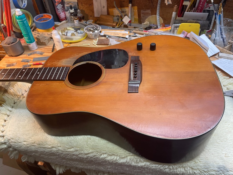

Up next on my bench is a '73 Martin D-18 that has been poorly modified. Besides a poor refinish, a set of pots was added for a saddle transducer. Originally, I thought it would be no big deal to pull the pots and plug the holes in the top with some matching spruce and a little touchup. I also knew that a refret and neck reset will be necessary. But then I looked inside and much to my horror, I found that installation of the pots created a lot of brace damage. One of the pot holes was directly on top of a finger brace which got knocked off and relocated to a new location. But the real issue is the X-brace, which falls between the two pots, was completely notched out down to the soundboard. The installer put in a sister brace next to the X-brace in an attempt to re-strengthen the area.
I could not get a very good photo with my phone of the notched X-brace but when I get my new boroscope tomorrow I will rectify that. But I an unsure of how to fix the damage. I will certainly remove the sister brace. But I can't REPLACE the X-brace. And splicing in a new section would be problematic. I am definitely open for suggestions on this one, but let's wait for better photos so you can better see what's going on.

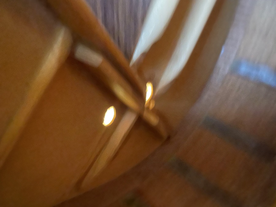

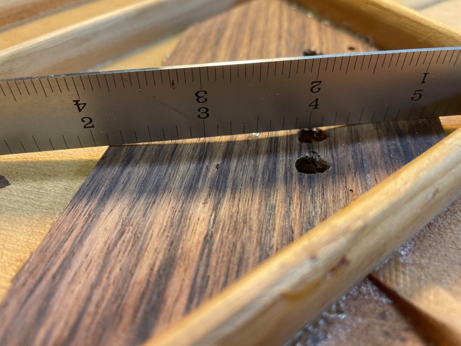

The top has a number of serious issues. Here are better shots of the braces. Both of the pots fell directly on top of a brace; one being the lower leg of the X-brace.

Tom, that is an approach worth consideration. The top could be saved, but it sure is ugly.

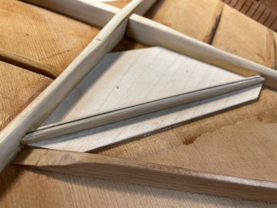

Here is a better view of the scene of the crime.
I think I will need to pull and replace the bridge plate because it is severely warped.
I am a bit unsure about how to fix the x-brace. Either a graft or complete replacement are the options.

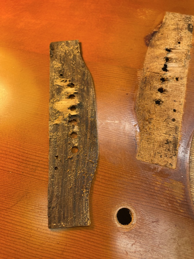

My client wanted to keep it as original as possible, scars and all. Here is a shot showing the warpage in the bridge plate. So an hour with a chisel, scraper to remove the sister brace, and a half hour with my bridge plate removal tools got me this. It is SO much easier to remove a bridge plate when you can see what you are doing.

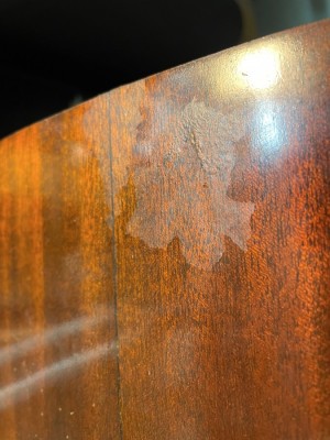

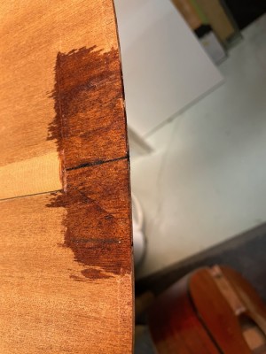

I like to try new techniques from time to time and here is a new one for me that worked well. The quarter size chip of the back that stuck to the headblock needed to be leveled and reattached. The chip was still partially attached and I didn't want to break it free. There were some splinters that were hindering the chip from being reinserted into position. I tried to remove them but was somewhat unsuccessful at that. I have used CA in the past to reattach chips like this because it does two things: secure the piece as well as provide a finish repair. The CA I have used in the past, however, had the problem of bleeding through wax paper and getting stuck to the clamping caul. So I tried GluBoost thin and it behaved well with the wax paper. I placed the back into a 15' radius dish, saturated the area with CA (including a couple of nearby small cracks) and clamped the heck out of it. I am very happy with the results. The chip is very level with the rest of the back and the finish cracks are well hid. Just need to scrape and sand a bit and it should be nearly invisible except for one small spot that will need a bit of stain.

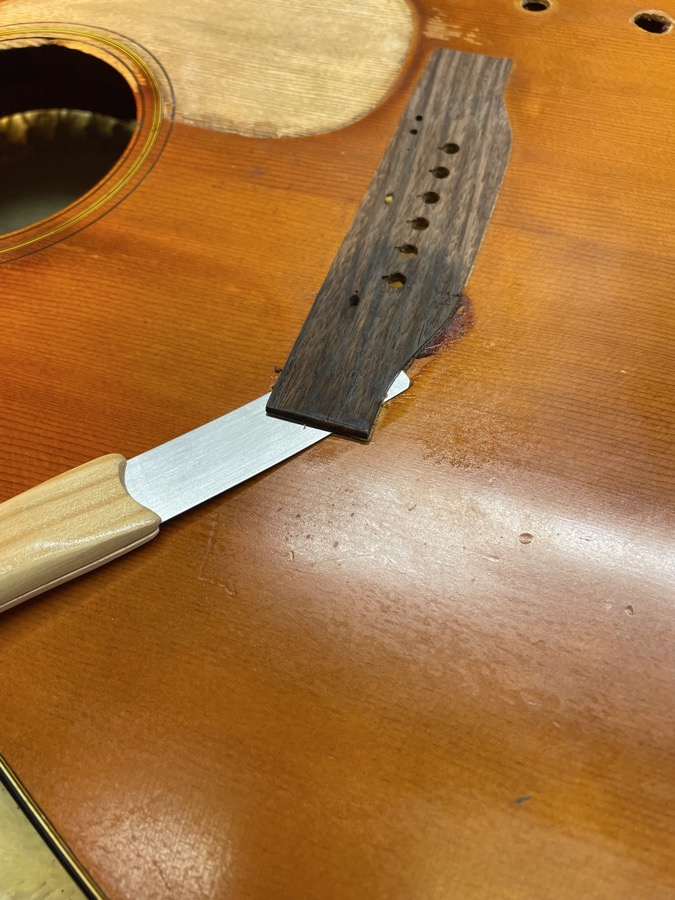

Re: Repair of '74 Martin D-18

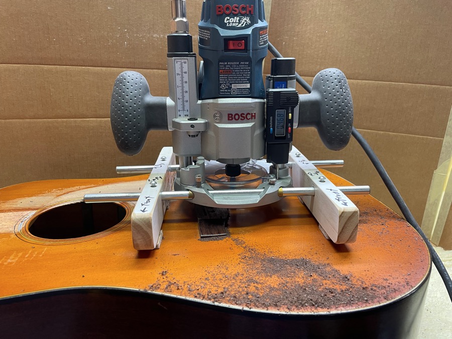

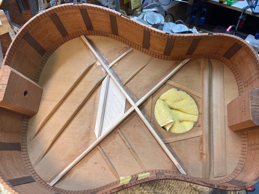

In order to flatten the dome in the top I need to remove the bridge. Since the bridge is so chewed up I will be replacing it so my method is to take off most of it with a router then heat the remainder. This usually gives a quicker and cleaner removal. I heat up my bridge plate iron with a torch and go to town with a putty knife, which in this case is a new one from Rockler that is a nice small size, ideal for this job. I still got a big spruce chip tear out and will remove it with a razor blade and reglue it with HHG.
