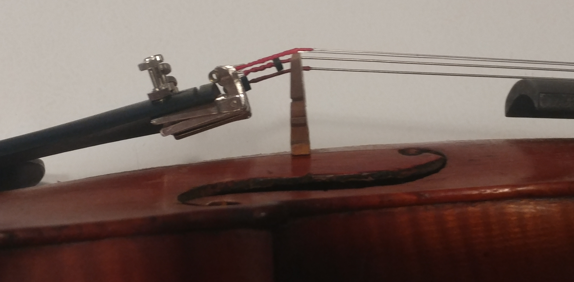

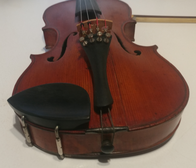

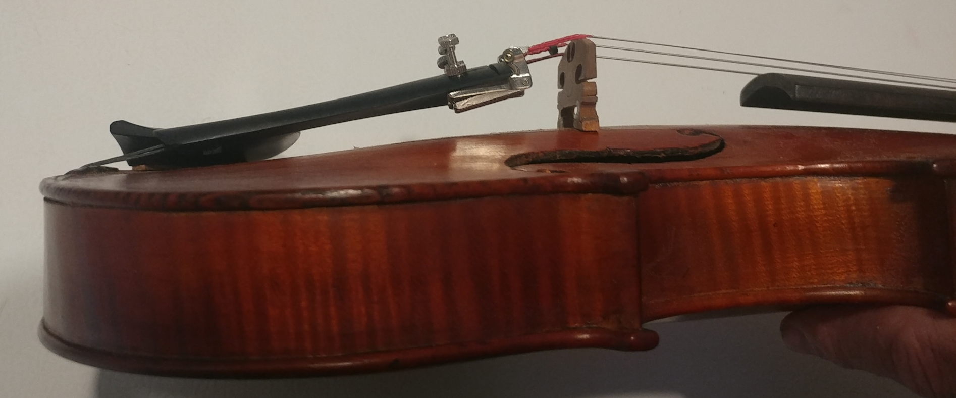

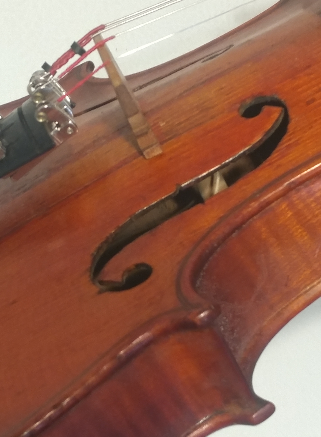

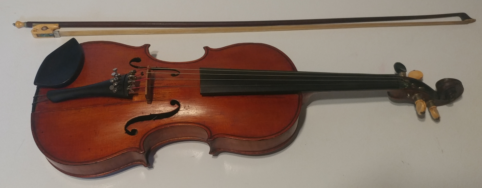

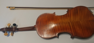

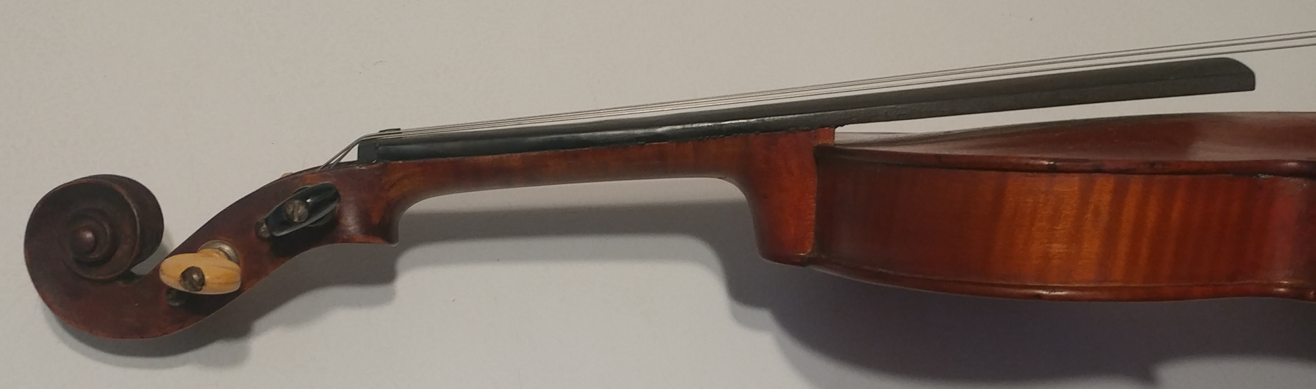

This is my grandfather's violin, handed down. Pics attached, and per the rubbing on the back of the violin case, it's a 1902 "New Century M&W Co." (or thereabouts) violin. No other maker's mark on the violin itself. I've attached a series of pics, and there's both some oddities to ask about, and repairs that I can spot.
The oddities are:
1. floating bridge assembly, with a wooden piece (also standing loose) in front of the bridge. Normal for the time?
The repairs I see:
2. crack in the top, from base (below bridge) to start of soundhole.

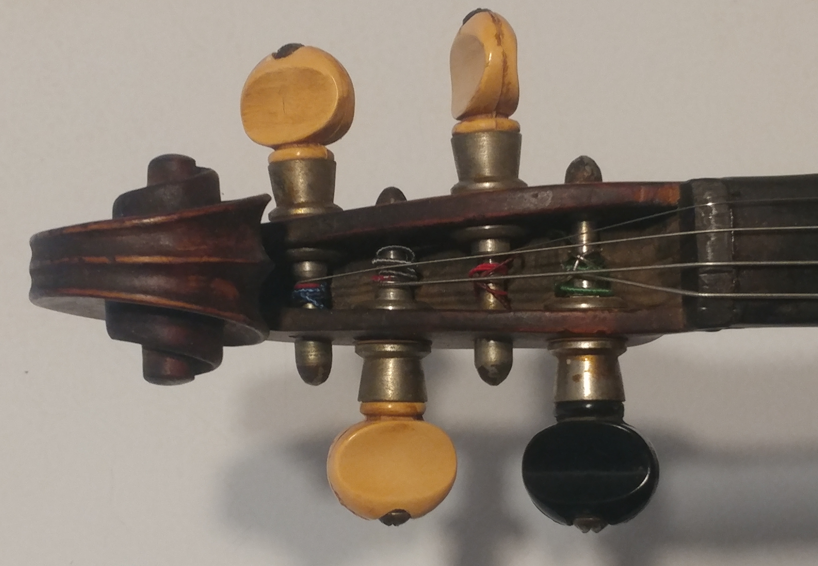

3. tuning pins on right side of top view don't hold; set a tune, and then they spin back a bit.
Can you spot other oddities/repairs-needed that are present? Can the wood be identified?
Can't seem to pull up company info, but still looking. I seem to see very similar ones on EBAY, so this may be a common variety for the time period?
Hit the limit on files/sizes, so a 2nd posting will have the remaining pics.
Thanks for your time!

I don't think anyone here would attempt to give a comprehensive list of repairs without having the instrument in hand.
My guess is there is no maker's label or other identifiers in the violin. These instruments were imported in great quantities and sold under the importer's brand. Probably of German origin. I agree that the rubbing only refers to the case.
I'm sure it needs a bunch of stuff done. That top crack looks like a top-off repair to me, not inexpensive. The tuners are probably not original to the instrument. There is usually a leather washer inside that provides friction. I would be tempted to install new ebony pegs. Once again, not an inexpensive job. There should be a dowel (soundpost) placed between the top and back. It probably became dislodged over the past hundred years.
The prudent approach is to find a reputable violin shop nearby and let them give you an estimate to repair as well as an appraisal of value. Don't be surprised if the shop charges something for this.
Armed with this knowledge, you can decide how much work, if any, you want to invest in your heirloom.

Just to let you know:
1. Your bridge is the separate, free standing part. The long black piece of wood which holds the strings is the tailpiece. Both look quite normal.
2. Your tuners adjust via the screws through the buttons into the tuner body. To tighten the friction, tighten the screw. But once any looseness is taken up, 1/8 turn at a time. Over time the button shrinks and the screw is too long - don't keep tightening or you'll strip the threads. The cure is to shorten the screw 1 or 2 mm.
