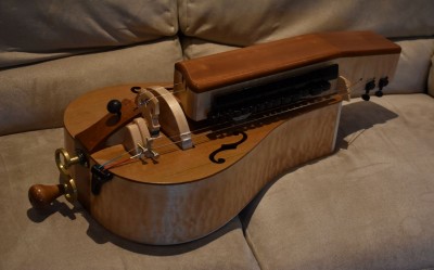

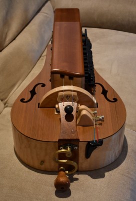

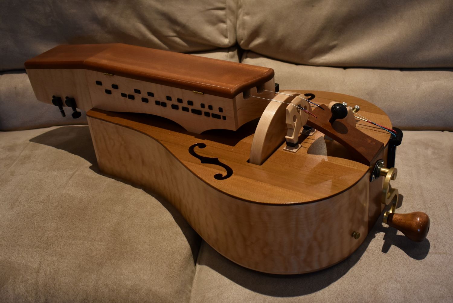

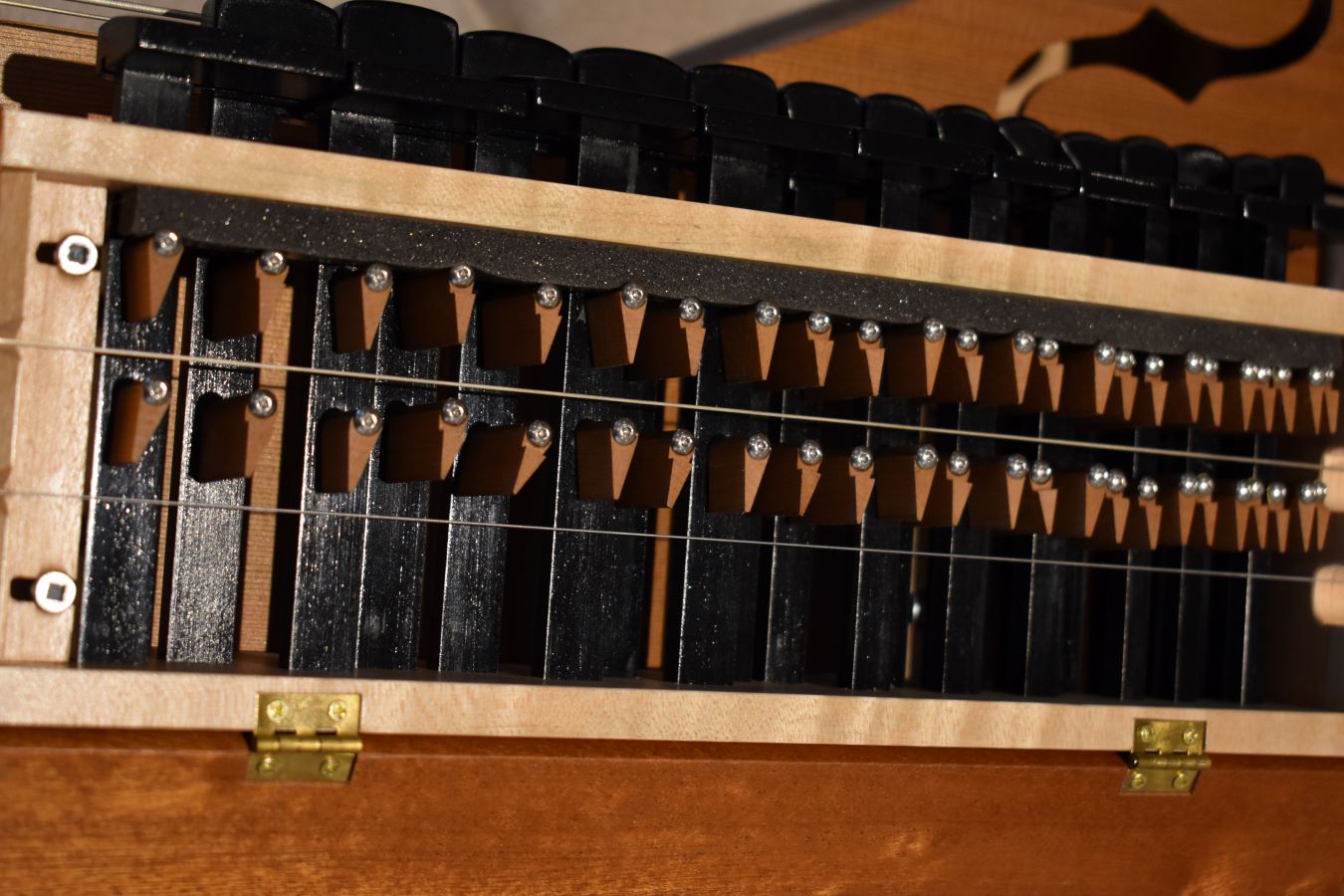

Here are some pics of the finished unit. I used free plans from the internet but changed most everything to make it my own. I looked at a lot of you tube stuff and professional builders to try and get an idea of how to build this. I wasn't aware of this site until after i built it so i had to study pictures and do the best i can. Wish i found this site earlier.

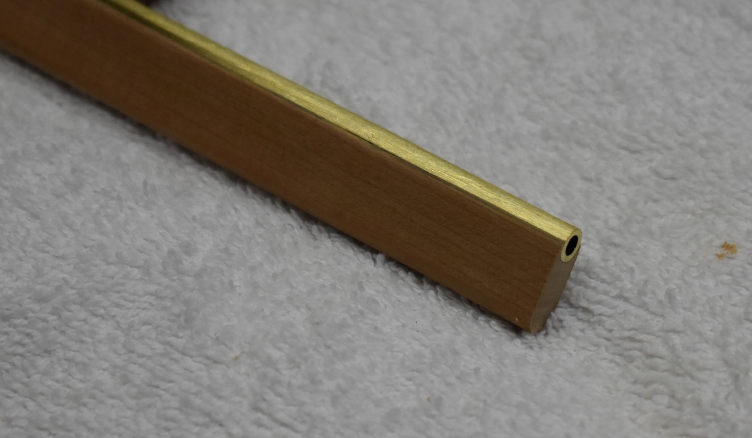

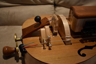

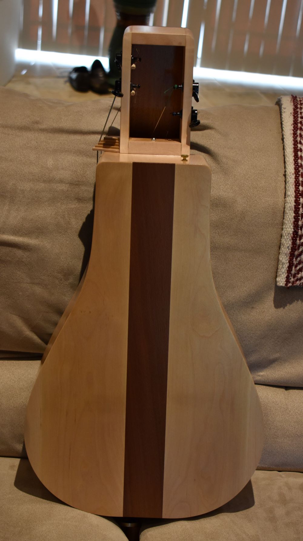

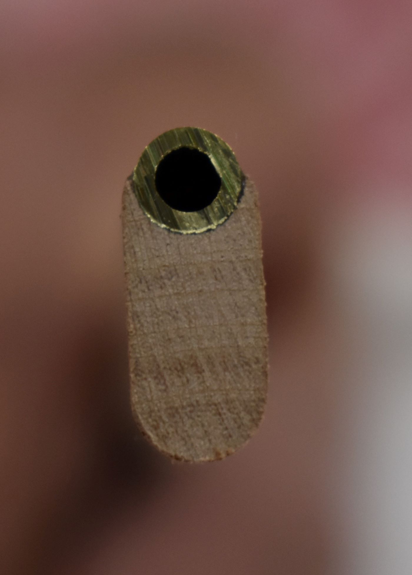

I glued a strip of mahogany into the back and then carried up the end and tail piece and lid cover. I didn't want to make the tangents with the traditional wooden peg pushed into the key so i decided to glue a brass pipe to a strip of cherry and attached it to the keys with a 4/40 cap head screw.My finished hurdy gurdy

Beautiful job.

I originally left the tangent wood as seen in the picture thinking it mimics the metal tangents i see on the more modern models but it quickly became evident it will not fit well on the upper keys so i removed all of them and sanded them more into a point.
