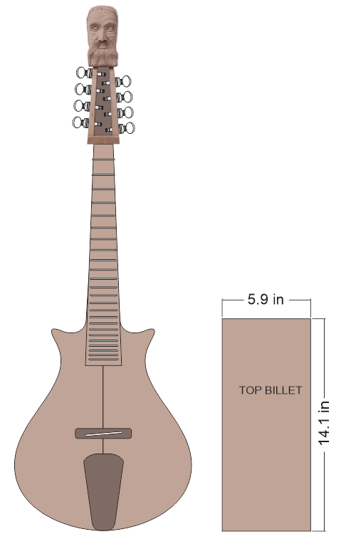

Well, wonderful as traditional bending is, I really want to find a different way for this project.
I will be very, very limited for shop space (and equipment!)
It's going to be a fairly petite-ish thing, but I plan to make it very DEEP - maybe five or six inches, perhaps reminiscent of a guitarrón mexicano.
I haven't quite decided on the sound holes yet, but I'm pretty sure its going to have this sort of outline:
But still very much waffling on the double cutaway vs. the single cutaway... That single cutaway is still vexing me with its ever-so-slightly ugly upper bout!
The board there is for the top billet size ( before bookmatching )

For a mandocello ish instrument you need to consider the scale length and the strings you are going to use. START THERE. They tune from low strings to high C,G, D, A.
You might consider converting an existing instrument to meet your needs, as several guitars have been converted to such purpose.

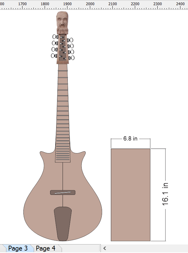

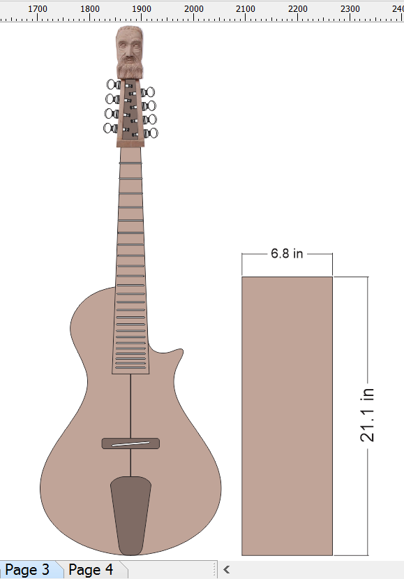

Re: BODYBUILDING with Lazy radicals...
That's good advice, and I actually have been looking around for body donors... [CUE: theme from Frankenstein...]
But so far the only thing that looks appealing is one of those Washburn travel guitars, and I don't think I could bring myself to butcher a serviceable one (haven't found a wreck yet!)
Anyway, certainly more fun building something 'new' from scratch, especially if I can stumble onto something 'progressive'.
I'm mostly leaning towards a 19 inch scale, as I have a nice baritone uke that size, and it fits my fingers nicely.
Could go as long as 22, I suppose... but smaller means more top wood choices are likely to come my way.
This is the double-cut with a 19 inch scale (earlier drawing was 22.2, as it happens)
Those are Gotoh Planetary banjo machine heads, incidentally.
They just fit in my facsimile standard cello headstock template
A few years back I had a cheap little mandola or mandocello for a couple of days ( it was 19 inch scale, I am pretty sure - so halfway between mandola and mandocello proper, I think!)... and I enjoyed fooling with immensely.
If I can make one that sounds something like that one did, I'll be pleased.

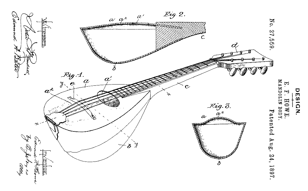

For the size of instrument, with ribs that deep, any sort of solid sides would make it oddly heavy. Everything in your design could be bent easily, or even laminated, except for those horns. If you're worried about the horn points, you could either redesign it to have pointed horns, which would require a miter at the tip, or the horn ends could be blocks that the sides are let into: ie, corner blocks that are exposed, maybe with a contrasting wood that matches the neck or butt graft or some other trim wood.
Why so deep?
- Posts: 23
- Joined: Fri Jun 12, 2015 12:54 am
Why so deep? Good question! It's only my intuitive response... I don't have any scientific basis.
But in my mind's eye I am visualizing a deeper body, sort of proportional to a bowlback mando.
As for any practical reason, I might be tempted to hypothesize that a more substantial "hefty" body could help to balance the large tilt-back of the cello headstock.
I'm conceiving this instrument to be the offspring of a viola da gamba... and a bowlback mandolin... Still pondering!! It will be some time before I firm up a 'side view" of my blueprint... still hoping for some novel construction technique to surface.
Incidentally, why couldn't a carefully constructed "solid" shell be just as thin and light as a bent-wood shell?
Or would that be just wildly impractical to construct?
I think if a solid shell was used, the end grain area would be very weak.
Although, the top and back may be enough to stiffen it.
Not sure, just a guess.
I wonder if laminating veneer over a mold could work?
