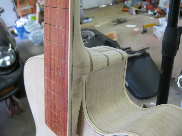

I hope all goes well (we always do) with the neck. I tend to simplify things and not glue up parts to make necks because any glue joint can come apart. I have made multiple piece necks and a couple of them have had issues, which is why I tend to not use that method. Multiple piece necks allows the use of smaller pieces but at a cost in structural integrity. Stacked heels are a carryover from the Spanish construction method which uses nylon strings with low tension compared to steel strings. That construction system is based on the very limited materials available in Spain when the system was developed. Spain has very little natural 'luthier wood' growing, so they used old furniture to cut up and make instruments. The only way to make a neck then was to stack the heels. It was OK for the gut and nylon strings. Modern adhesives may overcome the issue here, time will tell.
I don't know how to 'fit' a straight dovetail. It either fits when you machine it or it does not. Gibson has used such joints in their production line, and they are a real bear to do a neck reset, plus they offer much less 'wiggle room' when final fitting the joint. After hundreds of neck sets I feel the compound dovetail (tapers from top to bottom as well as front to back - Martin style) is more luthier friendly and controllable. I know it 'scares' some folks to try the compound dovetail but once you get your mind around it all is good. Mostly. Aside from my personal perspective the project looks like it is ready for the neck to be glued on and finish to happen. The 'finish line' is close for this race.
I don't mean to dis anyone here, just that I have some different preferences. This should be a very nice guitar when it is finished.

I don't mind if you don't use the neck I made. After this time, I might not be satisfied with it either, I kind of screwed up the binding on the headstock. It was an approach I experimented with, maple and walnut I think, jatoba fretboard, to make a grid pattern on the heel. The joint is 100% Benedetto, fwiw. It fit pretty well when I shipped it, maybe needed some final fettling. You shim or trim them exactly the same as any other dovetail, as I understand it. It's the only dovetail joint I made, I use bolt on for my own guitars.

Michael Lewis, I am very sorry to hear of your loss. You have been a great help and inspiration over the years I have been part of this forum. I lost my entire shop to bankruptcy a couple years ago, or I would have tried to take on part of this project. But I would just screw the neck on and try to "git 'er done". Peace to all on the forum...
