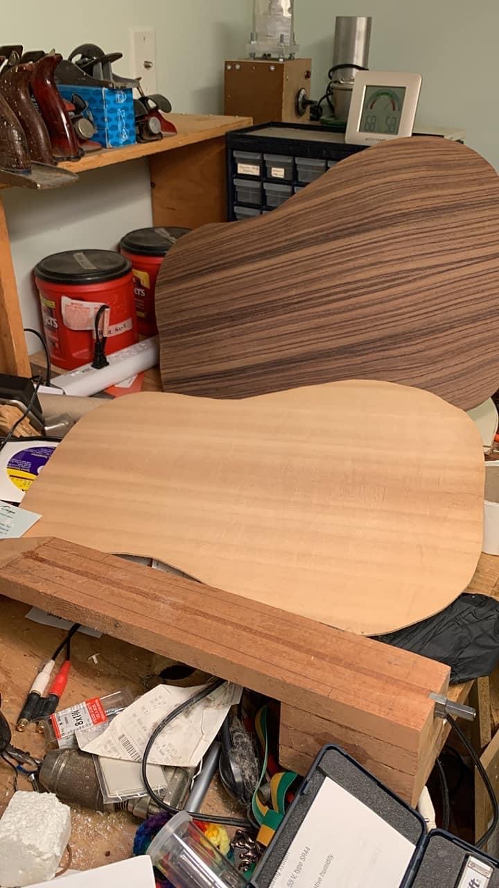

New to the board, but not to luthierie (I made a violin in 2007-2009). Around 2009, I bought wood for making a guitar, but for various reasons, I’m only really getting started now. In ‘09, I got the plates joined and thicknessed, and started making the neck. I’m following Cumpiano’s book. First mistake I made was installing the truss rod upside down, and I’m taking steps to fix that now.
My main question is, how are the sides radiused? Cumpiano explains how to make a set of radius templates for the braces, but from what I can see, doesn’t say anything about the side profile/radius. I’ve seen videos on YouTube showing radiusing the sides on a radius dish (and I’d like to make one, but can’t find information on how to achieve the correct radius). I’m assuming the sides should be thicknessed (and bent/assembled?) before radiusing. I understand that the sides should be about 2mm thick.
First guitar build. Hope I haven’t asked too many questions at once…

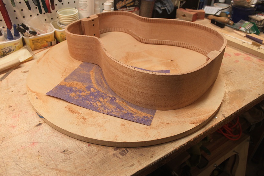

On my first couple of guitars I made a radiused sanding board with 24 and 16 foot radii (which I think is what Cumpiano shows) and attempted to sand the little angle into the rim and kerfing. The problem is that the back slopes at the head block and the waists need to be taller than the bouts - the only good way to do that is by sanding the rims against a radius dish while still in the mold.
Making radius dishes is a hassle but the usual way is to make a router sled that spans the circular piece of MDF and just keep going around and around. I found some pretty reasonably priced at one of the lutherie supply houses and those became my chosen top and back domes.
I have also seen a couple of sets of plans that have the actual side profile which will get you close but still require some sanding.
Ideally this would be done in the mold. Notice the gap at the waists - that needs to be sanded into the dome shape
