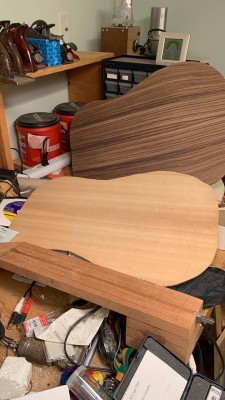

New to the board, but not to luthierie (I made a violin in 2007-2009). Around 2009, I bought wood for making a guitar, but for various reasons, I’m only really getting started now. In ‘09, I got the plates joined and thicknessed, and started making the neck. I’m following Cumpiano’s book. First mistake I made was installing the truss rod upside down, and I’m taking steps to fix that now.
My main question is, how are the sides radiused? Cumpiano explains how to make a set of radius templates for the braces, but from what I can see, doesn’t say anything about the side profile/radius. I’ve seen videos on YouTube showing radiusing the sides on a radius dish (and I’d like to make one, but can’t find information on how to achieve the correct radius). I’m assuming the sides should be thicknessed (and bent/assembled?) before radiusing. I understand that the sides should be about 2mm thick.
First guitar build. Hope I haven’t asked too many questions at once…
Spruce top, EIR back, mahogany neck.

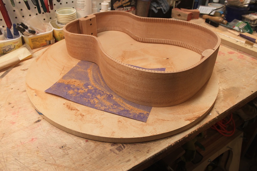

On my first couple of guitars I made a radiused sanding board with 24 and 16 foot radii (which I think is what Cumpiano shows) and attempted to sand the little angle into the rim and kerfing. The problem is that the back slopes at the head block and the waists need to be taller than the bouts - the only good way to do that is by sanding the rims against a radius dish while still in the mold.
Making radius dishes is a hassle but the usual way is to make a router sled that spans the circular piece of MDF and just keep going around and around. I found some pretty reasonably priced at one of the lutherie supply houses and those became my chosen top and back domes.
I have also seen a couple of sets of plans that have the actual side profile which will get you close but still require some sanding.
Ideally this would be done in the mold. Notice the gap at the waists - that needs to be sanded into the dome shape

There are a couple of ways to dress the edges of the rim (usually called 'profiling') to fit the radii of the top and back. A dish makes it easier, but first you have to have one...
One way is to make a stick somewhat longer than the length of the body with one edge dressed to the proper inside radius. Since these radii are usually about 25' for the top and 15' for the back it's something of a challenge to make one. There is a formula that gives the radius if you know the length of the stick and the rise, it's
((A/2)^2+B^2)/2*b = R when
A is the length of the stick
B is the rise
You have to keep the units consistent, of course; if you're working in inches then 14'= 168"
I'd make a long 'brace' with the right outside radius, and use that to mark the inside radius on another piece. You can stick some sandpaper to the 'brace' and use that to even off the curve of the 'inside' stick.
Once you've got that you can start with the two end blocks at a bit more than the right height. Cut the sides to full height from the tail to the waist, and taper straight down to the right height at the neck end (plus a little for insurance all along), and then bend them. Once the sides are glued to to the blocks you can lay the radius sticks along from end to end and side to side, and work out the profiles that way.
I use a shim trick to get outside radii. If you stand on the beach on a flat calm day and look out to sea the horizon is about five miles out: that's where your line of sight intersects the curve of the earth. A rise of about 6' over five miles defines that radius. Suppose you stick a shim onto the sole of your plane behind the cutter with CA glue. The sole of the plane is the line of sight and the shim thickness is your height. Given the height of the shim and a base line from the sole of the plane just in front of the cutter you can find the radius that the plane would make. You do have to take the thickness of the cut into account; the less the cut the the closer the contact point will be to the front of the slot, and the tighter the radius. I use this to radius my braces, and you can use it to make the 'outside' radius to dress off your stick.
One you've got that radius you can also make two concave rails. Attach those to the sides of a box about 2' wide. Mount a lazy Susan on the box and screw a 2' diameter piece of MDF to it. Make a sled with rails that your router can run between that will ride on the radius rails. Set the router up to take about 1/8" off the middle of the MDF disk, and run it across. Rotate the disk and repeat. Increase the depth of cut until you've got a radiused surface all the way across. Do this outdoors if possible: it makes LOTS of dust. I find it helps to glue a piece of 1/8" or 1/4" Masonite to the bottom of the disk first: there seems to be a fair amount of built-in stress in MDF, and it tends to pull up around the edges as you remove material from the upper surface. The Masonite helps keep it flat.

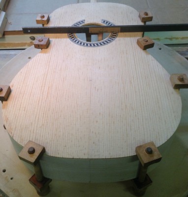

Several things to consider when putting a dome or contour into the sides with a hand plane:
The waiste will be the high point. Exact numbers regarding the arch aren't as important as a good fit.
The inings will be angled down and outward to accommodate the plates. Remember the bottom of the heel block also.
I use a dished sanding plate for the backs which usually works for a good fit. But I dome the tops of my guitars in an irregular manner.
The 3 essential considerations for the top are the height of the saddle in relation to the nut and the resulting action height at the 12th fret.
In that relationship is the angle (backward or forward) of the neck (nut) in relation to saddle height. For a scale of 650 mm being off 1/2 of a degree will alter the saddle height by 3mm. I shoot for 1/4 degree accuracy with a target saddle height of 12.5 mm. That is a tough goal and more than once have had to make another neck to acheive it.
For that reason too I never install the truss rod until after the neck angle is right where I want it. It gets in the way. The other reason being that I use the truss rod channel for a guide in aligning the neck to body center line.
I like to put a slight back angle in the neck and start with a 90 degree neck to top body joint. The doming of the top begins about the midle of the soundhole and is concentrated in an area encompassing that point to the back side of the bridge. I start with oversize sides and plane the contour into the sides using guide marks to keep track of my progress.
