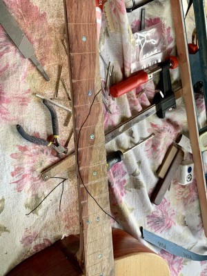

- Posts: 45
- Joined: Wed Apr 27, 2022 8:16 am
Re: Fret leveling… not getting level?!
I’ve found a devious low spot. How I ever thought this was flat I’ll never know. There’s still finish on this area, the rest of the board is bare
- Posts: 1317
Yes. If I'm using a single action truss rod I plane some relief into the fret board when there is no tension on the rod, then straighten the neck with the rod and level the neck and the frets. Then loosen or tighten the rod for the correct relief when it is under string tension. For a double action rod I make the fret board straight, as I can adjust it either way under string tension.John Damon wrote: ↑Thu Apr 28, 2022 8:32 am I understand neck relief (I’m also a player), but for leveling the frets I’ve always gotten the neck straight first, then leveled. Is this not the way?
What type of guitar is that? It looks like the neck/body join is at the 16th fret.
- Posts: 45
It is a baritone. I used bubinga for the neck and fretboard and padauk for sides and back. Padauk seems to like to split…
I once used a piece of Bubinga for a dulcimer fretboard that looked like that. I would plane it flat, leave it for a few hours and when I came back it would have warped. I did this several times and then gave up on it. The board had some internal tension that would twist the board and couldn't be planed out. I was glad I caught it before It was built into the instrument.
