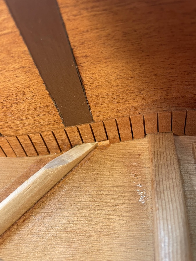

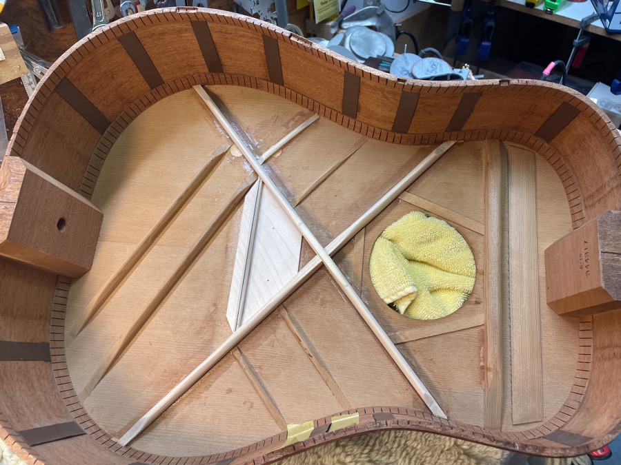

I just recently replaced the X-braces in a Martin after taking the back off. It was difficult enough that I would never try it through the soundhole.

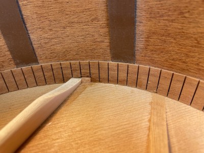

As you can see above, I replaced the x-brace with the back removed. It can be done but takes a bit of finagling. You have to carve the braces down and scrape till you get a clean surface. Excavate the brace end that extends into the kerfing. Make the new braces with enough length to extend under the kerfing. When installing the braces I found that you can twist it into place so that the ends pivot into place. After gluing into place there will probably be a few gaps in the kerfing that can be filled with small wedges of mahogany. I will try to get out into my shop in the next few days and post some photos of the final results.

Here are a few photos of my X-brace replacement on a '70's Martin D-18. Both ends of the braces are tucked so it took a little maneuvering to get the new ones installed. I excavated the brace ends and cut a piece of kerfing out to allow the new brace to be pivoted into place. Once glued in I plugged the kerfing with a small wedge of mahogany. The lower X-brace was glued in and allowed to cure before the top one. I still have a bit of scalloping to do before closing up the box.
