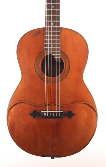

Yes, I've been doing some experimentation with an additional plate on the inside of the guitar. My idea was to increase the length of travel for the lowest sound wave to affect a lower timbre. Sort of like a transmisssion line loudspeaker where the length of the chamber is equal to the 1/4 wavelength of the fundamental resonant frequency of the speaker.
In my searches on the subject I found the concept put into practice by several makers in the past and one currently. In the 1930's Maccaferri made his "internal resonator" guitar and before him there was Lucien Gelas, who made a guitar with an additional resonator plate on the top, but oriented in the opposite direction as the one on the tanbur in the video. Here's a Gelas instrument from the 1920's:
The Ramirez company still makes their "de camera" model with an (2 cm?) inner ledge around the inside of ther guitar.
I've done this with two guitars and have two more underway. I find the results pleasing. Currently my attempts have focused on the angle of the inner plate, and their length is midway, to coincide (in theory at least) with the node of the sound wave in hopes of producing a gain in combining their energy.
My next experiments will shorten the length of the inner plate to coincide with the node of the 3rd harmonic. Here is a picture of my prototype model from about a year ago.
