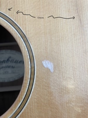

Was prepping to dropfill a ding on a Kronbauer. Was sure the finish was nitro, but when I dropped a bit of lacquer thinner into the spot to melt the cracked finish in the ding before dropfilling, the finish chalks up when the thinner dries up. I tried on an inconspicuous spot to confirm and get the same chalking, and maybe sorta softens the finish, but not like nitro would. The chalking just polishes off.
Anyone know offhand what this result is trying to tell me? I can't get ahold of Trevor Kronbauer to confirm.
What cured finish chalks up with lacquer thinner?

Thanks for the responses.
Yeah, it's definitely not a nitro finish. At first glance I thought it was because of a couple small finish checks. (And what I thought was softening lacquer wasn't.) It's not TruOil - (which I wouldn't expect for a production guitar). Maybe a poly, or some sort of WB or conversion lacquer?

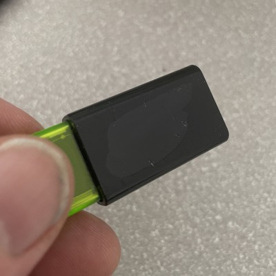

It's not cheap thinner. It's a "professional grade" (says right on the can!) pure product from a commercial paint shop. I've used it on other woodworking without issue, and used it on other instruments (that were nitro). Talked to Mohawk (I am using their NC lacquer) and they gave it thumbs up. I'll try some other thinner to test Barry's suggestion. But I tried some flash tests on other surfaces in same environment and comes away clean. This test on the USB key is a 10:1 thinner/nitro, which produces same chalky result on the guitar.
It's weird. Here's another brush-on over some light scratches in another area after flash off. Same mix as on the USB key. Just polishes away with a finger. ¯\_(ツ)_/¯

Re: What cured finish chalks up with lacquer thinner?
So...finding other anecdotes and rationale of this. Comports with Barry's experience, though seemingly not limited to cheap thinners. Sunnyside is a respectable product.
Though this explanation is a bit odd when I was getting this using straight thinner. There wouldn't have been solvents to trap. Unless some reaction with the wood. Odd it happens on some surfaces and not others. Got the same result on a known NC finish.
Will pick up some other thinners today to try. I have used this brand of thinner in the past, but perhaps formulation has changed. I don't see it really mattering since the chalkiness dissolves away with the next application of dropfill, and final finish will polish away. Just unsightly. Guitar top looks like it had a acne breakout.
