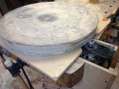

Here's mine. Like Barry I use a 16" lazy susan bearing. Direct drive like you see used on a carnival ride. The motor is separate, mounted on a hinge and leans against the bottom plate with an 'O' ring on the drive collar that grabs the perimeter. The double thickness dished plate is interchangeable and locks in with center and edge dowels. It stows away nicely which is important in my small workspace.

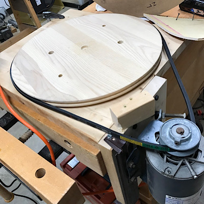

The pulleys are 1.5” and 20”. The motor is 1/6 hp and 1140 rpm. The dish turns at 85 rpm. I don’t think I’d want it to go faster, but this speed seems about right. The dish bearing is a 12” lazy susan bearing. After a year of use, there are many iron filings around it. I think it will be a consumable. The wooden pulley has a groove cut around it’s perimeter to retain the belt.

My motor is a two speed (1140/1750) salvaged from a washing machine. In this application, I will never use the higher speed.

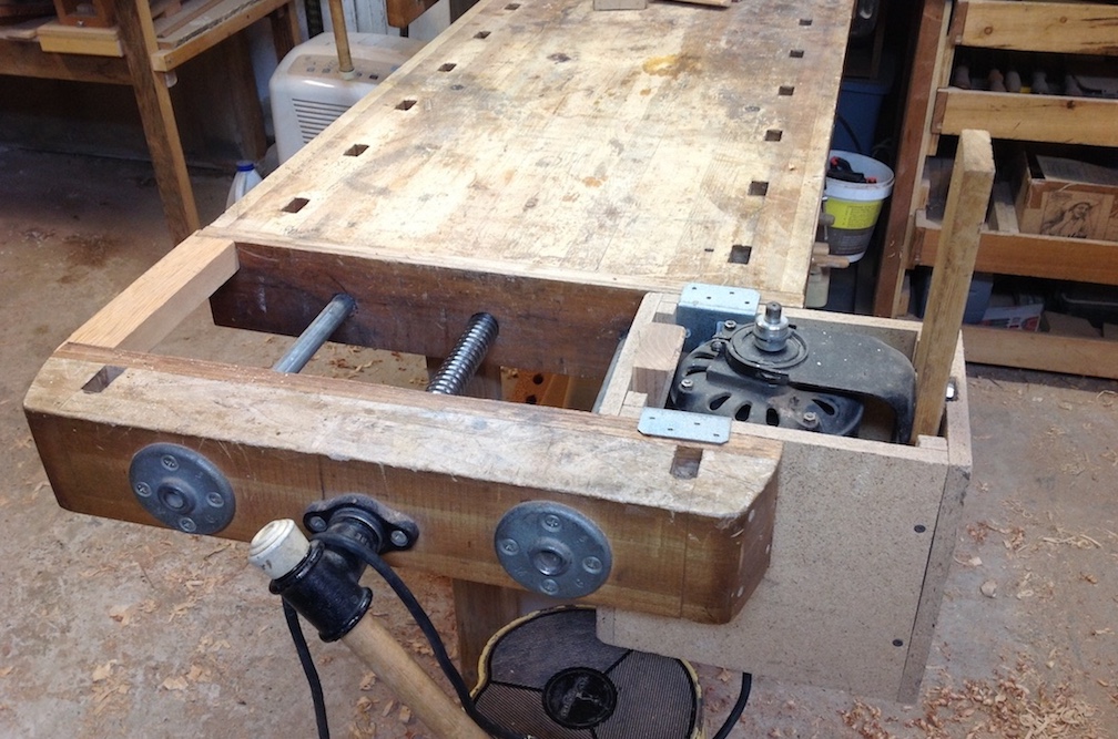

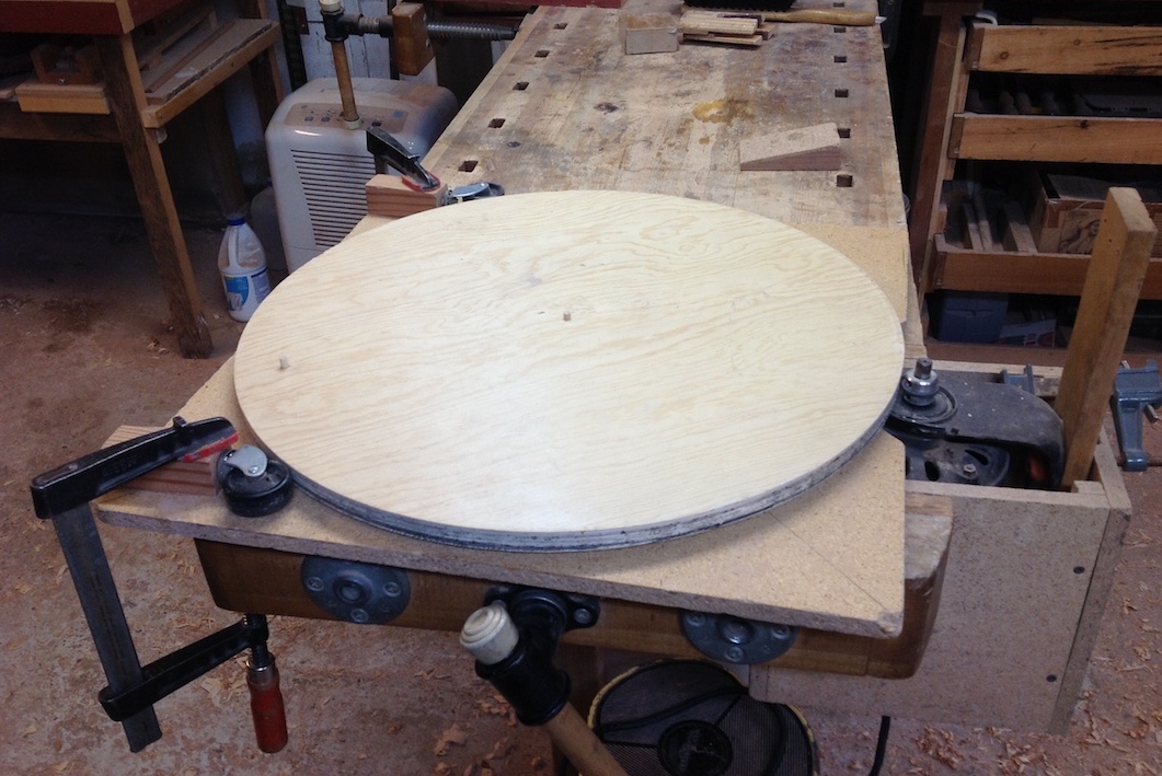

For mine the motor is from an old washing machine; 1/4 horse, 1750 rpm. Mounted in a box with a hinge at the bottom so the bearing shaft leans against the drive plate rim at just the right angle. The weight of the motor provides good traction.
The sanding platform is 24 inches diameter and the edge has been impregnated with epoxy and smoothed over. The motor shaft has two collets locked on with hex nuts with a neoprene O-ring in between that grabs the edge of the drive plate. Travels around 75 rpm without any work pressure on it.

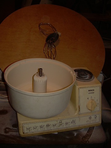

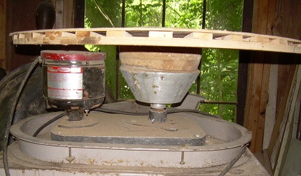

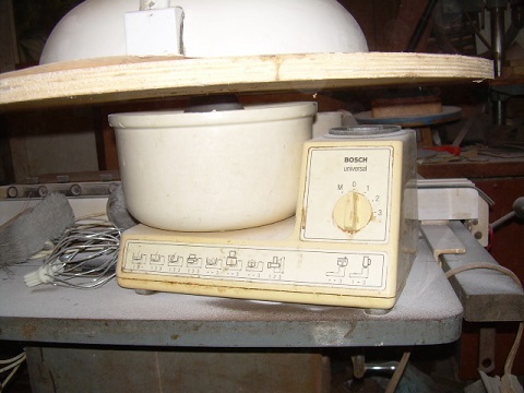

I 've made a couple - one from a bowling ball balancer and one from a Bosch mixer. The bowling ball sanding dish runs rather fast and can take off a half inch of material in just a couple of minutes, so a careful light touch is required. The Bosch universal mixer has three speeds and allows the dish to be swapped out quickly.
