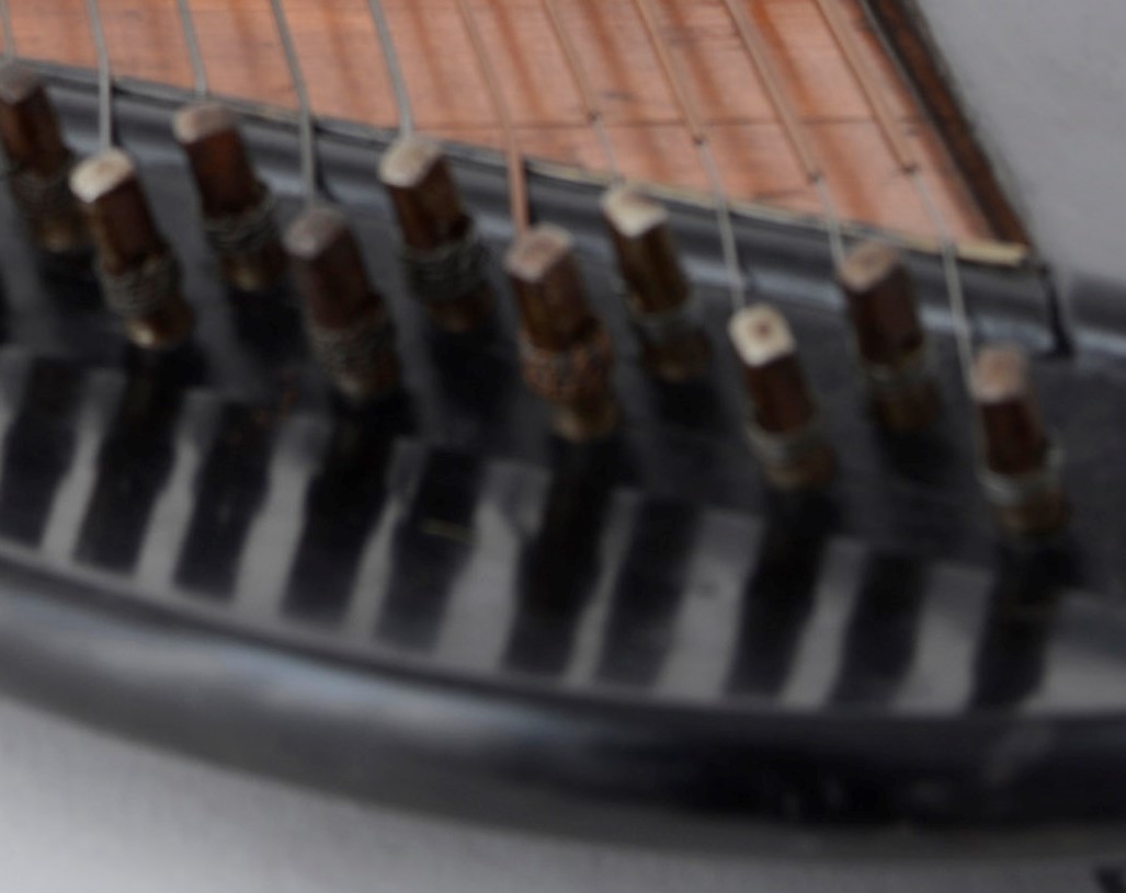

Sorry this took so long. Other things on my plate. But I don't think I did this right. I found the image button above the message field, but upload? All I could do was paste in the image file title. Dragging the photo into the message area didn't work. I will post and see what happens, but if it doesn't work, then I need clearer instructions.
Well, I guess it worked! Anyway, in cropping the photo to fit size limits, it enlarged and got somewhat blurry. I won't say that what shows here is at exact size, but the pins sure look like they are for a piano, not a zither. But the point is: where were the pins made?
Re: Vintage tuning pins
I can't really comment on the pin origin from the photo. If I could see the instrument in a whole pic I might be able to help more. It is possible that they are harp (not autoharp) pins or hand made.

I would say it is possible that the pins are handmade, although they do look consistent from one to the next. I was hoping the rectangular ends might indicate something. Does anyone know when tuning pins were made by machine or molds or however they are made?

I don't think those are harp pins, which are tapered and basically work like violin friction pegs. Harp pins are made of metal, not wood, of course, and instead of heads have squared ends.
I have seen old piano pins that looked as though they were forged; the top is roughly rectangular in section, with the short sides rounded, as if they were hammered to shape. Most likely a drop hammer and jig was used to make them more or less uniform. Since they could not easily be made identical that way they tend to be tapered; so long as the taper is right and the small end is not too large the tuning hammer (what tuners call the wrench) will fit. Modern autoharp/piano pins are tapered, but square in section at the top.
It's a little hard to say for sure, but these look to have sides that are parallel along the length. This, and the lack of rounding on the corners, suggests that the wrench was made to be a tight fit, and that they're all pretty close in size. That would be easy to check out. A pin like that could be filed out by hand with a proper jig (I've done it), but it's not fun, or quick. Even a fairly early milling machine would make short work of it. I'm not exactly sure of when that technology came along; I suspect it was in the mid-19th century. There is a local museum that has one of the first Bridgeport milling machines, but I can't remember the date on it. It's the 'Precision Museum' in Windsor Vermont, and you may be able to get in touch with them.
You can see the shallow threads that were cut into the shafts of the tuning pins down near the wood. Harp pins, when not smooth, would be knurled, often with lengthwise marks. Piano/autoharp pins screw into a tight hole.
The strings look to be made to the proper length. You can see that the winding stops just short of the bridge, at least on the heavier ones. They could have been trimmed off, of course, but if they were not (and don't show cut marks on the winding to suit) that would suggest that this was not a one-off.
Come to think of it, the pitch of the instrument could be a clue as well. Up until the industrial revolution long lengths of uniform wire for strings were hard to make. Brass or bronze were more common than steel. Pianos didn't definitively displace harps until the mid-19th century, when good high-quality steel became more common. Brass and bronze strings tune lower at a given length than steel, so the pitch of the instrument and the string length will say something about the strings it was designed around, and the time period.
So, the little I can see suggests late 19th century, or early 20th. I'd guess it's a production instrument.

Alan is right. I wasn't thinking when I suggested harp pins. Zither or piano pins have been around a lot longer then the autoharp. Just think of all the variants of what we call a hammered dulcimer, cimbalom etc.

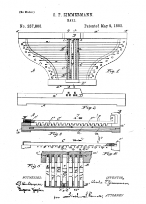

Does you instrument look somewhat like this? If so it is probably American made, by Charles F. Zimmermann. If that is the case you still have a very rare autoharp, as Zimmermann patented the deign in 1882. It is not known if any exist.

No, it does not. The instrument pictured is only slightly similar, and while others view this and the German autoharp surrounding this thread as a match, to my eye the construction is vastly different
Just for the record, I have dissected US257,808 >significantly< enough to make anyone’s head spin! There was a LOT more going on between the patent’s file date on December 10, 1881 and when the first autoharps were marketed commercially (the earliest ad I’ve found was published on Nov. 12, 1885). And quite a lot went on before the patent was filed. Certain implications within the patent’s text are bigger and more encompassing than one might realize!
And yes, a couple years ago, I scoured all the Music Trade Review issues online, btw, along which much, much more. In fact, I was looking at my own, 53-page timeline where I keep track of CFZ’s work, just as notification of the above post came in. The most telling, printed piece I own is CFZ’s “first edition” (of three) of a pamphlet he wrote, titled “Simplified Harmony Teacher.” I have photocopies of the other two editions, but this first edition in my possession is the real deal. Its content is absolutely astounding compared to the other two. It has helped to zero in on the instrument surrounding this thread.
So I’ve been doing the homework—since 2016! However,, I welcome mention of more resources, just in case I haven’t seen something yet. US257,808 barely scratches the surface of one man’s large and colorful, yet often misrepresented, career.

Well, there’s a photo of CF Zimmermann playing an autoharp shaped like Fig. 1 in US257,808, so we know he built at least one, maybe two.
But back to the tuning pins on the autoharp in Grmany: they look fatter than what CFZ put on his autoharps, more like piano pins. (I own a Philadelphia autoharp and haven seen an instrument he made that’s similar to what’s in Germany, having zither pins, too.)
