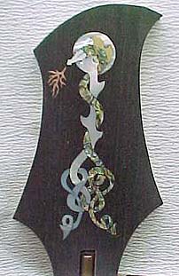

Meet Amy Hopkins, of Stringed Instrument Repair in New Freedom, PA. Amy has designed the artwork for the inlay on this bass, and she did this stunning Dragon inlay on the peghead!

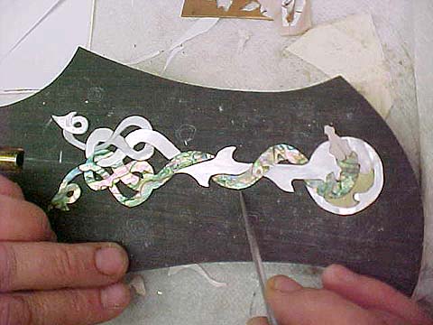

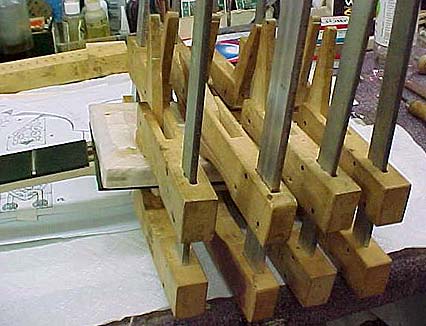

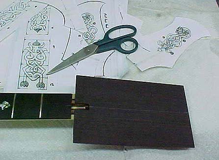

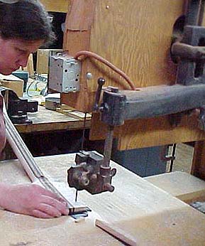

Amy provided a few of photos of the peghead inlay process. In the first photos, she is cutting out the peghead shape and gluing on the rosewood peghead veneer. You can see the drawing at the top of the pattern, and some of the inlay sections are shown. Also visible is a piece of abalone with inlay pieces marked out and ready to be cut out, by hand.
