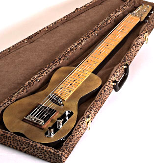

Erickson, Ellie - 02/23/2009.16:55:18
Unless you're going to be touring with it, most upholstery fabric will work. I've got a few here that saw a lot of mileage and are still holding up fine.
Here's one of them.
