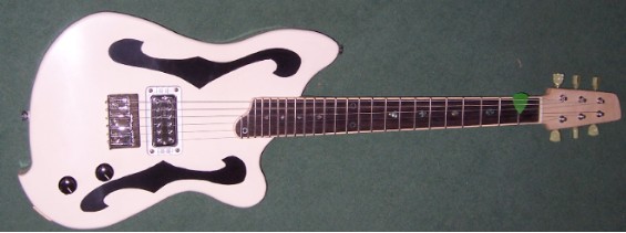

I have just finished this guitar as a present for my girlfriend. She said that she wanted a daisy rock guitar in the shape of a heart or a flower. I suggested that she design her own and this is what she came up with, nothing like a heart or a flower though. It was all built on a tight budget, except for the pickup which came from my first guitar.
The shape is roughly based on a Ampeg Bass. We lengthened the upper horn and added the little curl on the lower bout (The curl is an idea borrowed from a guitar i built with a guy called Matt Redfern, Hopefully he will post pictuers soon because its a stunner). We decided to paint f-holes rather than cut them out just to keep everything easy, otherwise she would have been sanding the insides of he f-holes herself.
Heres the specs:
Mahogany body
Flamed maple neck
Indian Rosewood Fretboard
Cream binding
Top loading hardtail bridge
TV Jones Filtertron Plus
Epiphone tuners (not sure about the snot green buttons)
24" scale
Abalam and Green sea snail inlays (card suits), aluminium ring dots.
Rattle can finish (ford ivory, black f-holes)
here she is:

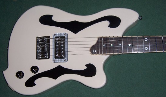

Closer view of body. Dont look at the little bit of sand thru on the upper horn. This camera is a bit unforgiving, it shows up my faults . We have both decided that neither of us will mind if this guitar gets a little beaten up, i think it will look nice when slightly abused.

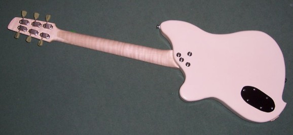

We decided not to bother with any contours on the back for simplicity. The flamed maple neck is just finished with danish oil. It was going to have a bubinga neck with a carved scroll, but i found the it impossible to carve the bubinga into a basis neck shape. So i scrapped it, it will be a while before i try bubinga again.

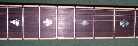

Heres a shot of the playing card suit inlays, The club and spade are abalam and the heart and diamond are green sea snail, the colour difference doesn't really show up and the club had quite a lot of filler around it.

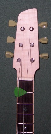

Plain and simple headstock
Noel, Nathan - 02/15/2005.11:01:50
Very cool... Looks like a cross between an Ibanez PGM and Ibanez Talman
Fredholm, Magnus - 02/15/2005.16:13:33
I really like stuff, all kinds of stuff.
I can smell the Rock'n'Roll from a mile off;-)
Is your girlfriend one to wear her hair beehive-style? Or is it leather jacket and jeans? Anyway, that guitar fits the bill:-)
The neck-ending is, to me, very impressive. Is the neckpocket the same shape as the fretboard or does the fretboard extend?

The fretboard extends from the 22 fret and it is a standard fender style neck pocket. The 24th is more for visual effect than actual playability, i dont think she can quite reach it but i can so thats ok. The curl on the end of the body was mandolin inspired so i echoed that with the fretboard, the shape of the body didn't quite work without it. I am still not sure about the single dot on the 24th fret but i felt it needed something.
