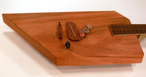

I got a call from someone who had seen one of my cigar box guitars played in a club, then found my site. The caller said "I'm working on a new movie starring Danny Glover, Keb Mo, Ruth Brown and Gary Clark Jr. The story takes place in 1950 Alabama and Gary plays Sonny, who plays the first electric guitar seen by the people in the town of Harmony. Basically, the guitar is a neck from a store bought screwed to a plank with weird, exposed wires. Can you build it?"
When I realized it wasn't a trick question or I joke, I said "Of course". I sent him an email with some specific questions about the script and followed it up with pics of a mock-up. I got the job over the other builders he contacted.
Here's the mock-up:

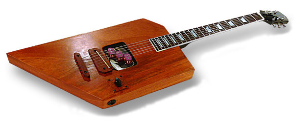

They loved the design. I decided to use a one piece Maqhogany body. I also decided to keep it homemade looking and create my own pickups. Here's the initial mock-up.
Crocker, Ted - 10/17/2006.12:08:42
What can I make with all this sawdust?
I went with (3) double string pickups. I made a winder using a generic Dremel wired into a sort of dimmer switch. I was under a very tight deadline (14 days) so I ordered a neck. Here's Honey Dripper Guitar:
Crocker, Ted - 10/17/2006.12:13:36
The script called for exposed wires, so I sunk the pups into a cavity and left it uncovered. I used cloth covered wires. I was concerned about noise, so I used a brass saddle, to which I soldered a wire that runs into the recess and to a lug made from a small brass brad. All the cavities are painted with conductive shielding paint, so the cavities themselves are part of the ground circuit. Another wire soldered to the lug runs through a hole in the recess to the back of the volume pot, and another from there to the jack shaft.
During the winding, I sprayed clear lacquer, thinking that potting with wax would 'cloud' the coils. The guitar is suprisingly quiet, and they described the tone as 'syrupy'. The soundtrack is complete, and they're filming as we speak.

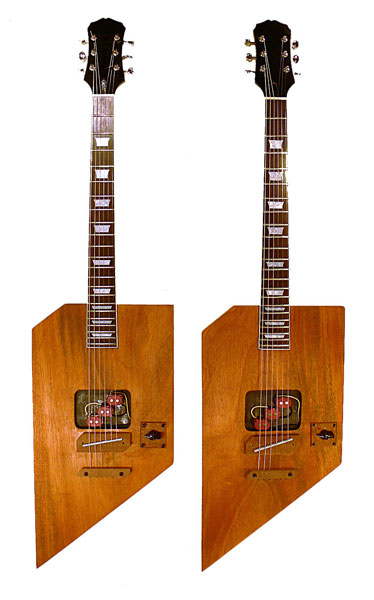

I used a rifle case to ship it. I also included a vintage leather strap and vintage cable, as well as two of my Buffalo Horn guitar picks.
Crocker, Ted - 10/17/2006.12:17:13
I forgot to mention, because it's 'Hollywood' they wanted an extra guitar, just in case.

Cool! Is that leopard wood that you used for the bridge, tail piece and control cover?
Crocker, Ted - 10/17/2006.12:33:45
Yeah Travis, I forgot to mention that. The bridge, tailpiece, control cover and bobbin bottoms are Leopardwood. I used Purpleheart for the bobbin tops. The guitars were returned to me for mods. It seems John Sayles, the writer/director, wants to record the guitar live during filming. One scene calls for Sonny to jump off the stage in the Honeydripper Lounge (Glover's Juke Joint), wind through the crowd, out through the door and play in the street. The mod they wanted was an additional jack on the back so they can hide a wireless rig and use a dummy cable. That jack plate is Leopardwood, also. Of course I included that jack in the ground circuit.

Believe it or not, I already got an order for another Honey Dripper. I'll be finished with all the cavities and roundover the edges today. I'll be done with the pickups in the next few days and have the guitar ready to ship the end of next week.

Very cool! I look forward to the movie. I don't think the fretboard inlays and binding really match the rough-hewn vibe of it, but then again, I can imagine the protagonist hacking the neck off of an Epiphone archtop and joining it to his own handiwork, similar to your own build process. I'm sure the deadline gave it some of that simple, rustic mojo. Please post sound clips if you can.

Brian,
After reading the script and talking to the people involved, I conjured up a story of Sonny dejectedly walking home from a gig with his broken acoustic. When he saw a plank laying by the road, he got the inspiration to build an electric. The script noted that Sonny was a 'Radioman' in WW2 who cobbled together his creation. Hence, the exposed wires.
Believe it or not, the deadline only added to the rough hewn look. Given more time, I might have been guilty of over-engineering it. Almost half of the deadline passed before I got materials delivered, so I wound up doing most of it in a week of 20 hour days.

Ok - a guitar question, sort of. What's with the feather? I ask only because it was such a wonderful touch (and in post #4 it looks like it's wired into the circuit, some sort of crossroads mojo goin' on?)

JC, the feather is just good spirits from me & Taxi. A karmic or mojo thing. Somehow it got to where every project has a feather. Taxi is praying for non-success. I would too, ever see a bird with a comb-over?

I offered to 'relic' the guitars, but they opted to let the art department work with the director to express his vision.
