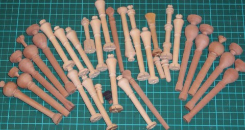

Walsh, Michael - 09/24/2007.16:54:02
Oh Stephen. You just don't know what you are missing. Pegs, lovely pegs, more pegs. End pins, lovely end pins, more pegs, more end pins,lovely lovely pegs.
Faulk, Stephen - 09/24/2007.17:11:19
Those are beautiful pegs Michael.

Walsh, Michael - 09/24/2007.17:36:55
Had to google for Advil, it's an NSAID which is strictly out of the question with the condition of my stomach :-( Actually the background is one of those self-healing cutting mats.
Slicing down the keys? I assume you mean how do I go on to form the heads? I simply use a flatish (sharp) gouge to remove most of the bulk. I then take them to a hand crank grinder which has a small hardwood 'wheel' with abrasive glued on it. The tool rest acts as a guide. The hand crank also doubles up for blade grinding and I also made another hardwood wheel that is impregnated with honing compound. Now that's what I call getting maximum use out of a tool. Might be able to use it as a mini lathe as well. . . .
Coleman, Tommy - 09/24/2007.17:59:52
Cool Michael. Thanks for the pic. I am looking into the mini-lathe, they are so cheap that it does seem pretty economical and fun to boot to make my own pegs. Still aways off though.

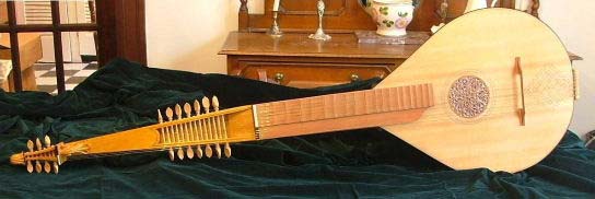

FWIW, here's an easy peg pattern I learned to do while working on a 14 course ceterone (this is the upper pegbox -- the lower pegbox has an additional 14 pegs). I took the peg head shape from a chocolate football..:-)
Faulk, Stephen - 09/25/2007.19:53:07
Ron, those are cool too.
I found the football and bell shapes easy too, but I've never tried to make a peg with a back cut on the ball.
Senseney, Steve - 09/25/2007.20:46:55
Ron--
Can we see the rest of that instrument?
Faulk, Stephen - 09/25/2007.21:15:03
Yes Ron, show and tell.
Banks, Ron - 09/26/2007.01:27:22
Thanks, Steven and Steve -- I really don't have any decent small photos of the whole instrument, as most of them I've taken either have problems due to the instrument's size (about 5 1/2 feet long) or white-balance issues. Let's just say its got lots of pegs and lots of purfling...and isn't really as orange as it looks in the photos (almost as orange, but not quite) :-)
There are some better resolution images and detail shots of it in the "New Instruments" gallery of Andrew Hartig's "Renovata Cythara" site, but here's a shot to give y'all an idea of what it looks like.

Ron, that is just beautiful! I also saw your other instrument at the Hartig site. Nice work. Where do you learn how to make an instrument like that? Did you use museum plans? The rose on the ceterone (cittern?) is just amazing. What is vegetable parchment? Is the scalloped fretboard typical? So many questions. Anyway, thanks for sharing.

Banks, Ron - 09/27/2007.23:18:20
Thanks Tommy -- I pretty much built that instrument from the photo in the New Grove Dictionary of Musical Instruments, and a handful of measurements I got from James Tyler back in the early 90's (while working on a thesis for a 2nd master's degree (Musicology)). I couldn't afford to finish the degree, so in 1998 I built the instrument while trying to survive as a full-time luthier in Salado, TX.
I drew my own plans for it using a combination of photogrammetry, geometric analysis, and lofting, plus the 2.5 inch photo and Dr. Tyler's measurements. The rose is a fairly common gothic pattern, but since much of the instrument's other detail was obscurred in the photo, I had to "punt" for some of the details.
The scalloped fretboard (with dovetailed fret wedges) is an archetypal and pretty much necessary feature of early citterns to aid their intonation on stopped strings. The veggie parchment I use is an acid-free paper that doesn't shrink like real parchment.
In the 7 years since it was built, I've been corresponding with other ceterone players/makers, and now see many more misses than hits in my design -- it's a good player, though. Feel free to PM about the subject -- I'll be glad to share what I know.
Building the instrument really hammered home one of the peg making concepts that Lundberg discusses in his book. I had 3 differently sized "story" drawings for the pegs, but let the natural variation in finished sizes occur. Once they were complete, I just lined them up largest to smallest and started fitting them to the instrument as though they had been planned in that order.
