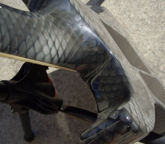

Sure - here's a couple photos. First one shows the horn & how the "scales" don't bunch up; what I'm trying to achive.
Joe

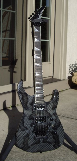

Somes, Joe - 06/22/2009.06:59:10
...and the whole thing.

So that's the factory finish, right? I like that look.
