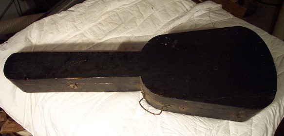

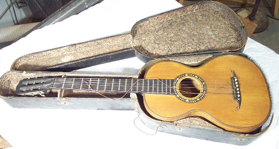

I just got this off of Ebay. The guitar needs some repair, and when I get further along with it, I will post some pictures. The seller thought it was from around 1850, but the guitar is unlabeled. I can't specifically identify the guitar, but if some one has a good idea, I would like to hear about it.
I am showing pictures of the coffin case. It does need some repair.
There have been several discussions about building cases. This might give some ideas.

Closed case.

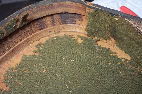

Interior view of the end of the case.

The case has bent wood ends and corners. The neck portion is built separately. The back and top are pine, .3 inch thick.
The sides are thinned at the curves, and are .15 inch at the curved areas. Reinforced areas at the back and the top are placed in the curved areas. The curves around the top of the opening are raised .20 inches, and the top part is recessed to accept that piece of wood. This stabilized the back and top when the case is closed.
The neck is stabilized by the 2 blocks of wood. I am sure a small cover for the box area is missing.
Top and back seem to be simply glued with hide glue. No nails are present.
The case had paper lining the inside of the case, with green coarse fabric, which has deteriorated severely, over the bottom and edges of the body area.
The hinges and handle and lock are simple, but interesting.
If you have other questions ask away.

The guitar looks to be possibly French from well before 1900. I have one very similar, in need of much repair due to neglect and water damage.
