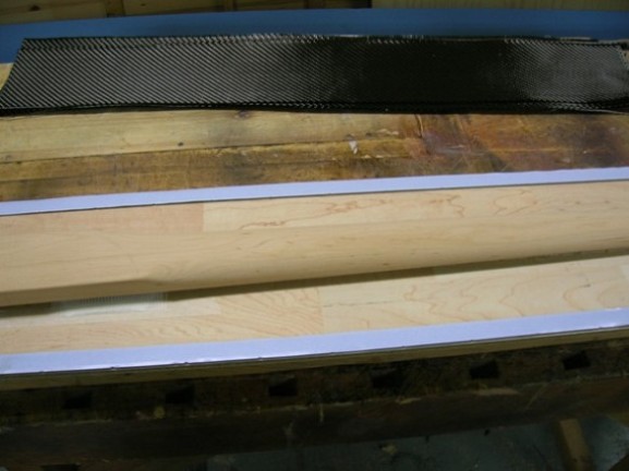

Ursin, Marko - 11/13/2010.08:36:14
Here's a few pics of the neck so far.
Alder core ready for carbon fiber skin.

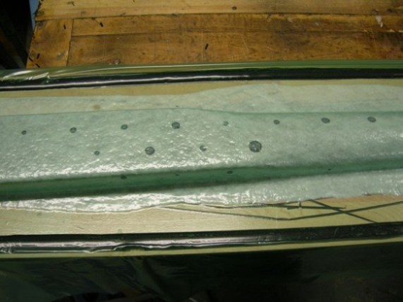

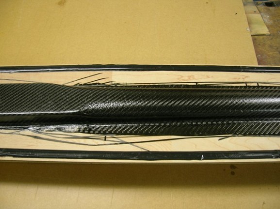

Ursin, Marko - 11/13/2010.08:37:12
In the vacuum bag. The dark spots are epoxy that's coming thru the perforated release film.

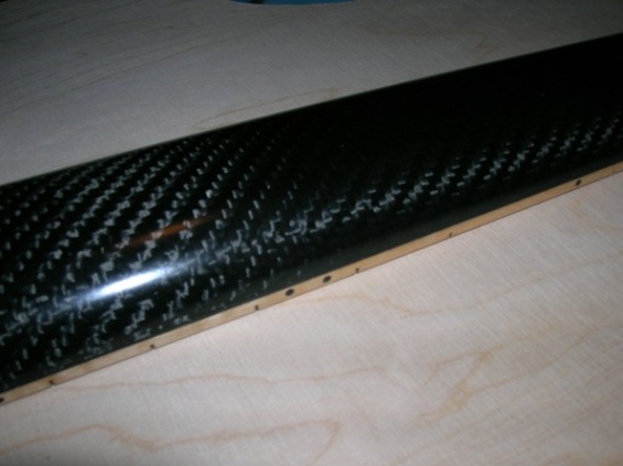

Ursin, Marko - 11/13/2010.08:38:15
After 5 hours curing the vacuum bag is taken off, as are the release film and bleeder cloth. As you can see, the surface is not smooth. I'm hoping to make it smooth by sanding it lightly and brushing one or two coats of epoxy , then final sanding.

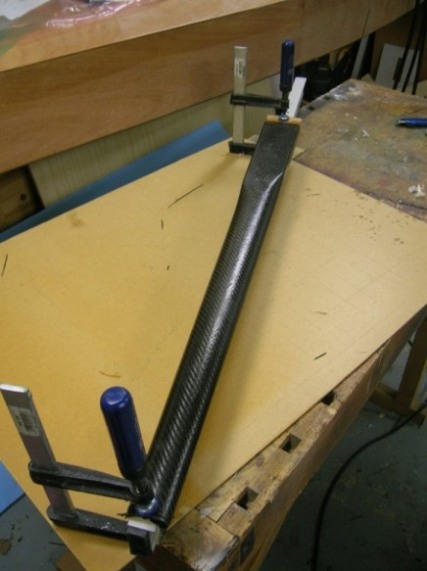

Ursin, Marko - 11/13/2010.08:41:19
The neck is now in the boiler room (35deg C) curing. It's clamped on an aluminium bar to make sure it stays straight. After 24 hours curing I'm going to take the neck to sauna (65deg C) for four hours. No steam during this sauna session! Luckily we Finns have sauna in almost every house.
Marko

I did flex the core before laminating.It sure was easy to bend. I haven't tried it after laminating as the skin is curing at the moment. I hope it is quite a lot stiffer than before the skin. I'll try it tomorrow. I should have made some kind of measuring with some weight hanging on the neck while suspending the heel on the workbench. A little too late for that now.
Marko

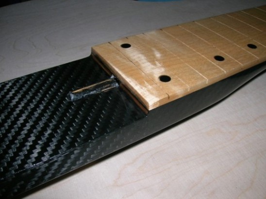

Ursin, Marko - 11/21/2010.06:25:58
I ended up laminating two cf layers between neck and fretboard. I have glued the fretboard and filled the back of the neck with epoxy. Few coats of nitro sprayed to prevent the fretboard getting dirty. The cf skin sure makes the neck stiff. The neck reacts to trussrod very nicely, hopefully also after fretting. I have to make the fret slots a bit on the wide side so that they don't bend the neck to backbow.
Few pics of the neck at the moment. Some touchups with black stain is needed on the trussrod cavity before final coats of nitro.
Ursin, Marko - 11/21/2010.06:26:56
The back looks nice.

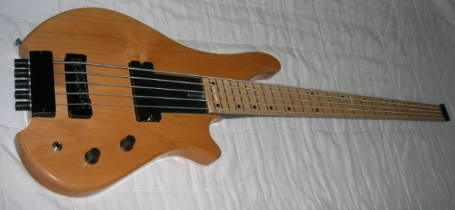

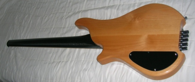

Ursin, Marko - 12/03/2010.14:08:23
The bass is finished. Alder body, brass hardware, 5-coil pickup wired passive vol/tone. The neck reacts nicely to the truss rod. It's a lot stiffer than my Moses Steinberger neck. Feels nice to play, some fine tuning left to do. You can hear a short sound clip at http://maihinnousu.net/s/10077
Ursin, Marko - 12/03/2010.14:10:07
And the front. I'm trying to get a full pic tomorrow morning, it's too dark to get proper pics at the moment.
Marko

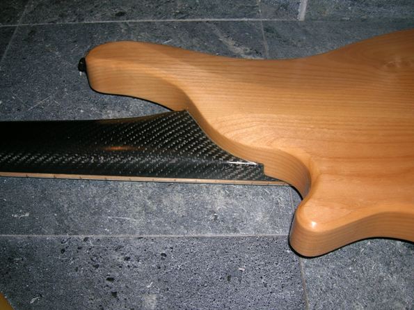

Ursin, Marko - 12/11/2010.06:18:49

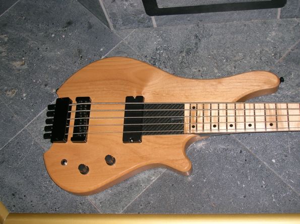

Finally few full pics of the bass. I had to move the bridge a bit closer to the neck to get the intonation spot on. Easy fix, but when the bridge is recessed in a 3mm deep cavity it was not that simple. Had to do some routing and filling as well as respray the body but it looks good now. I tinted the last coats a bit to get a warmer colour to the body.
Marko
Ursin, Marko - 12/11/2010.06:19:33
And the front.
Marko
