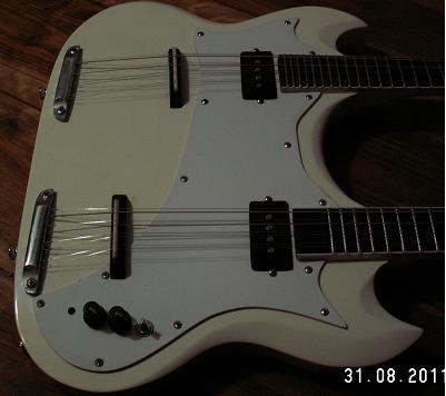

I'm still on this kick of building solid body mandolins. They're fun to build, they're cheaper to build, and they sell quite well into a fairly untapped market. Anyway, somebody at our shop made a crack, "Why don't you build a double neck" -- so I did.
The scale lengths are 14-3/4 at the top and 24-1/2 on the bottom. They are an octave apart. I have no idea what someone would do with something like this but alternative tunings are one suggestion or maybe even using the lower neck for slide.

Wow, what is the combo --mandolin/octave/mandocello? More pics please Mark. That is so cool.
What is the tailpiece? It looks like a TOM keeper.

The body and the neck are mahogany. The pickups are from a Mexican made P-Bass and these work great for a mandolin. The bridges are built to incorporate a piezo with a bone saddle. I build bridges like this by using three layers of 1/8" hardwood -- whatever I have available. This makes it very simple to get and archtop style bridge with a removalble bone saddle and a very good flat-bottomed saddle slot for a piezo pickup.

The tailpieces are from aluminum bar stock from McMasterCarr. The needed ground wire for the strings comes up under each. These are easy to make with little more than a drillpress and an alignment jig of some sort. The easiest and safest way for me to make a path for the ground wire is to use a long 1/4" drillbit and drill a straight line from the strap button position to the pickup route. Because the line is straight, I can easily drill straight down under the tailpiece and intersect the hole. I then plug the opening and install a strap button.

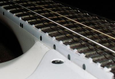

Nibs on the binding of course...

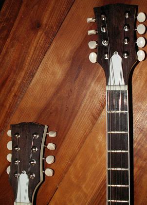

Wybierala, Mark - 08/31/2011.07:51:25
Full Time Instrument Tech
Headstocks

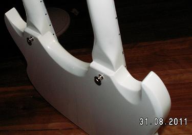

Wybierala, Mark - 08/31/2011.07:53:02
Neck joints

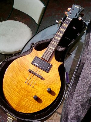

This is super cool! Here's my electric mando, which I too have been thinking alot about lately. This was my first instrument I've built from chunks of wood! Once I get done with my LP Jr, Im onto the next electric mando...no more 4 strings either..Im convinced its kinda pointless...

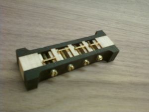

Electric mandos have not been explored enough for the variation in tone! Theres tons of possibilty there...I just want to make the ones that the real skilled guys can play happily, cause my skills arent on the mando! I've just started my prototype maple and ebony "tune-o-matic" for the next one...its a seed of an idea that I think will be purty neat!
Wybierala, Mark - 09/28/2011.00:16:09
That is a beautiful bridge. Alembic makes something sort of related to that. Its a TOM built entirely of bolt together brass and stainless steel and I've taken the opportunity to take a lot of pictures of one up close for the purpose of someday trying my hand at building one. Your use of ebony is inspiring.

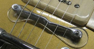

I set out initially to make miniature Les Pauls and the adventure has really taught me a lot about LPs, -the order of construction and other cool stuff that you only get from experience. Solid body mandolins have a sound all their own. Following the Gibson recipe for a solid body guitar, with a set mahogany neck in a solid mahogany body, you get quite a lot of the LP character of extraordinary sustain and an ability to put the string height down unbelievable low to the fretboard -- so much so that many mandolin players don't like it that low. Once you have the instrument, you can tune it any way you like with many different string configurations. I like putting the 3rd and 4th unison pairs as octave apart pairs but there is a valuable tonal result doing it the traditional way too. I really dig your bridge but haven't found fully adjustable intonation needed. Sometimes dissonance is a good thing and you get that with split octaves. With all strings fully unison, the traditional offset works quite adequately. I still like your bridge. On my solid body mandos I typically make a single piece bridge from aluminum bar stock unless I want a piezo.
Here is an example of my first bridge. Its a variation of the original Gibsom bow-tie and its on a '58 Les Paul goldtop. This type of thing is quick and easy to make with a beltsander, a bucket of water and a dremel. I don't seem to have any pictures of the mando bridges but they follow the same idea.
