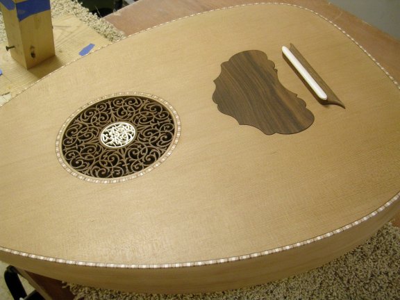

Lute soundboard finishes [Picture] - created 11-05-2006
Abraham, Jameel - 11/05/2006.12:52:31
I know that this discussion has been rehashed, but I thought I would ask for specific finshes and techniques. I know Lundberg uses a wax based finish. My question really is why a wax-based finish vs. shellac. I would think that the shellac would affect the tone less since it dries and becomes brittle, whereas wax always remains soft. I'm building a cedar top oud, and would like to bring some of the color out without a thick film. So I'm debating between FP and Lundberg's technique. I'm leaning toward a very thin FP, perhaps rubbed out to a satin or flat sheen to retain the traditional unfinished look.

Jameel--I ended up using shellac spit coats. Larry Brown had an interesting article somewhere years ago about using a thin sprayed coat of laquer--I think spraying would be a great way to lay on a minimal coat of whatever one is using.

Andres, Thanks for the info. Sounds just about like what I'm shooting for. Care to lay out the process here? I'd love to hear it.

Thanks Andres. Sound like my hvlp gun will be the way to go, especially considering the obstruction the bridge creates, would be difficult to finish around that area. And I hate brushing shellac. I was also thinking of wiping on just a coat or two of Tru oil, just to bring the color and offer a little protection. Application with a very small pad would be very easy. Stuff dries hard, right?
Stephen, I know, I know, it SHOULD be unfinished :-) But I've got to bring a little life to the cedar. The egg tempera sounds tricky.

I ended up doing the burnished shellac spit coat treatment (I think finish is not quite accurate a term). I sanded to 600, then burnished with my baron (everytime I read that word I think of Baron Harkonen--anyone know what I'm talking about?). Followed by two sprayed on coats of 2lb cut shellac. Now the spraying was very very light and "dry", with a very wide fan pattern and very little flow. I literally couldn't see any "wetting" of the surface at all, but I just sprayed until I could detect the color just starting to deepen. Then I stopped. This was the first coat. I waited about 20 minutes and came back and did another coat like this. After waiting about an hour, the surface was dry, but quite rough since the spray was dry. A quick going over lightly with the baron (not Harkonen)took it back to smooth. One more coat and then another burnishing and it was done. Very smooth, darkened satisfactorily to bring some life to the cedar, and just a hint (and I mean a hint) of sheen. Exactly what I was hoping for. Thanks everybody for some great info!!
Terenyi, Yuri - 12/02/2006.23:47:54
You shouldn't fool with the baron Harkonen. It's dangerous. And even the Guild might be after yo, you know... Whichever guild you like, just to anticipate the question. I think you should start thinking o0f the baron Munchausen in the future, he is more benign.
Terenyi, Yuri - 12/02/2006.23:48:55
By the way, I forgot, the oud looks terrific.

That looks great - like there's nothing there at all.
