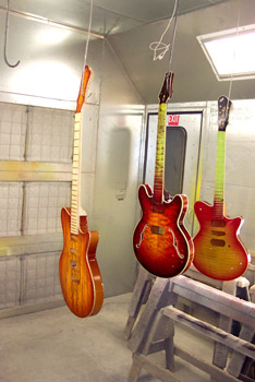

After GOOD results on 4 guitars with water-based lacquer, I'm ready to get EXCELLENT results!. I really think that nitro is the way to go. I find that KTM-9 or Oxford water-based lacquer always stay a little soft and polish out ok, but not like a guitar finished with nitro. My problem is, I work in 1/4 of my garage. I can't build a dedicated spray booth, and even if I could, I don't want to spend the money for explosion-proof fans and lights (which in my preliminary searches looked like I could spend $600-$800 easily). I can't believe that everyone here that talks about using nitro has a fancy booth with all the explosion-proof equipment - but I might be wrong. Please tell me your setup for shooting nitro.

I worked at a shop where the "booth" was a room in the back with a fan in the window. I believe they put it in in the mid 60's and still use this today! I painted lots of guitars in that room.
When I moved to Portland I looked for a repair job just so I could have access to the paint booth! It has always been a struggle with lacquer. But there is nothing like it.
My current situation is the best I have ever had. It is so nice to have good lighting, ventalation, climate control, safety, etc. I hope never to have to do it in the garage, or out the back door again! The finish is so important. It is the first thing you see, it is the thing you touch. When I build my next shop, I will build the install a proper booth, and then build the shop around it.
check out how lucky I am!
