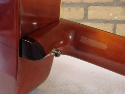

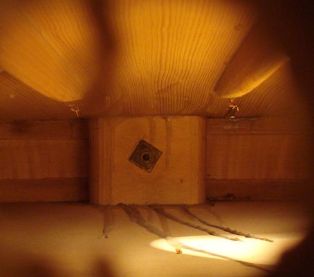

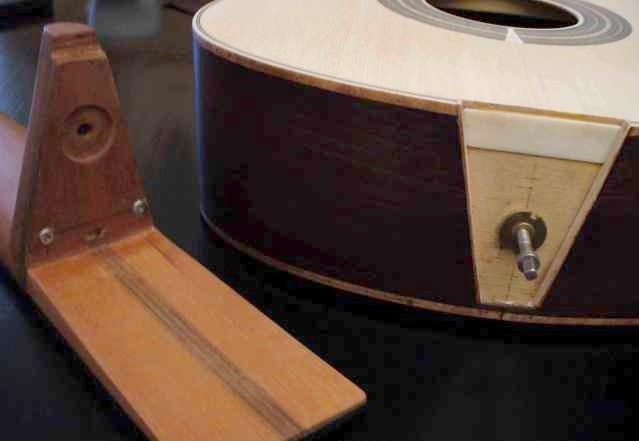

Alain, looking at your photo, do I assume the 2 small metal plates will leave an impression on the white tape - to make it easier to fit the cones? Would one would then remove the white tape?
Bieber, Alain - 09/25/2008.11:28:42
Hi Murray,
It is a basically sound and extremely foolproof idea... thousands and thousands of guitars like that by gentlemen all over Central and Eastern Europe.
Now, coming to my personal treatment of this old idea. The two "metal plates" are two small Phillips screws heads. I screw them until their head stick to the hardwood plated and reinforced heel. I stick them with a pearl of epoxy (or even Titebond) while screwing. Then I file a little their heads and realize the alignment of the neck by the same token.
The white tape is in fact a piece of bone 1.5 mm thick. The contact "steel against bone" or "brass against bone" is what I felt was acoustically the best after many trials. But wood on wood (hardwoods) works quite well too, as for original Stauffers. I have built two dozens of guitars like that. Until now, no problema.
A very old trick, known since the Viennese vogue of such guitars, is to add a shim of hardwood close to the bottom of the heel and bolt strongly at the end... so that your neck, once well aligned, becomes as hyperstatic as a Spanish neck.
This design has many advantages for those who want to experiment a lot, as maybe you are. I appreciated much to be able to test a serie of different boxes with a limited number of necks. I feel neck building is really time consuming. Plus the fact that changing a soundboard is really easy with that basic design too.

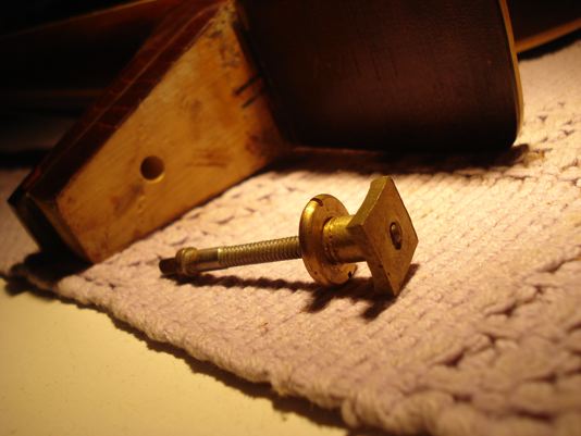

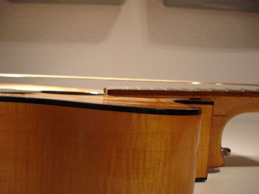

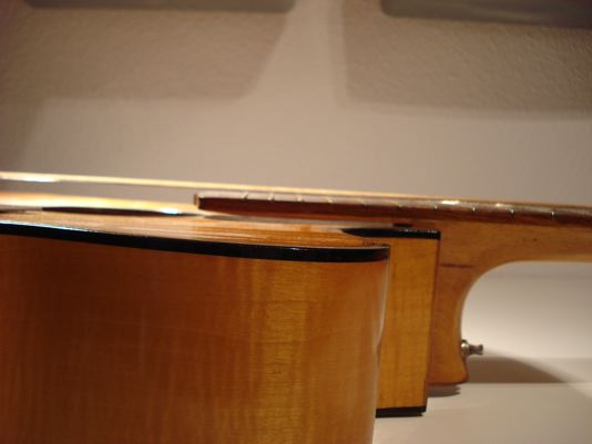

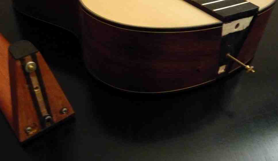

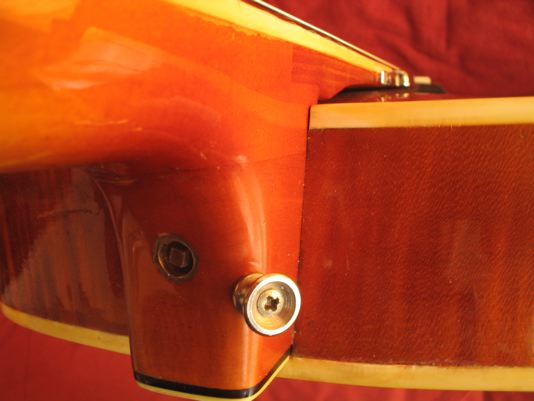

Jimenez, Paco - 10/08/2008.02:48:02
Here we go.
The whole system
Jimenez, Paco - 10/08/2008.02:48:52

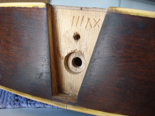

The neck pocket

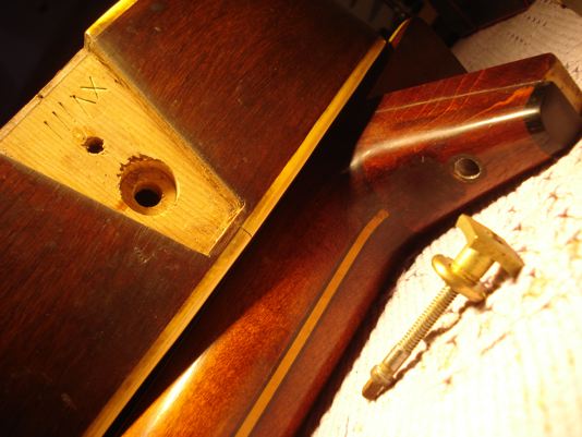

Jimenez, Paco - 10/08/2008.02:49:41
Neck pocket with the stuff installed
Jimenez, Paco - 10/08/2008.02:52:45
This a full view of the "halschreuben" and the front face of the neck. Notice that the squared nut has it's four tips curved to to get anchored against the neck block. Squared nut can be susbtituted by modern T-nuts
Jimenez, Paco - 10/08/2008.02:55:04
This is a inside view showing how the squared nut is tightly attached against the neck block.
Jimenez, Paco - 10/08/2008.03:01:00
The system assembled and working
Jimenez, Paco - 10/08/2008.03:07:40
Now you can go from here
Jimenez, Paco - 10/08/2008.03:08:12
...to here taking less tan a turn of the bolt.

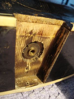

Jimenez, Paco - 10/08/2008.03:11:20
These last two pics are from an Otwin Guitar. Otwin used their own bolts driven with any small rod instead of the traditional and specialized squred clock-key. If you lose the proper clock-key you are lost! Not with Otwins. That bolt end works as a strap pin as well.
Most modern makers using the Stauffer system use Hex keys instead of squared.
Jimenez, Paco - 10/08/2008.03:24:56
All those pics I've posted belong to old systems made in the '50s and '60s. All of them need a shim in the upper part of the neck block to make the system work right. In the old days they were always made of wood. Currently, many builders like Sobell, Forster or Beardsell use harder shims like the bone one showed by Alain (in the picture in #14 post) and a couple of steel or brass rods embedded in the neck end to improve stability, support and tone transmission.
Jimenez, Paco - 10/08/2008.03:58:08

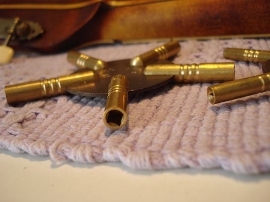

Jimenez, Paco - 10/08/2008.04:15:03
Thanks Alain.

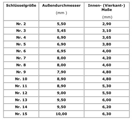

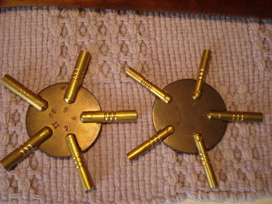

In the old days every builder used the typical squared clock-key to drive "halschreuben". These keys are not easy to get lost along the years and they were used in different sizes. Here's a chart of the clock-key numbers just in case anyone has to deal with old european guitars
Jimenez, Paco - 10/08/2008.04:16:52
And here is a set of useful multiple keys suited for any of those old guitars "halschreuben".
Jimenez, Paco - 10/08/2008.04:17:23

Ingram, Douglas - 10/08/2008.07:41:43
Yes, thanks for the great pictures!
Alan Beardsell lives very close to me, I gotta go meet him one of these days. Very interesting work, though I didn't see anything about an adjustable neck on his website. Maybe I missed it?
Ingram, Douglas - 10/08/2008.09:05:06
OK, upon closer inspection, and you have to look closely for it, he calls it "tilt control".
Runesson, Tyko - 10/08/2008.19:28:28
Runessonguitars
Thanks very much for all the pictures, now I got a grip of it!
I have big lust to try it out right now.....maybe on the 12-string Nashville tuned (just the octave strings from a 12 string set two times) guitar I am currently building.
Anyone who do their one variations of it? It must work with a normal T-nut and some nice bolt I guess.
I just realize that if you are doubtful about the system it is easy to double up with a hanger bolt above to lock it with if you don´t want to change it to often.
Jimenez, Paco - 10/09/2008.02:15:14
-"It must work with a normal T-nut and some nice bolt I guess."
Sure it will work. The original Halschreuben has a brass (or steel) piece which is secured to the neck block with the round nut shown in the pictures. It has a threaded channel to screw the bolt to it and not directly to the nut. But the Otwin system comprises only a bolt and a nut, so the bolt is screwed directly to the nut. In my experience it works the same. I find no difference. The only drawback of the simpler system is that the nut can easily fell off inside the soundbox when removing the bolt. This doesn't happen with the mentioned brass piece. This is not really a problem in round hole guitars, but could be a mess for F-hole archtops to get the nut again in place. In this case, the original system with the anchored brass piece would be advisable.
-"it is easy to double up with a hanger bolt above to lock it with if you don´t want to change it to often."
Yes, but it's not needed. It doesn't move and there's no need to move it often. Once you get the desired action just forget it. It's only needed to check (and sometimes readjust) the action if you remove all the strings at a time. For this system is advisable changing the string one from one. Remember that this is an isostatic system. If you remove all the strings tension the neck is loose. Necks are left loose on purpose. As I said before, this system is not a static joint like most guitars have (glued or screwed). It is an isostatic system, the strings tension holds the neck in place tight enough. The bolt without strings tension does nothing but holding the neck in place and ready to go. The trick here is placing the neck into the pocket and turn the bolt until it holds the neck's front face slightly touching the neck block face inside the pocket. The neck is loose but don't go further for now. Put the strings and tune the guitar normally. Now check the action. It's probably a bit too high... or quite high. This is the time to turn the bolt again to get the action we like. As we turn the bolt the neck tilts backwards getting the fretboard closer to the strings. It's that easy.

Netel, Jacob - 11/21/2008.03:14:35
Excuse me for my ignorance. I really looked on the web first.
How do I find the contact details for Rubner?
I am very interested in their bolts for my next projects.
Thanks,
Jacob
Bieber, Alain - 11/21/2008.07:00:15
Google on Thomas Rubner GMBH Markneukirchen. Nice family but they are not much accustomed to have customers so far away from the German/ Tchequia border. Speak slowly if not in German .
