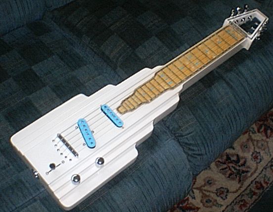

Pat, I used frets because I like the look and figured it would have been faster then making wood strips and inlaying them. I machined my own nuts and saddle from brass and had them nickel chrome plated. They are 3/8" tall and the design is a take off of Charlie's MIMF plan. It's your guitar so do what you want with it. Have Fun!
Paulick, Chris - 02/21/2009.20:42:34
Here's a closer and clearer pic of the body and partial fret board.

Chris: That is REALLY pretty. I really like how it all works with itself, especially the blue pickups. Nice work! The body shape reminds me of an old Epiphone Electar that I used to have. Very art deco. Really nice instrument.
Paulick, Chris - 02/22/2009.13:24:32
Thanks Will, the pup toppers are turquoise recon stone as are the dots. Swamp Ash body with maple board. I also wound the pups. It's of the tele family. I tried to carry the step theme through out it. Hard to tell but the saddle and nut have steps milled into them as is the side profile of the head. I was happy with the outcome as it kind of just evolved. That always seems to happen with my builds so far. I kind of know where I'm headed but see things on the way if you know what I mean. Oh yeah, When I posted pic of it awhile back we discovered that the body shape also somewhat resembles some old Nationals, I think the New Yorker or something like that. But like I said it started out with Charlie's plans sold here at MIMF. Maybe one of these days I'll build an 8 string and get a palm bender and get a peddle lap steel sound going.

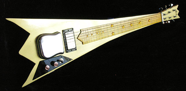

Here's a scrap chunk of lumber, some tele parts and other grab box of parts guitar sprayed with some rattle can gold spray paint.
Paulick, Chris - 02/22/2009.15:42:25
Cool! You even had an ash tray cover in the box. Just the humbucker or is there a bridge pup under there? I see the switch but don't know if you are splitting the hum coils.
Dotson, Mike - 02/22/2009.16:13:14
I love that one Ellie, it looks like a Klingon weapon!

Erickson, Ellie - 02/22/2009.16:15:19
Nope, no coil split, but there is a home wound tele pickup under the ashtray.
I love the way the ashtray covers look, but don't like using them unless they're on a lap steel.
