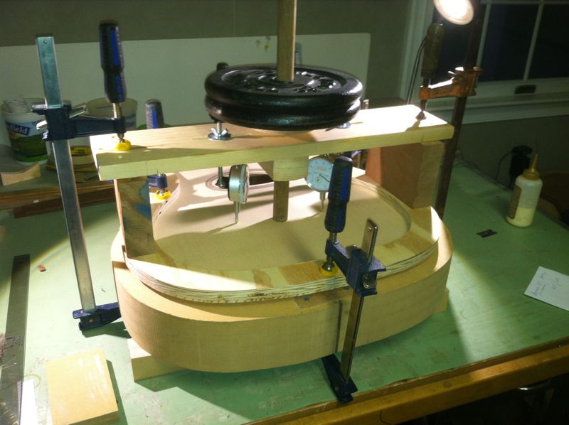

I too have had little luck with tap tuning even though I am a tappin' fool and tap everything constantly during construction. Having built less than "100 guitars" though, I too have had a hard time drawing firm conclusions.
I read Mr. Smirnoff's book but have not tried his method of tuning parts to notes. That just seems off base in many ways, to me at least. What I did take away from his book however was the idea of deflection testing and THAT has been helpful. The way I use is to apply a weight roughly equal to the downward force of the strings on the bridge (20 lbs in the case of the Selmer style I build with an unglued bridge and tailpiece like an archtop) and measure the deflection. Over the last year, I've tested not only my own guitars during construction and upon completion, but also any other guitar I can get my hands on and permission to test.
Most recently, I finished a replica of a Castellucia D hole Selmer style guitar (acoustic, steel string) from the 1950s which I have the good fortune to play beside a couple nights a week. The original is a terrific sounding instrument with a very unique sound. Very loud and can cut through anything acoustically, very important in a 4-5 piece acoustic swing jazz group. Getting the physical characteristics are fairly easy but capturing the tone is, of course, much more subjective. I dimensioned the top and braces (as well as everything else) exactly like the original, BUT when I deflection tested it after gluing it to the rims, it had a good 40% less deflection, that is stiffer, than the Castellucia top. This clearly would not do so I thinned the braces (I had not yet installed the back) and the top until my deflection matched the original (.038" under a 20 lb load). Once completed, it sounds very, very close to the original. The combination of copying the physical characteristics AND the deflection testing where in my opinion a large part of the success.
Deflection testing measures the whole assembled top (or back) and a certain amount of common sense needs to be applied. There are lots of ways of getting the same deflection number. Imagine sides that were highly flexible and a 1/4" plate steel top for instance. You could still get .040" deflection out of that, but clearly would not have the same sound (if any). So deflection testing is not the complete story, but it does help me fine tune. If a top is the sum of its parts then testing the sum in some way should be helpful in understanding how the top will respond to input.
Some day, I'd really like to get my head wrapped around Alan Carruth's plate tuning with generated tones and node patterns.
Then of course there is Ervin Somogyi's tap tuning class ($5K + expenses, whew....).
Here is a picture of my little test rig, be it so humble. The plywood rim around the edge of the top is used on an unglued top to clamp it to the rims during testing in lieu of gluing. I have a couple different leg support options for the plank that supports the dial indicators which allows me to check sides and plates in the mold or completed instruments supported firmly. BTW, if you use this gig idea, be VERY careful with the weights. A ten pound weight dropped from 1 foot on a guitar top will pretty much ruin your day. Also, be sure to clamp down well as the weights destabilize the jig when applied.

Craig, do you just test deflection at the bridge, or elsewhere on the top? David Hurd's "Left Brain Lutherie" method is about testing deflection all over the lower bout in a grid-like fashion. It would be interesting to know if you could get a little closer to that exemplary grand bouche by checking out the deflections in just a few other locations around the bridge (maybe 12 o'clock, 2, 4, 6, 8, and 10; or 2" in front and back of the bridge, plus under the bass and treble feet, etc.) without doing the super-thorough mapping that Hurd does.

Craig, when you tested the deflection on the original Castellucia, did you remove/loosen the strings?

Jason: I just test the bridge area, but surely testing elsewhere would be interesting. I've not seen David Hurd's book, so can't comment on his approach beyond saying it sounds like a good idea. It also sounds complicated, especially in the the adjustment of a new top. I should think every adjustment to a specific area would have implications elsewhere, so a full round of tests would be needed with each adjustment. For my purposes, I think I'm okay with testing just the bridge area for now. I could see adding a few areas and might do so at some point, but to date have. I might think differently on a guitar with a fixed bridge / string terminus like a classical or standard flattop.
Andrew: I test without the strings tensioned and the bridge removed. In the guitars I work on, the bridge is not glued down. When I apply weight to the top in the bridge area, what I'm trying to duplicate is the downward pressure of the strings on the bridge. In the guitars I work with, this works out to about 20-25 pounds. So, without strings and bridge, I apply 20 pounds in the bridge area and measure the deflection. I then strive to duplicate this when I build a new one. I find it is not difficult to build to a deflection of +/- .001".
