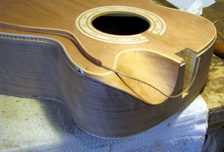

Here's a picture of one I'm working on now. The binding butts into the cutaway with an angled surface. I've stripped the side purfling loose from the binding and bent it around to follow the edge of the cutaway.
There was a tread on another group a while ago debating precedence on this feature: every time somebody made a claim for it an earlier example was cited. This is pretty common in lutherie: not to take away from anybody's originality, but it often seems to be the case that several folks come up with an idea at about the same time. Somebody was certainly the first, but it's difficult to say who: we all know about fanned frets, and the 'Manzer wedge' was patented by Smith in 1969 or so. I will say that I have not seen any _recurved_ bevel cutaways before mine, but that doesn't mean there were not any.

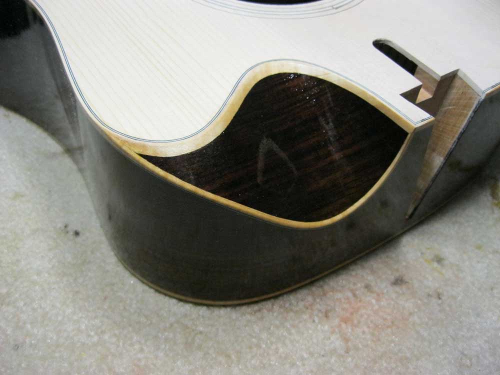

I had a customer order a cutaway dreadnaught, and I saw that picture from Alan, so I emailed the pic to the customer. Of coarse he liked the idea, so armed with one picture from the internet(!), I put in some head-scratching time, and after a styrofoam model or two, came up with this. I'm applying sealer to the rosewood at the time of this picture, no finish yet and still some work to do to clean it up some, but here it is. Not as easy as it looks!

That is some fine woodwork there, Alan. Some of those bends look mighty tricky. And very nice work recreating the feature, John, from a single picture.
This style of cutaway presents some interesting opportunities. Of course, as Alan mentioned, there is the savings on box volume, and also upper bout strength, but I see this area having potential as a new canvas for the builder's imagination. Continuing the side wood in the cutout maintains continuity, but the first time I saw this type of cutout I thought of a bite out of an apple: contrasting woods that match the headstock overlay or fretboard/bridge wood in keeping with a theme. Though the surface geometry is complicated, this could be a surface for inlay or an alternative location for the maker's mark. And since folks are putting additional sound ports everywhere, why not some decorative cutouts or designs that connect with the rosette or fingerboard appointments. The possibilities are endless!

If you bend the wood for the cutaway at a 45 degree angle to the grain it will flow into the grain of the binding. OTOH, doing it the way you did makes the cut a part of the side, which is bound on both sides. As Jason says, this thing has a lot of possibilities. I would be careful about making a 'port' in it, though. It would work pretty well, but would no doubt also infringe on Thurman's 'Multidimensional Sound Port' patent.
