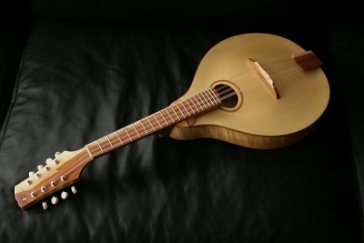

Fruit woods can work well for fingerboards, at least they have a long track record for traditional instruments such as Hardanger fiddle over here. I've used pear wood for mando family instruments a few times, and it seems to hold up fine. Its quite dense, close pored and stable, but it doesn't look at all like ebony or rosewood, of course. I think its pretty interesting in its own right, though. I assume some of your local fruit tree woods are similar. Here's a picture of my MIMF $100 challenge from a couple of years ago, with a two-tone pear fingerboard (and appointments)
