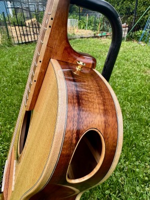

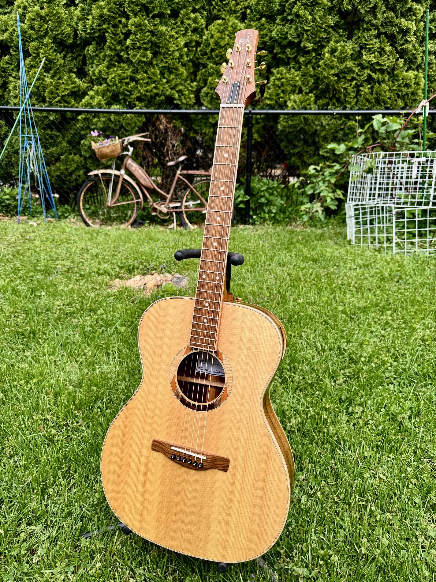

Hi, all.
I have finished my fifth guitar. I feel like I'm making some progress and this one might be getting closer. This is a left-handed guitar and it's my first that will be heading to another home. Fortunately, the new owner is my brother-in-law so I can keep track of it over time. It's weird making a left-hander, I can't play it at all. I tried to finger some chords and I have new empathy for beginners now. That was really hard.

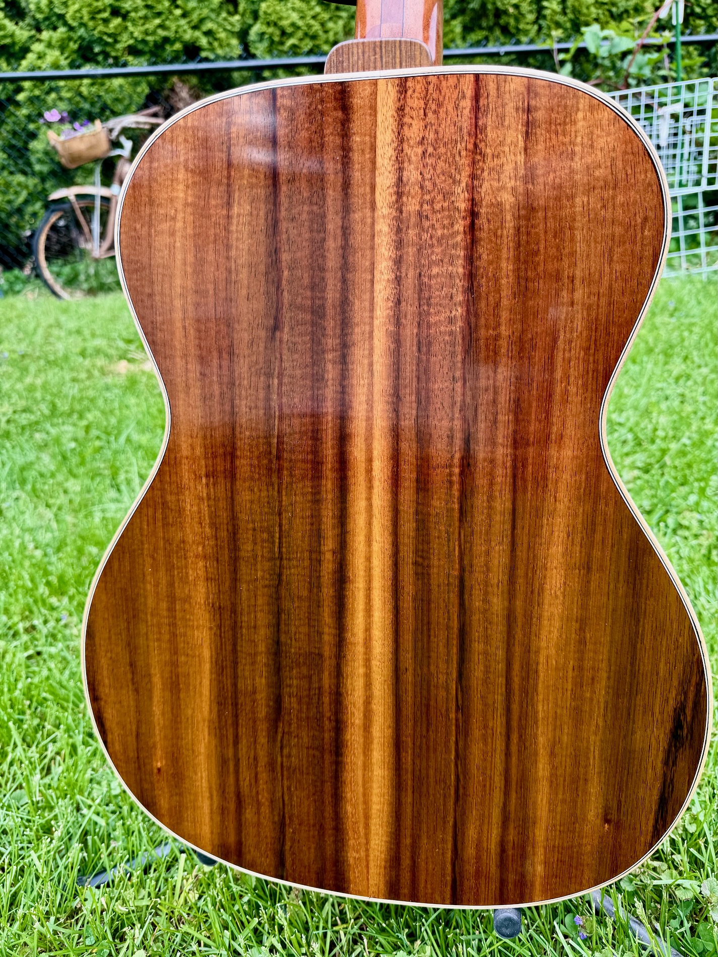

The back and sides are Koa. It's not top grade but any Koa seems wonderful. This was a piece given to me by a friend from a board he couldn't use on furniture.
The top is Sitka spruce from a board I got around 1982. It was a reject from a boat builder, 10" wide and 10' long. I smiled and said I'd take it off his hands.
The binding is maple.

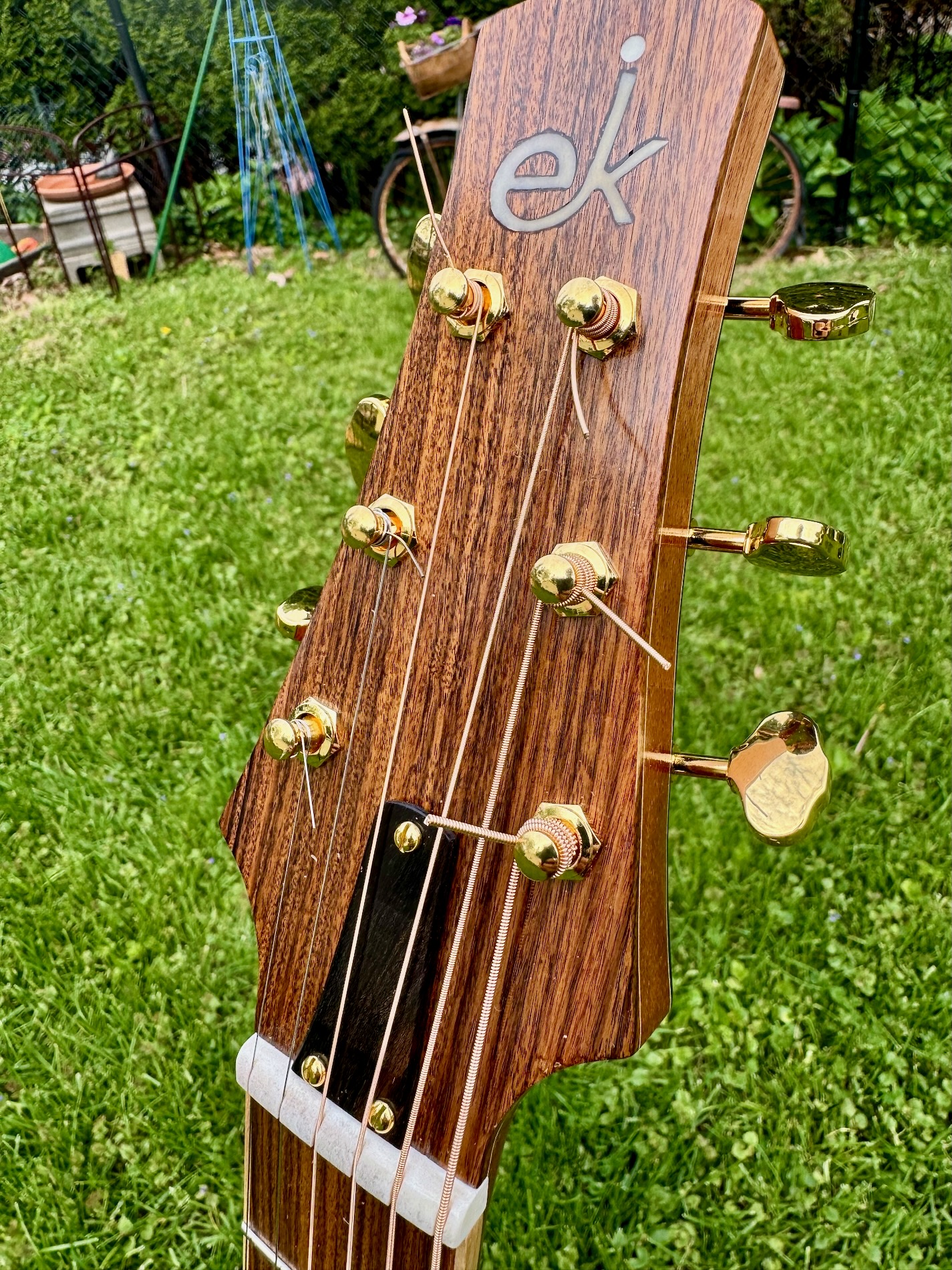

The headstock veneer, fretboard, and bridge are rosewood from the same board.
I'm still enjoying this and I'm on to #6.

Wow, beautiful guitar! I see a lot of really custom features, side port, elevated fretboard, beautiful binding. Really nice work, congratulations! Are you happy with the sound? Does the elevated fretboard make a big sound difference?

Christ Kacoyannakis wrote: Wed May 28, 2025 11:01 am Wow, beautiful guitar! I see a lot of really custom features, side port, elevated fretboard, beautiful binding. Really nice work, congratulations! Are you happy with the sound? Does the elevated fretboard make a big sound difference?
Thanks, Christ. I think the sound is very good but I don't have any references from other makers to compare with. I had a maker/repair person comment that the elevated fretboard makes the guitar sound a little more like an archtop. I see what he meant but it still mostly sounds like a normal acoustic flattop to me.

Oh, btw, the nut and saddle are from a moose antler. A local pet store had some that were cut up and not whole. That let me see the ones that were solid with no pithy sections.
