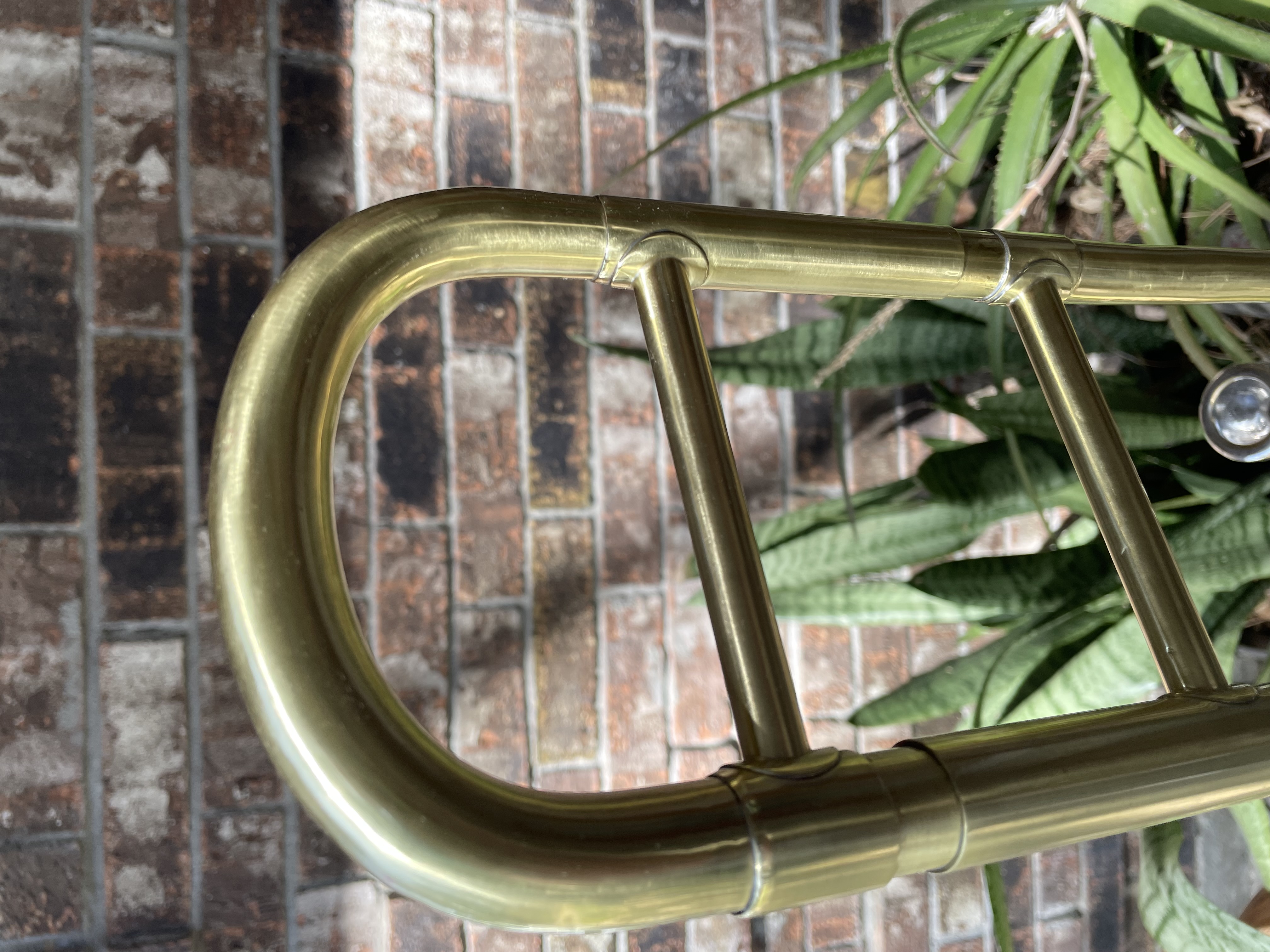

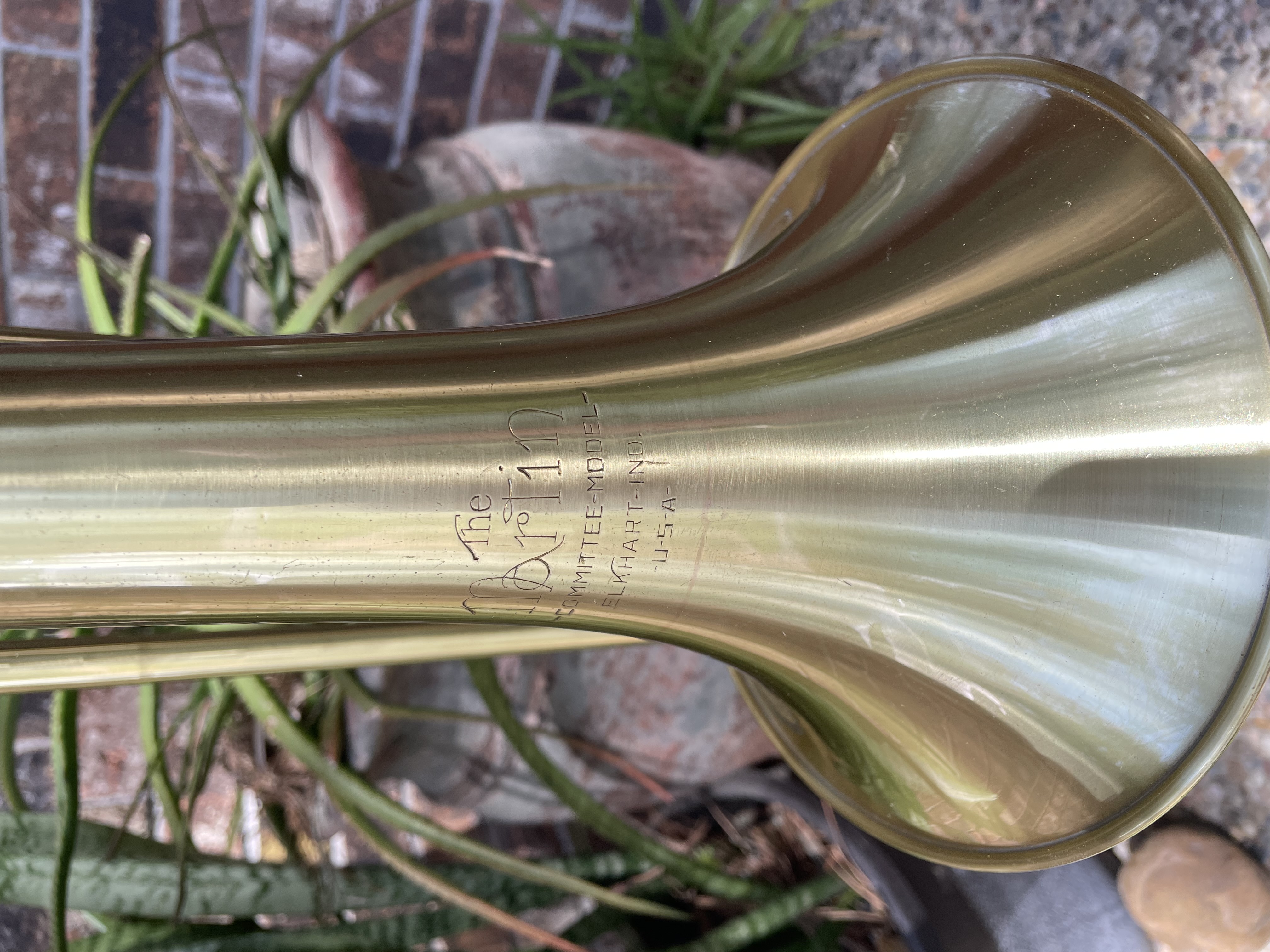

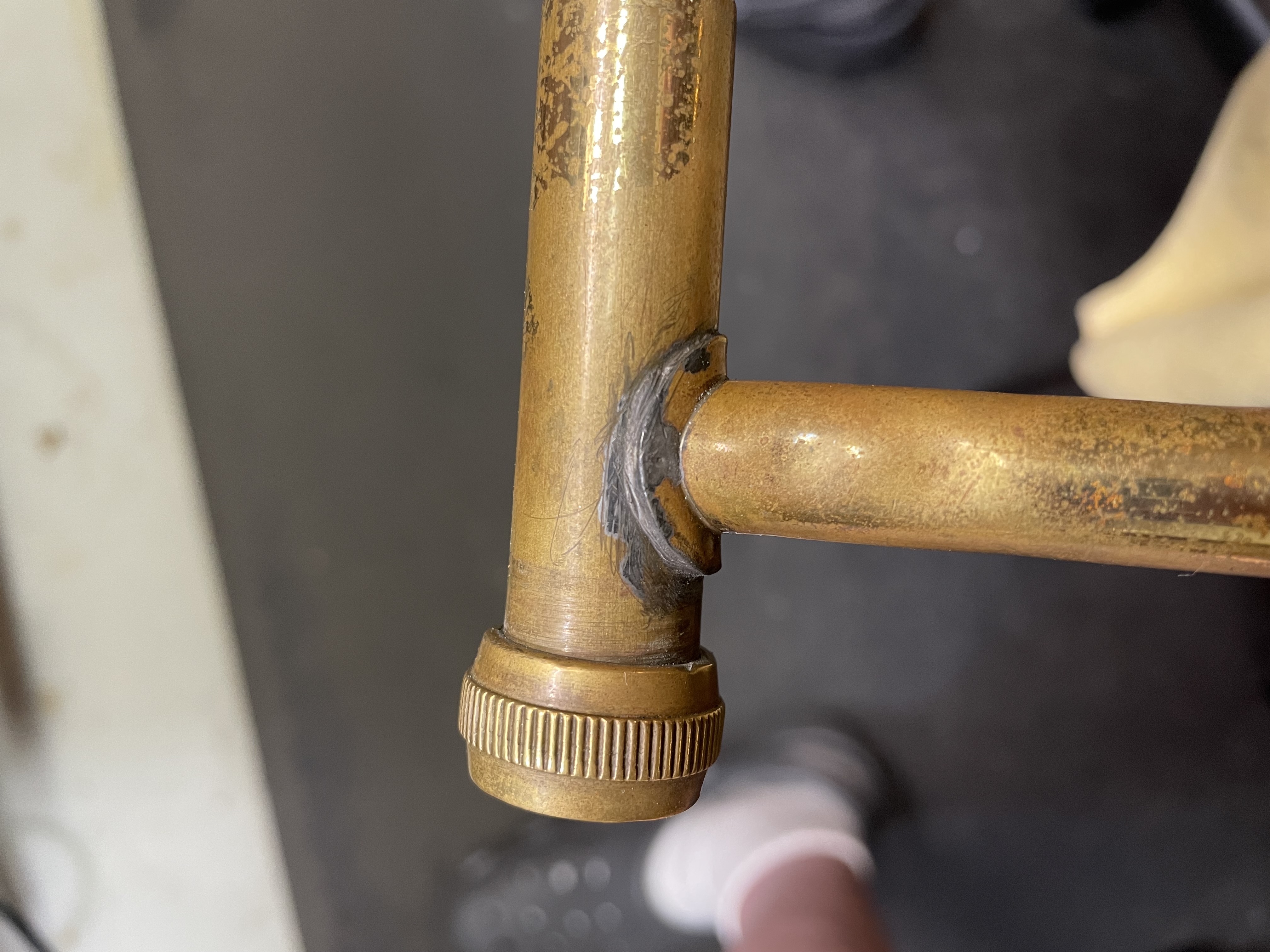

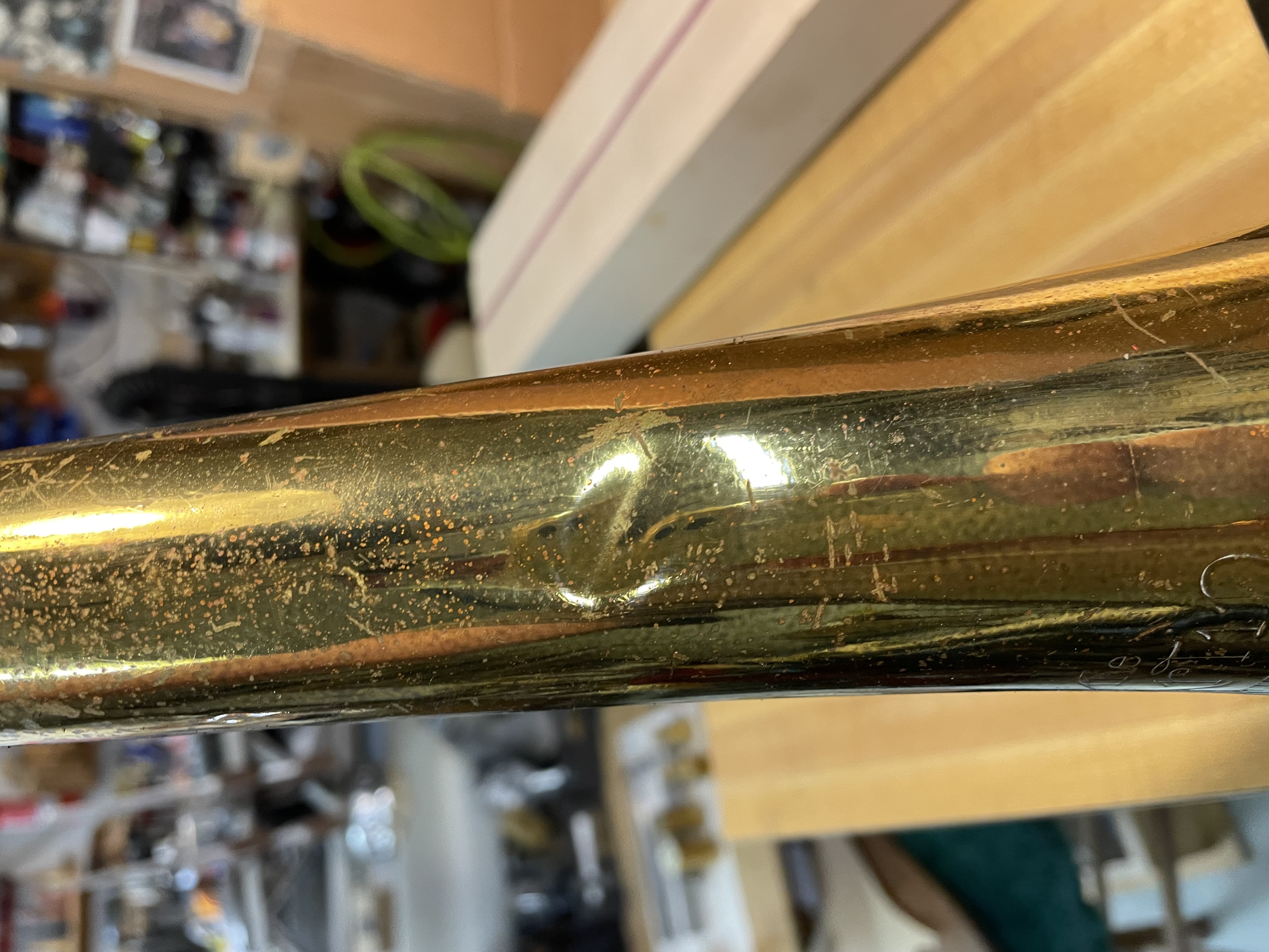

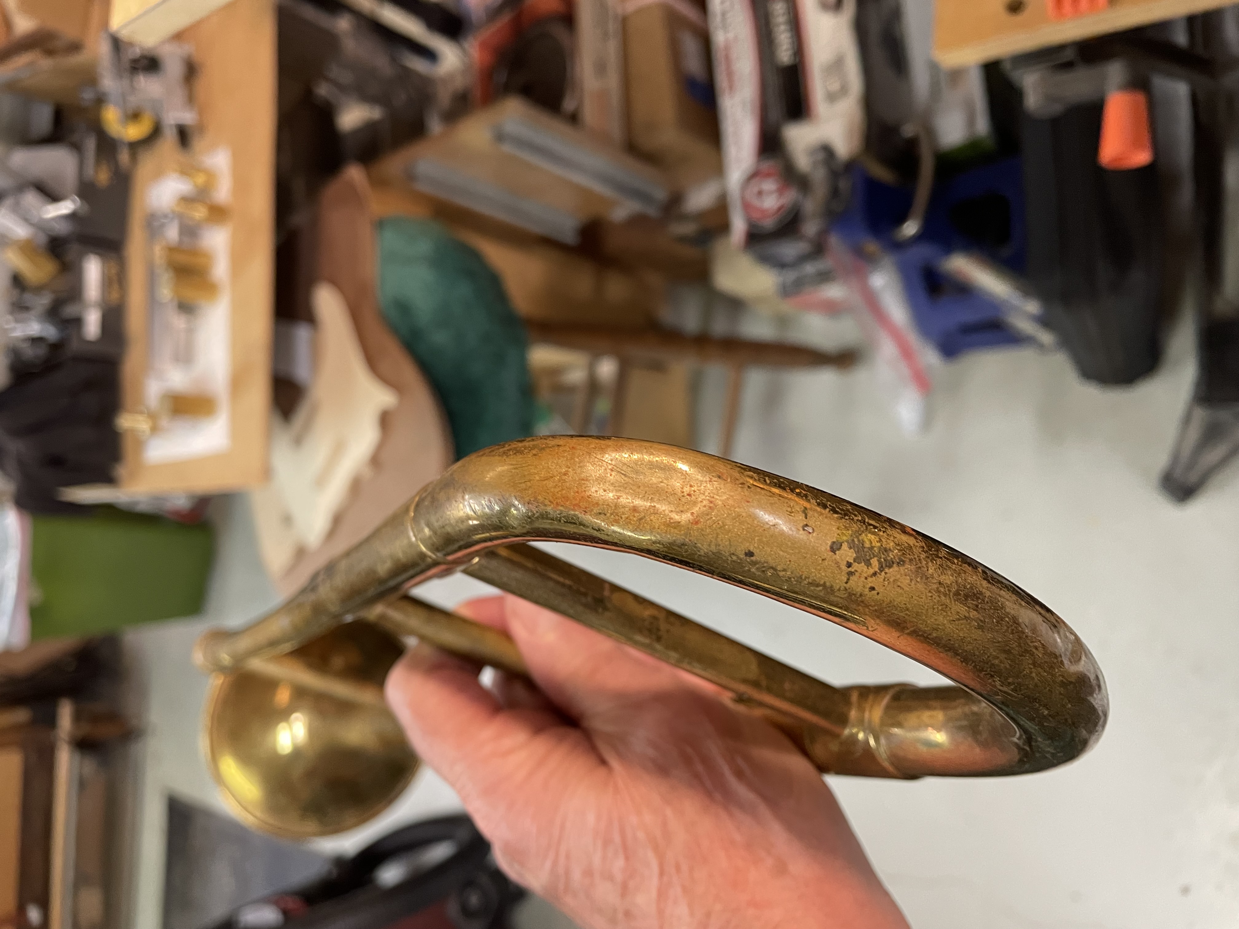

About a year ago I started playing the trombone again after a layoff of 53 years. I am in a community band and also a small jazz band. Really enjoying it. And of course, as soon as I started playing I had to start repairing them. It was like I had no choice in the matter. But there is a lot of new techniques to learn and new tools to acquire. Here is a recent project. A 100 year old Martin Committee (no relation) trombone. Lots of dents to remove and parts to be realigned. I basically took every joint apart. Also sanded and buffed all surfaces and did a satin brush surface with a very thin coat of nitro lacquer. Here are "before” pictures.

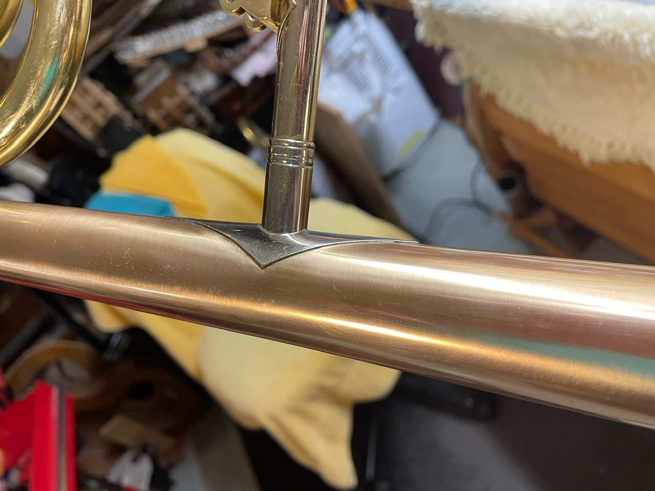

Here are some “afters”.

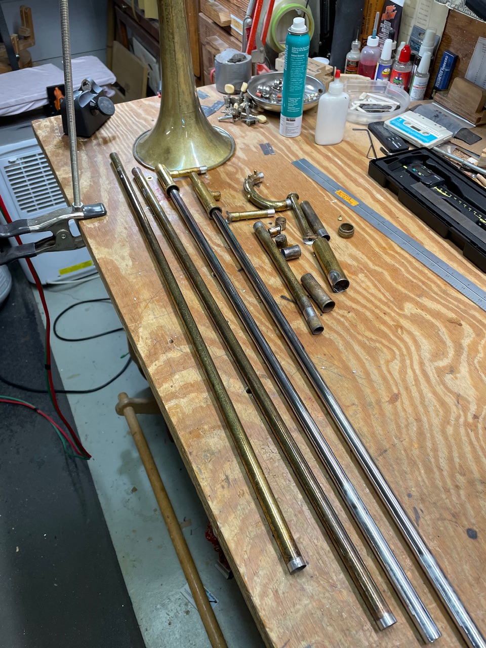

One more pic of finished horn and also one in progress photo showing parts after disassembly. One thing that is cool about brass instrument work is you can quickly take things apart and solder them back together quickly and as many times as you want.

Why stop here. This is my daily player. A Holton TR-150. Got the same treatment as the others. It’s got a rose-brass bell. One of the coolest things is that a brass instrument only needs one coat of lacquer and no post sanding of buffing. Who needs pore filler? Not me.

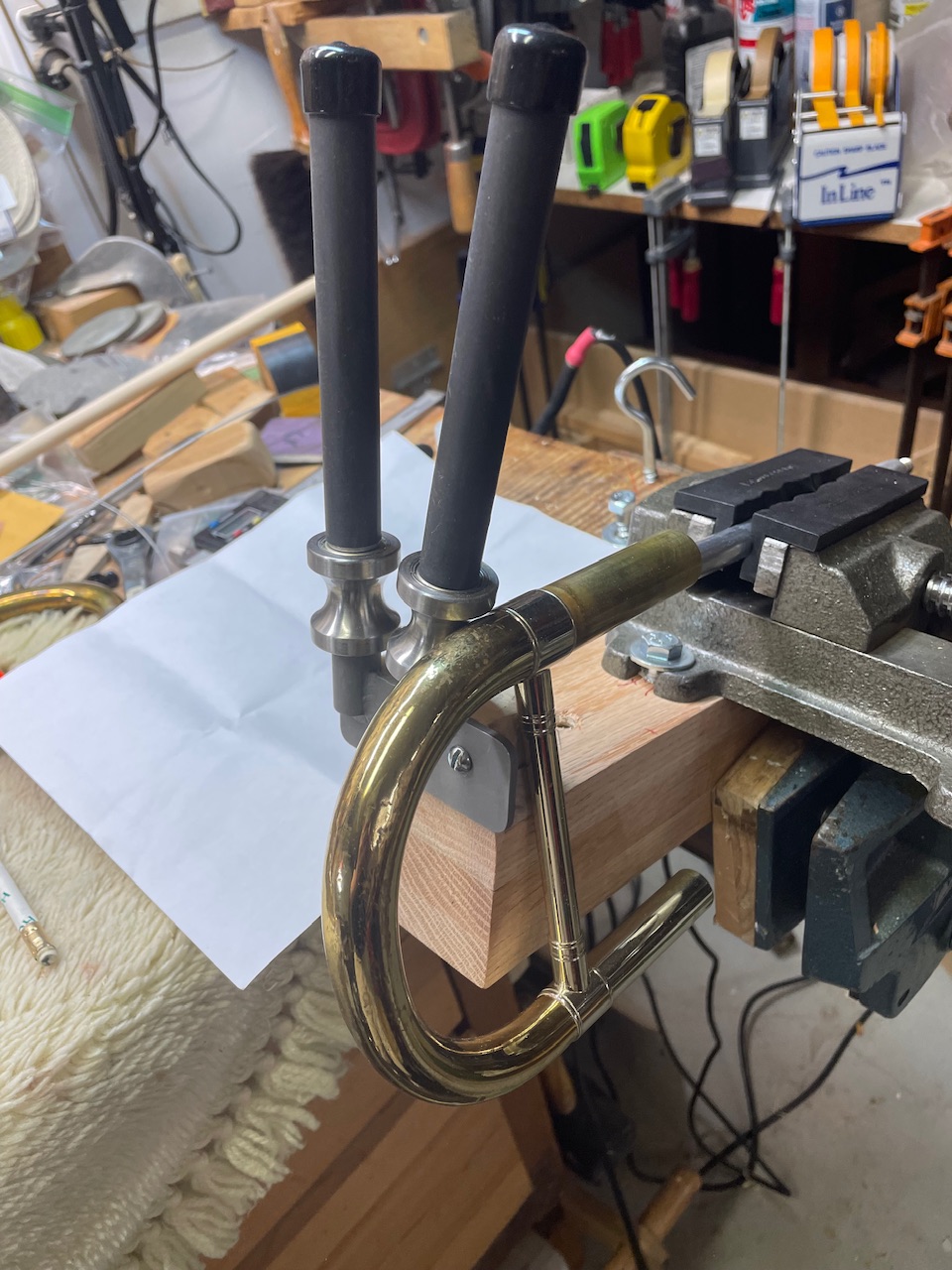

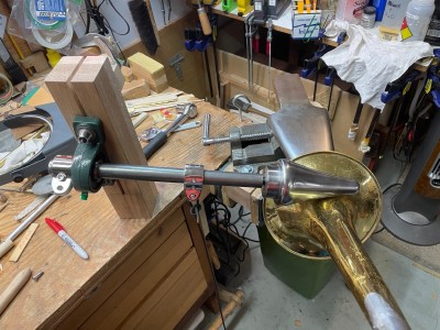

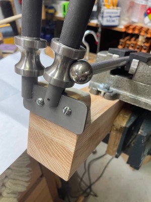

Karl, if you are interested in repair work check out Ferree’s Tools Inc. They are the Stew Mac of band instrument repair. Here are a few pics of some dent removal. I DIY’d my own version of Ferree’s dent machine. One of the basic principles of dent removal is you can push a dent out from the inside with only a single tool on the inside. But when pushing outee dents from the outside you have to have a rod or some other tool on the inside to press against.
