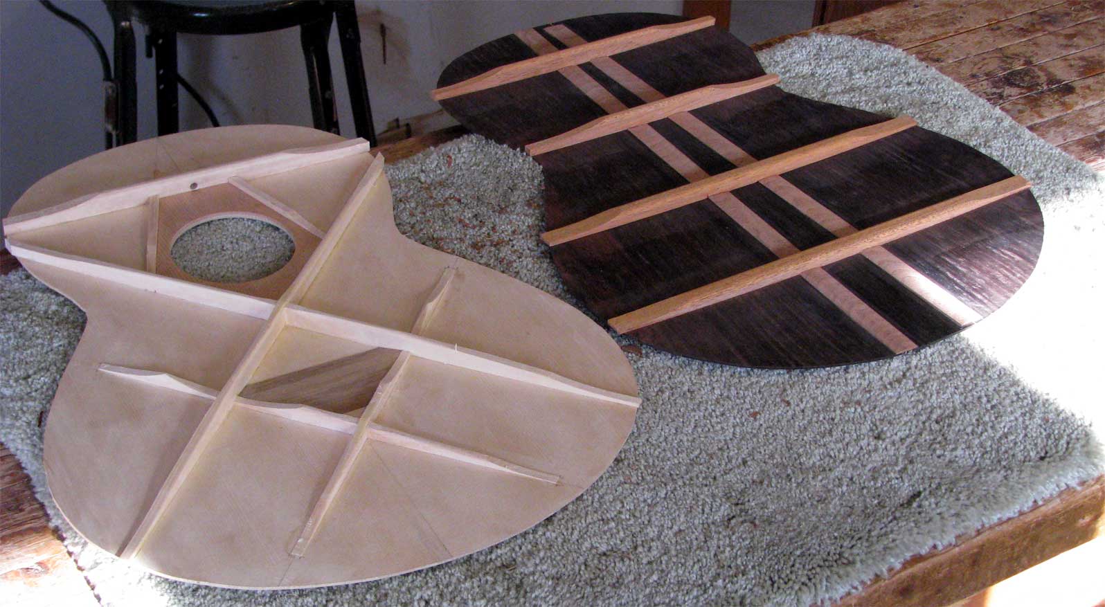

I've been using double-X bracing for years. Here's a shot of the initial trim of the top and back for a 12-fret 000 in BRW and Red spruce. This was intended as a 'fingerstyle' guitar; hence the 'tapered' bracing profile. I've also made them with a 'scalloped' braces for flat picking. I find the double-X to be a lot easier to 'tune', either by 'tap tones' or using Chladni patterns.
When I thought about using this setup I made an 'almost matched' pair of guitars: one with 'regular' asymmetric bracing a la Martin, and one with the double-X. I took them to a luthier's convention, and had 60 people, mostly good luthiers, try them out. Forty of those preferred the sound of the double-X, by a little bit. It was more 'modern' sounding than the 'traditional' top.
I can get you some more information, but not right this minute.... ;)

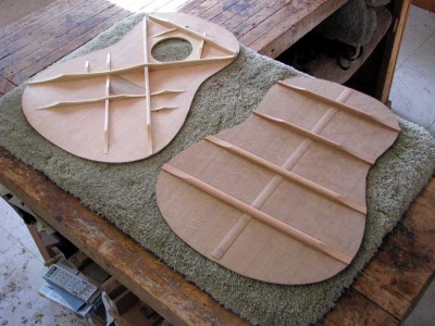

Here's a shot of the scalloped bracing on an Oak/Sitka Dread.
The top bracing could have been a bit lighter.
