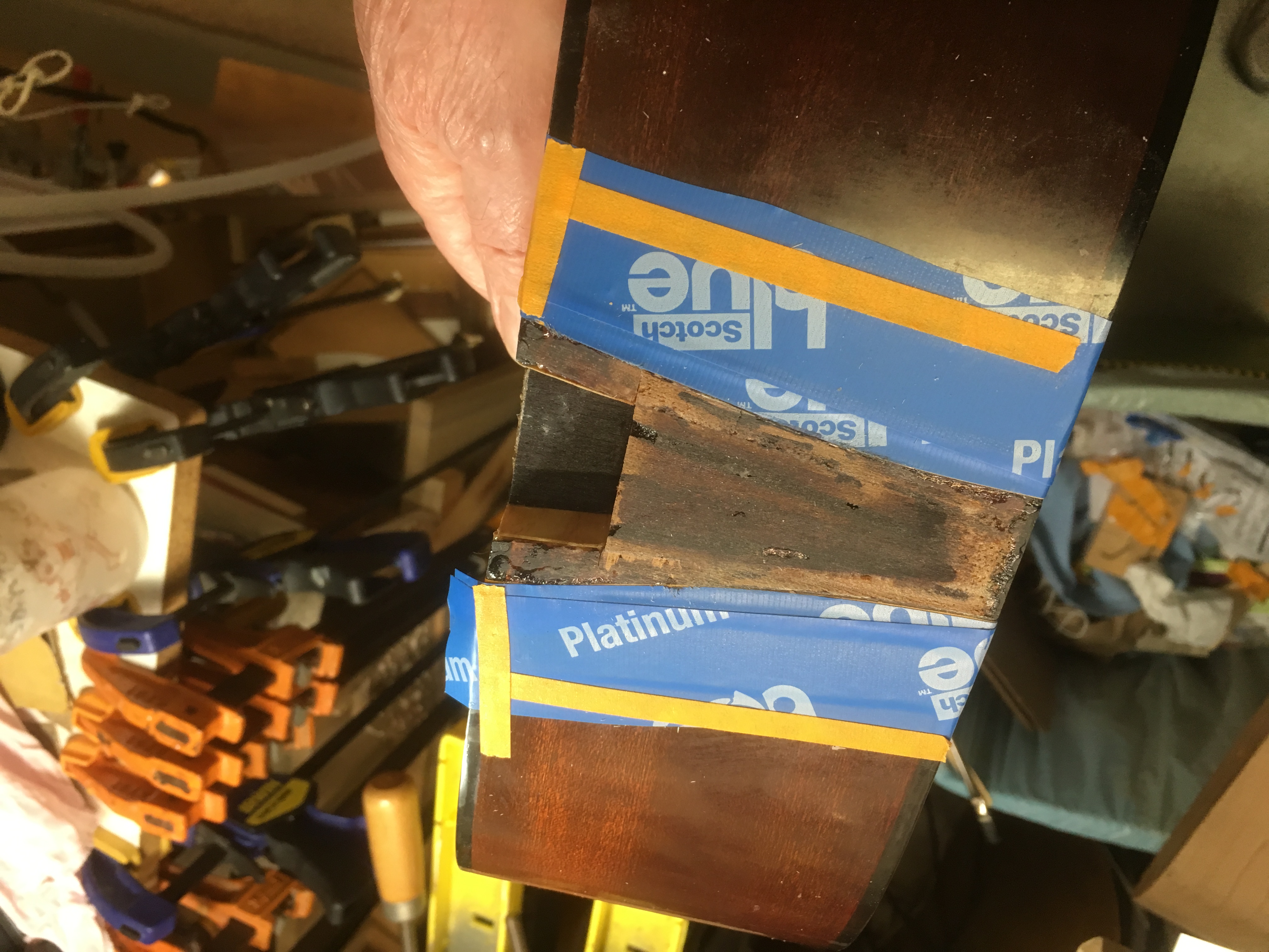

Re: 1970s Fender F-35 acoustic - have a dovetail?
Here is a photo of a Yamaha FG-18- after removal and a bit of cleanup.
