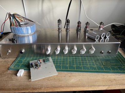

Building the chassis and positioned the hardware:
Cutting forward...

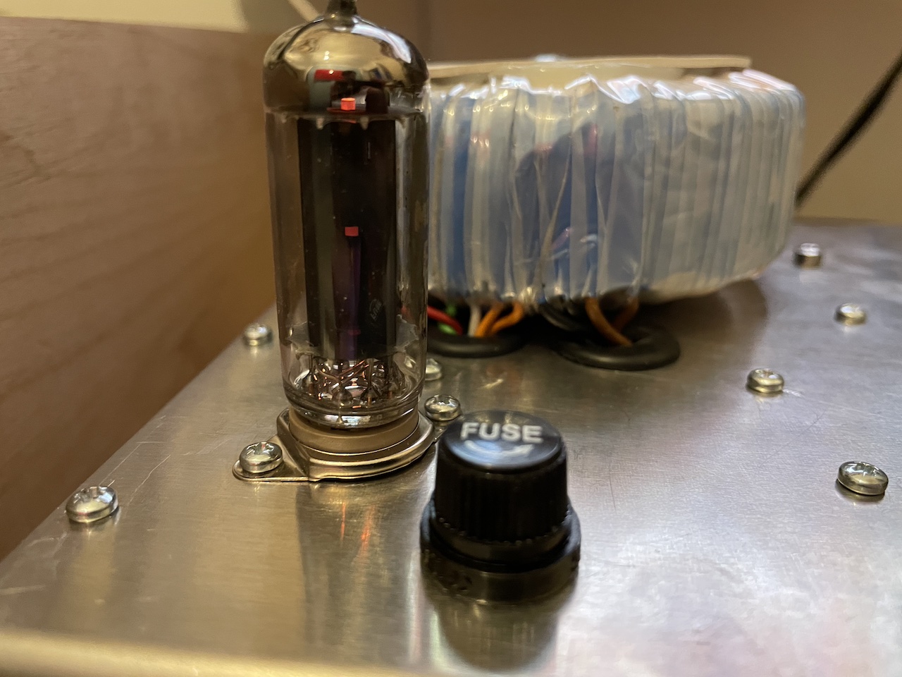

And the rectifier..
A second difference from rob's design is that I'm using a EZ80/EZ81 rectifier tube to provide some rounding and sag - it also means I don't need a standby switch as the tubes B+ comes in slow as the heaters heat up.

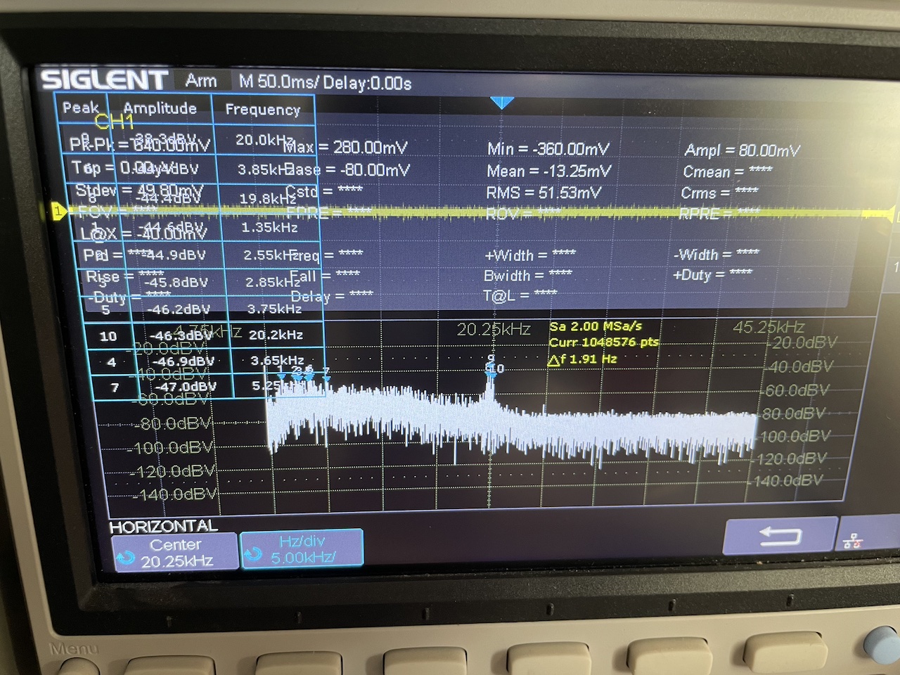

I have since found a few issues and solved them - the main one being two large ground loops on the jacks. I've also replaced some of the internal single core unshielded signal wires with shielded teflon 1000V wire.
This how shows (at full pre-amp volume, full master volume, and full presence) some oscillation or interference at 20kHz which I believe is coming from an interaction between the heater supply that's elevated.
There's still some work to be done - I need to order some additional parts (some were scavenged and reused). The Marshall officinardos will recognise the lack of treble peaking caps etc. I also have some mods that I want to add - specially a 4th pre-amp tube to provide additional distortion (akin to the Mr scary v2 mod), cold clipper switchable cathode resistor values and a post tone stack distortion plus a bypassable effects loop. Addition to this there's going to be some attentuation - initially resistive but later a reactive dummy load to allow speaker less DI work.

So some background noise, power on, then pre and master volume noise floor now I've had a go at reducing the hum. It's probably still uploading but has about 5 mins left..
https://youtu.be/Aw74li3kovc
In short
* open chassis with out full shielding or shielding on the power cabling or EF80s.
* still has the mains 20khz noise - that I'll have to think of someway to low pass that or notch it.
* the mains him is now very very low, below the hiss of the amp reallly - so full volume pre + master + presence and tone stack is now humless but instead has hiss.
* the hiss is the next target.. although we're limited in what we can do (no running dual triodes for each stage to reduce the noise floor.
I also did a 20V shottky mod to test that.. hehe that gave it 1980s metal vibes all over. so that's going on a switch.
In short

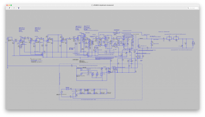

Keen on seeing the schematic for your amp, surprised that the EF80 only has 2.5W max plate dissipation, they are bigger than the smaller double triodes, and ECC82/12AU7 even has a higher max plate dissipation.
What did you use for the output transformer?

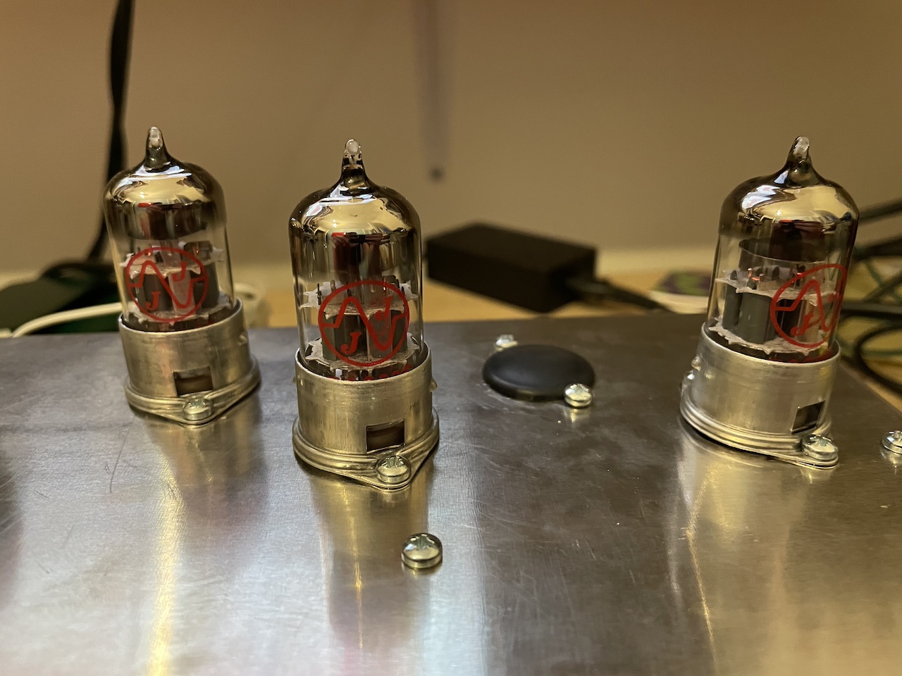

I have some TAD 12bh7-str and JJ ECC99s that also fit the same long B9A socket format.
The transformer is a Hammond 125B. A 5W push-pull that has a few options for use:
The differences between Rob's EF80 JCM and mine, are that this one has:

WOW, that is a schematic!
thanks for sharing.

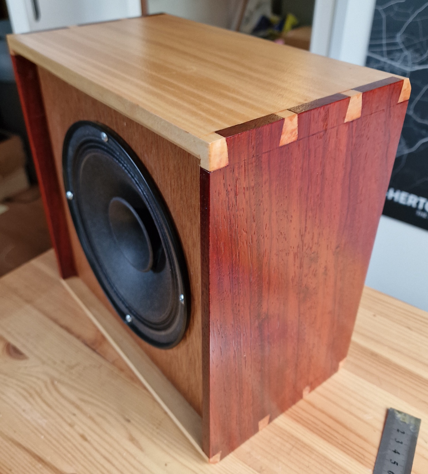

Might be a fun project to try a power stage like that with some really old (50's vintage) speakers I still have. In a dovetailed speaker enclosure
Built this a while ago: Padouk and basswood, no name speaker, and a class d amp at the back. Test purposes.

Nice! (the schematic shows the two additional stages for the V2 mod that I will adjust)
