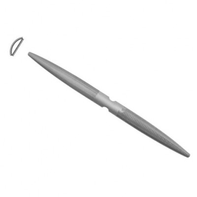

Twenty some years ago I bought one of these from Woodcraft but don't find it listed any longer on their website.
Looking online I see it's call a Grobet Swiss made pattern file. Coarse and medium cut. I'd say the medium is similar cut to 100 grit. Coarse is more aggressive but still smooth cutting. It's one of my essential tools.

Oops, I was thinking of the string ramp above the nut on a slotted headstock. Nevertheless that Swiss made Grobet is one handy tool. I recently bought a Nicholson "4 in hand" too. It's a squared off version of the Grobet.

The 1/2" diameter round rasp looks promising for this application. That is the recommendation from the Cumpiano book.

I'm rasped up. I ordered a 6" hand stitched fine half round modelling rasp, a 6" hand stitched #5 cut half round, and an 8 mm fine cut round rasp. But I'm still interested in a 12 mm #7 sweep incannel gouge so I can be Mr. Edge Tool and smirk at rasps and sanding sticks.
