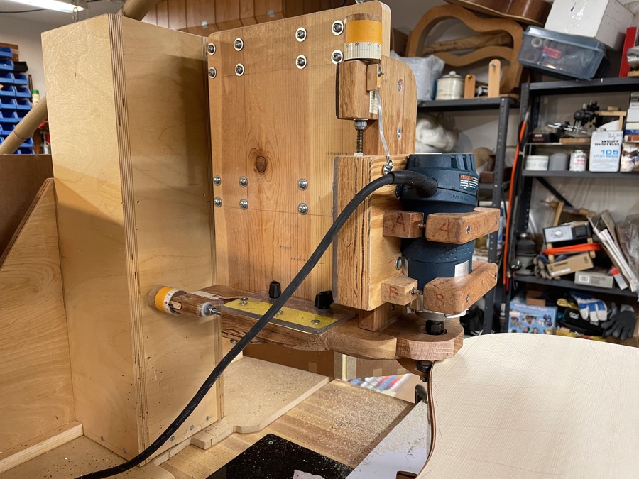

I made some plexiglass cauls with rare earth magnets for this task. One for the inside and one on the outside. That way I can use Titebond or even HHG.

- Posts: 3249
Re: Side reinforcement strips
It may sound weird but I have more joy making and designing jigs. Sort of the engineer side of my brain taking over. Check out my binding jig that I just re-designed. It is the only binding jig that I have seen with linear advancement in both axis with one thousandth inch accuracy. Sorry for going off-topic.
- Glenn Howland

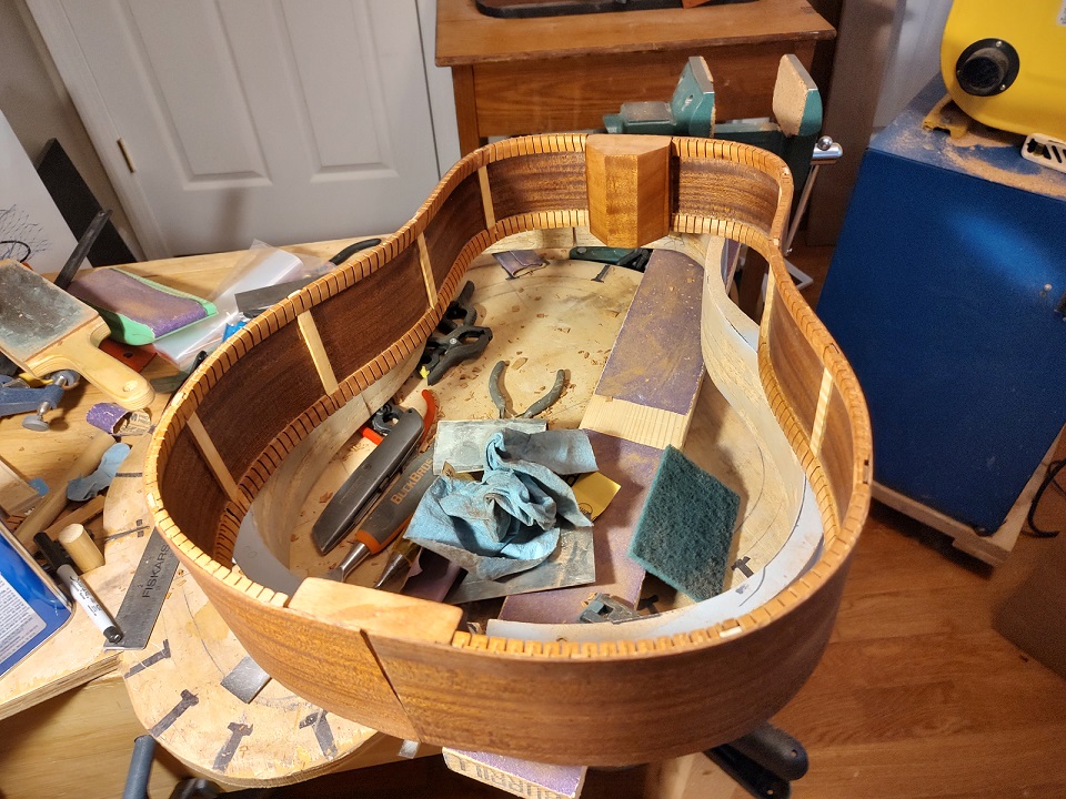

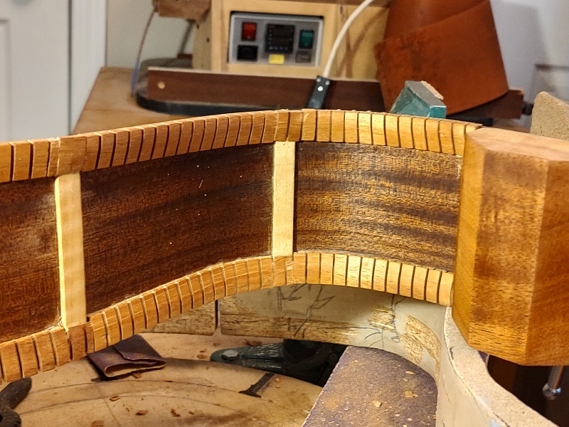

- Posts: 17
- Joined: Tue Oct 20, 2015 9:48 am
- Location: White River Junction, Vermont
I'm making my first guitar and am experimenting with maple side reinforcement strips. They are under the linings and run from rim to rim. The kerfed bits covering them are a bit awkward; I may redo them before committing to the top / back glue up. The neck block in this pic is scheduled to lose a bunch of weight, as I'll be countersinking bolts for the neck with a good sized forstner bit to make a channel.
A third choice for adding side reinforcement is to use wood veneer strips glued cross grain to the sides. Using a razor knife or sharp chisel you could cut small recesses in the linings, then bend the veneer to tuck it into the recesses and avoid the "dreaded stress riser". Thin wood veneer strips are less likely to restrain the sides from moving as much as side splints, so are less likely to cause cracks in the sides if the guitar experiences - extremely - dry conditions.

I'd still run the ends under notched liners to avoid the stress riser.
- Posts: 274
Maple is fine but spruce is lighter and just as effective. I can't really tell from your picture, but just carefully pare the kerfed bits with a chisel to match the width and profile of the rest of your lining.Glenn Howland wrote: ↑Fri Jan 20, 2023 6:34 pm Detail.jpgReady for the next phase.jpgI'm making my first guitar and am experimenting with maple side reinforcement strips. They are under the linings and run from rim to rim. The kerfed bits covering them are a bit awkward; I may redo them before committing to the top / back glue up. The neck block in this pic is scheduled to lose a bunch of weight, as I'll be countersinking bolts for the neck with a good sized forstner bit to make a channel.
