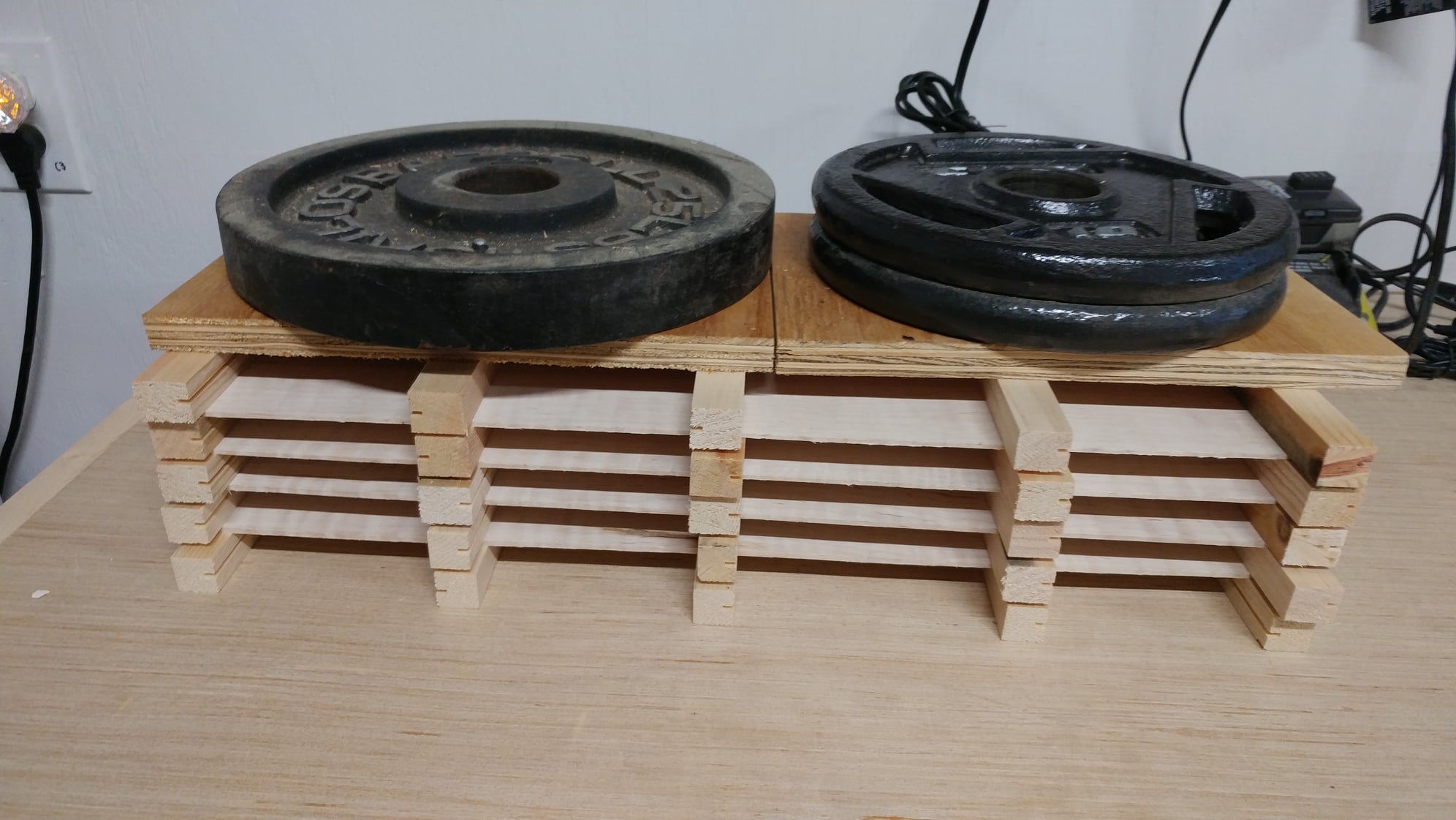

I use Super Soft with all the wood bindings, and on back or side plates if they curl or cup after resawing or thickness sanding. With bindings, I wet them down with Super Soft using a foam brush the day before I am going to bend them, then they "soak" overnight in a "sandwich" stack:
plastic sheeting - brown paper - wood binding - brown paper - plastic sheet ,
When ready to bend I open the stack, let them stay damp from the Super Soft, and then use distilled water as needed to keep the binding moist during bending. I clamp to the form to dry overnight.
I have not had issues with glue or finish.
Here are some curly maple plates in the "sandwich" stack: Plates stickered after overnight Super Soft treatment - works out really well:
